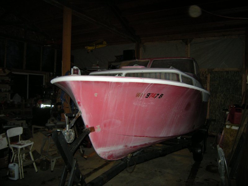

This
is were I got started on the boat.
She
was just backed into the shop. |
I
have seen much worse. She has some nice lines to her, but a few challanges
ahead.
This
boat will be Gorgeous when done.
