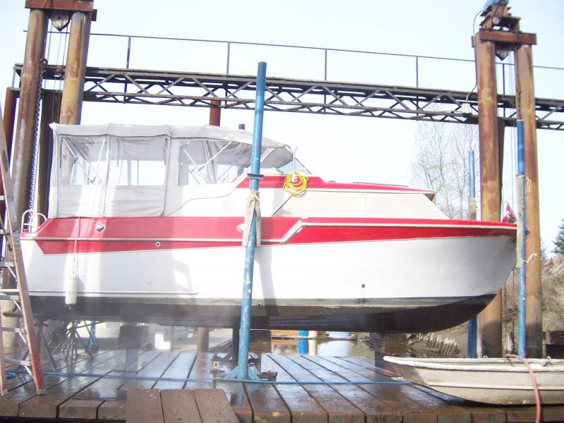

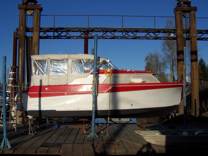

    Pulled the Express 25 out of the water this week for bottom paint, new prop and new exhaust hose. As some of you know I don't trailer the 25, so I have to get as much work done as I can when she is out of the water.
    The bottom paint went well, besides being dirty. Replaced 12 ft of wet exhaust hose at a cost of $120, ouch! And finally got rid of the trolling prop and put on a decent cruising prop.
    Took "Arthur" out yesterday on a beautiful 70 degree day in Portland. With new prop reached a speed of 25 mph@ 4,000 RPM. With old prop the best speed was 19 mph@ 4500RPM, running hot. Gas mileage is so much better, did a 2 hr cruise burning 10 gal fuel (speed between 5-25 mph; avg 15 mph). Previously would have burned about 18 gal.
    It's like a new boat, I am thrilled!

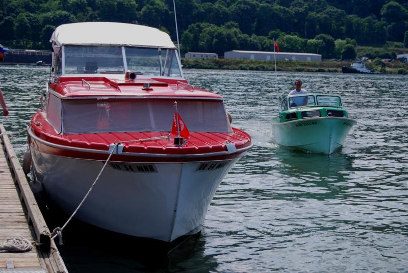

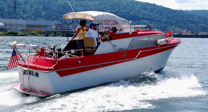

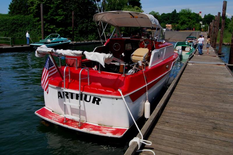

          Hi Robert, Looks like you are keeping "Arthur" in very fine shape. Maybe one of these days some of us can make another event down your way. Pictures from May 08. Best,Chuck

            Hi Chuck. Yes, I am doing my best to keep Arthur in fine shape. Heidi, not so much. You know, I was going to throw out an impromptu run that would coordinate with the Portland Pirate festival in Sept. The event takes place at Cathedral Park (where chuck's pictures in above post are from).
