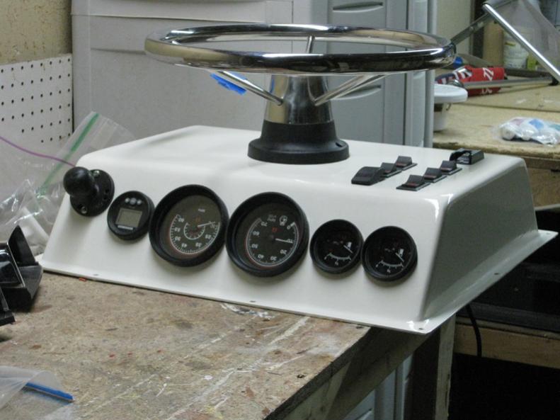

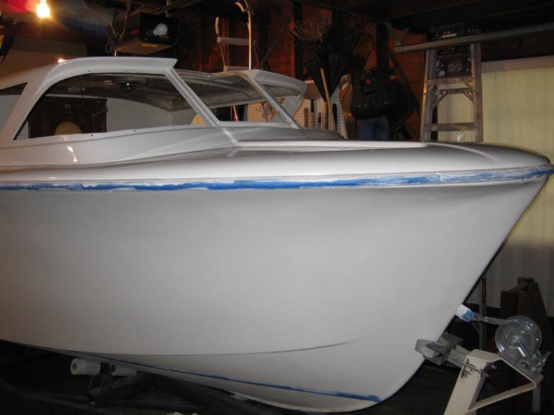

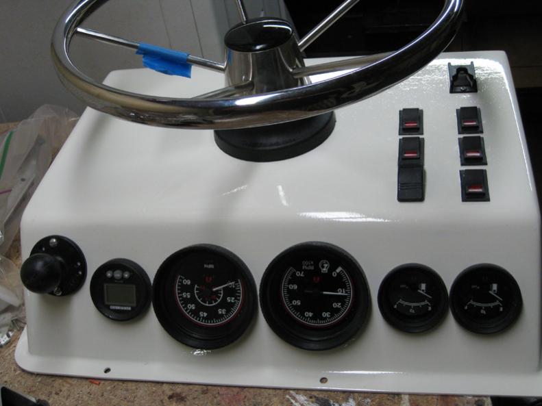

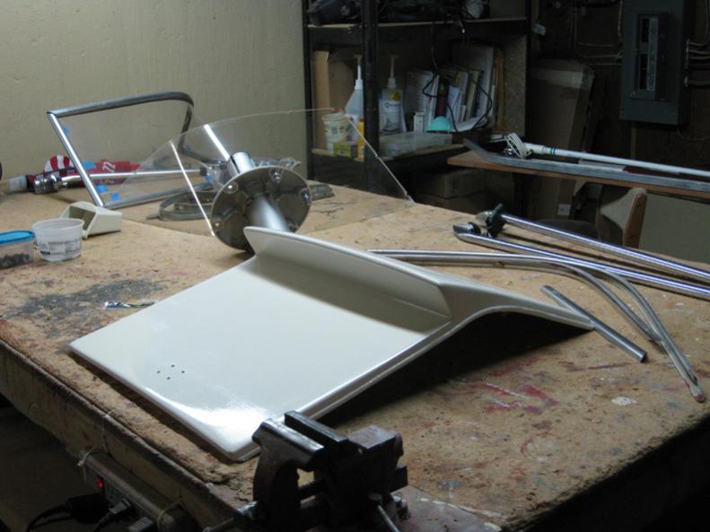

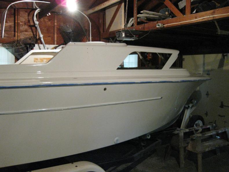

Here are some shots of the BellBoy after the final coat of Perfection was applied. The first coat was allowed to thoroughly dry 24 hrs., then sanded with 320 on the DA sander. The paint sanded as easily as the primer! The second coat required about 60 % of the amount used for the first coat. Its just gorgeous. As with any successful paint job, there is a lot of prep. The two part Interlux 404 primer could not have been easier to apply and sand. I really recommend this as an easy way to give your boat the just-out-of-the-mold gloss finish. It is as hard as nails!
