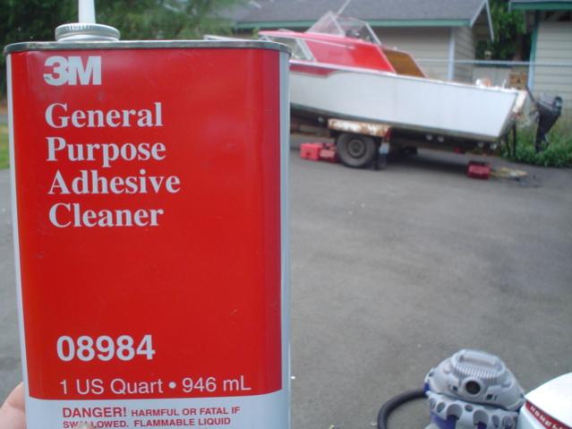

              As to your sticky situation, I've found that a combination of the methods already suggested works well for me. I would recommend the following:
              1) Run a razor blade along the edge of the tape to separate the paint on the tape from the paint you'd like to remain on the boat.
              2) Use a heat gun to gently warm the paint / tape and scrape it off with a plastic scraper that won't harm the underlying surface.
              3) Once you have the majority of the tape off, leaving a nasty sticky mess, soak a cloth rag with the 3M solvent pictured below. Hold the rag in place over the adhesive so that it has time to loosen it.
              4) Using a separate rag moistened with the solvent, rub and wipe until the surface is clean.
              Unfortunately, my experience removing tape that has been sealed with a good coat of paint is that the paint will prevent the solvent from soaking through the tape and reaching the adhesive, so you must remove the tape by scraping to expose the adhesive. Otherwise, you're just doing a great job of cleaning the paint. It would take forever for the solvent to loosen the adhesive from the edges, which is the only path in with tough paint over the tape.
              I like the 3M solvent pictured, it is formulated to remove 3M adhesives, which are the most widely used, without damaging paint. It's available from auto body supply stores.

                        Rick and Tim's suggestions worked for me. Heat gun warmed up not only the adhesive on the tape, but the epoxy primer on the tape as well. That 404-414 epoxy primer was hard as a rock without heat.
                        Some of it went slowly, other areas I was able to pull off a 12 foot piece in one go. I used lacquer thinner to remove the adhesive. Takes a while to soften the adhesive, but after a while it can be rubbed off.
                        Thanks for all the suggestions. Can now see the beautiful monel rub rail on the Saratogan...first time in seven years!
