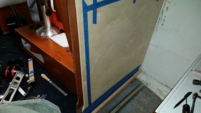

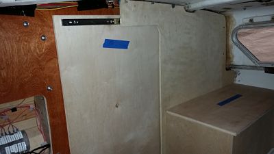

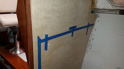

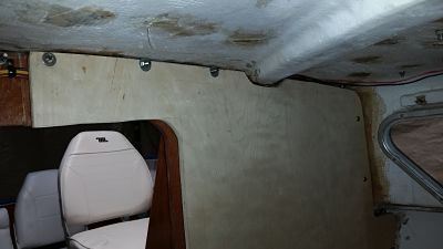

      • As promised, pics of phase 1. In these shots, the false bulkhead is attached (mostly) to the port side bulkhead. Its also marked up for the installation of the cabinet supports that will go on the exterior. These will be fastened on the inside of the bulkhead. As such, they need to go on before final installation.
        Next step is to measure for the cabinet dimensions and then remove the bulkhead for fitment of the drawer slides and door. When everything is attached it will go back in the boat for test fitting and operation.
        As with most of the construction on this boat, all of the furniture has been designed for removal if needed. This setup will be no different. There will be butt trim on the stbd side bulkhead for the door to slide into when closed. Removal of that trim will allow the door to be removed in the future to allow for clean up of the pocket area.

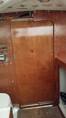

        • Made some progress in the last few days.

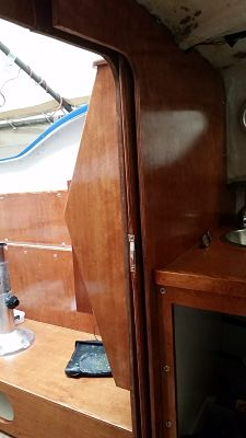

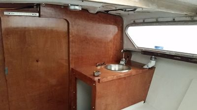

          The pocket door is hung and the bulkhead mounted. Sliding action is smooth and easy. The door still needs to have the pull ring mounted and a hole drilled out for when it is closed into the door jam. When I pull it out to stain and varnish I'll tackle those items along with routing the end.

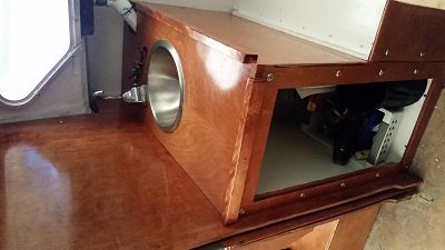

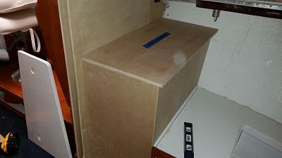

          The sink cabinet is a work in progress. The attached shots show all the pieces in place. The counter top needs to be trimmed down, the face needs to be mounted and then the door opening cut out. Additionally, I need to cut out the opening for the sink, plum the faucet, water tank, and drain, and figure out a water tank feed tube (seen sticking down). The final finishing touch will be hardwood trim on the edges of the plywood and a veneer on a small piece of end grain on the cabinet face.

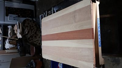

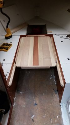

            The newest piece of work is the cabin table. I'm about half done. Table is built, but needs re-enforcement on the bottom as it will be the insert for the bunk as well. i used bloodwood, birch, and rosewood in a butcher block style of lamination. Looks great. Pics to come.

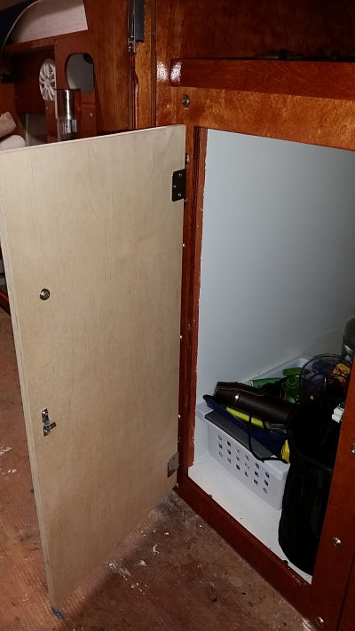

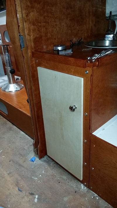

            • Pics as promised. The shot of the cabinet was late last year. I have the wood for the cabinet door set aside. I was ready to go boating last year when I finished. Nothing fancy planned for that. Just a couple of hinges and a pull handle. The door is on my short list for this winter, along with finishing the table and adding cubbies in the cabin to replace the original fiberglass units.
              We found a lot of useful space in the cabinet during our few outings last year. We can store cups, bowls, paper towels, rum, and even a small garbage basket. Makes it very convenient for lunches and general usability.

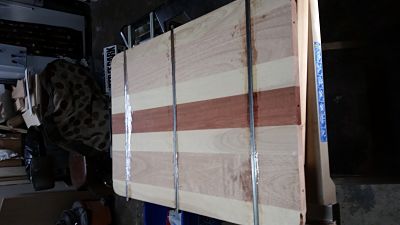

              The shots of the table are top and bottom. I used blood wood in the center, birch, then rosewood, followed by birch and rosewood, with rosewood rails (not pictured). The joinery was biscuits with glue, and lots of clamps. The look is fantastic, but the joints are not strong enough to support the weight of a person. The table will be a high/low type arrangement with it acting as the center berth fill for overnighters. Hence the steel reinforcement on the underside. It still flexes more than I would like so I'm likely going to lay up 2 layers of 1708 to add strength and aid in capturing the box steel. I'm fairly confident that this will do the trick. If not, I'll add layer of 1/4 plywood to the bottom.

                    Last night I put down a single layer of 1708 on the underside of the table. It has been a while since I worked with FRP. Man, I love that stuff! 2nd layer goes on tonight. I did some more pressure testing before putting the glass on and I think it is going to be sufficient with the 2 layers.
                    Prior to laying down the glass, I did some router tweaking on the surface. I didn't like how the rails lined up with the corner routes so I cleaned it up a bit. Once the layup is done, it will be on to sanding. and fitment of the top rails. If all goes well, I should be on to finishing this weekend.

                      The table is done from a construction standpoint. A 2nd layer of 1708 was installed earlier in the week and it is nice and stiff. I painted the bottom after a good sanding to reduce the fiberglass itchies. We'll see how well that works this summer.
                      I've installed the side rails for fitment purposes. They will come off some time this week for final sanding prior to glue up. Once that is set, I'll move on to varnishing the wood as a whole unit.
                      The mounting rails have been built and fit into the cabin and I did a test fit/sit of the table with everything in place. Very sturdy. I don't think we'll have any issues with the wood letting go during overnighters. One more piece that will go in the gap is a 6" filler. It will double as a cutting/food board during regular use, and drop in to extend the berth space when needed.

                      I've also snapped a few shots of the interior door and sink. Better than previous shots. Door open/closed, a close up detail of the false bulkhead and such. Enjoy!

                                Today I mounted the cabinet door (finally!) and test fit the hardware. After fitment, off it went, fresh 240 surface sanding and the outer edges got 1/4 rounded. Stain has been applied and it will sit with the rest of the parts. Shots are inner and outer prior to routing.
