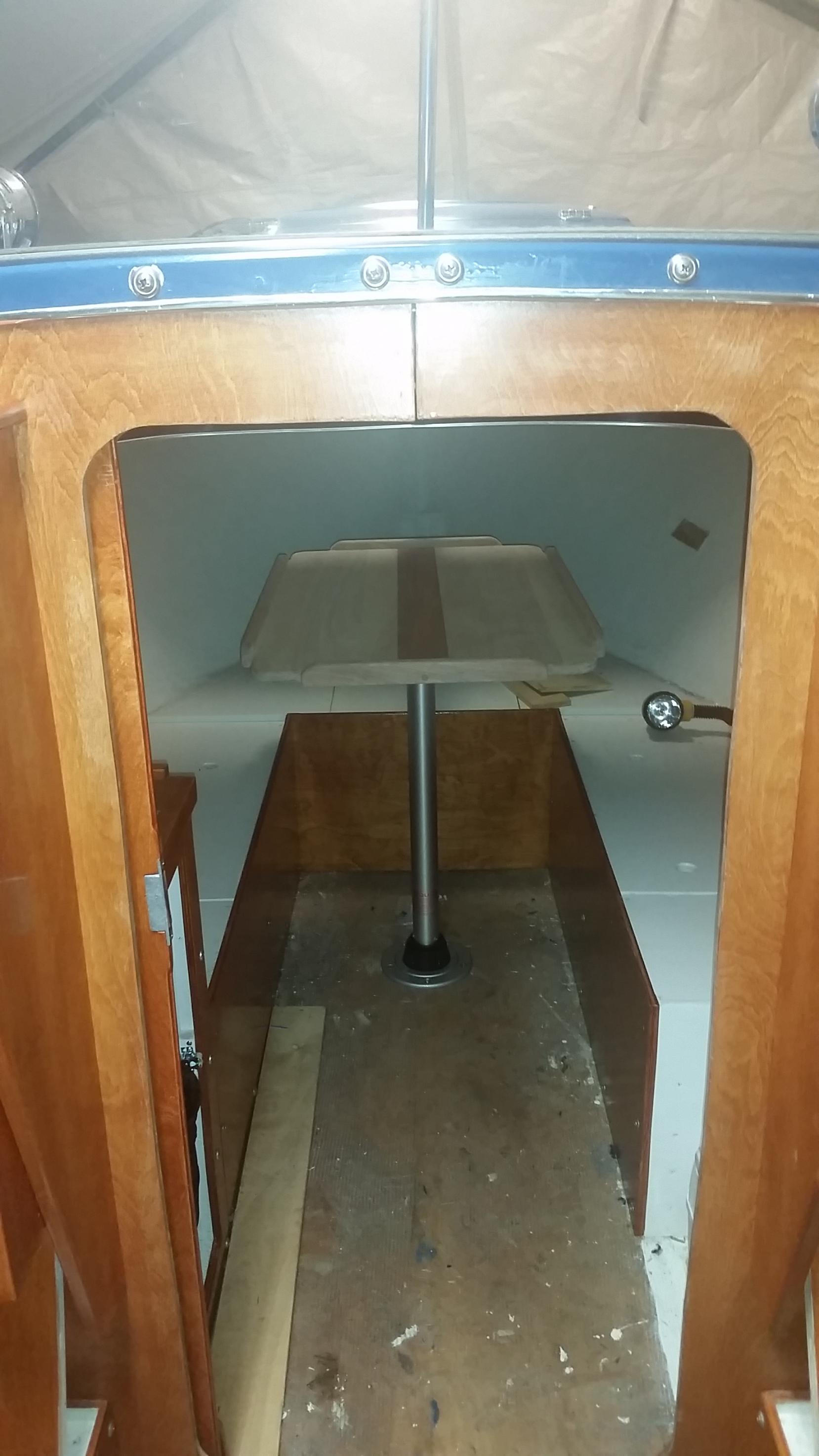

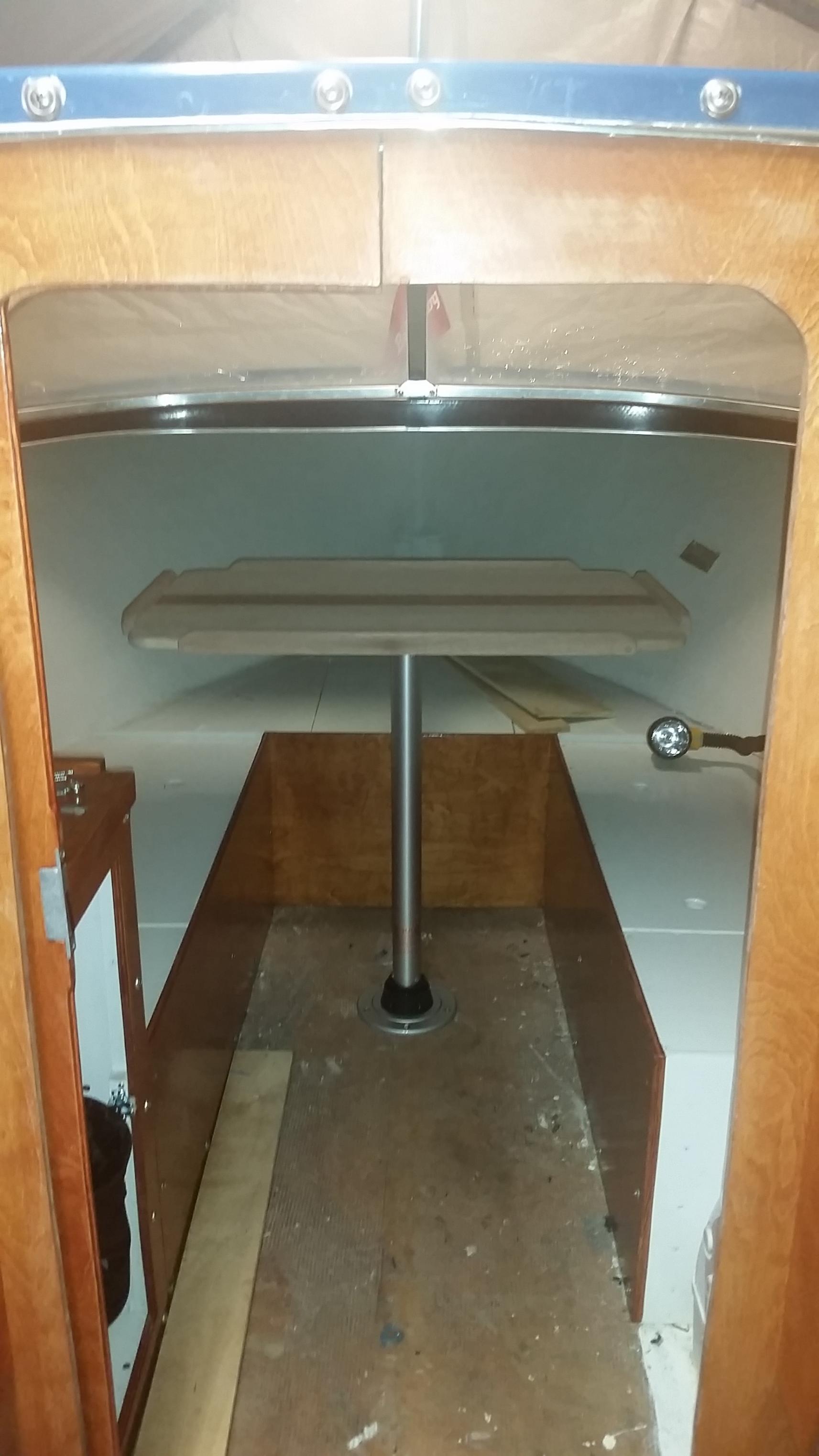

            • Got the table leg set up tonight. The base is screwed along the centerline in the cabin. During deck layup years ago, I installed additional 2x4 bracing along both sides of the center stringer to support mounting the base plate. As such, I used big number 6 screws to mount it into the deck. It's nice and sturdy. The portion that mounts to the table uses 6 number 10 screws. Both ends are pretty stout.
              The top is a snap fit to the leg. It isn't exactly difficult to mount, but removing it proved to be a bit of a challenge due to the angle and force needed to pop the locking tab out. I ended up having to use knees to remove it on the first try. Hopefully it will loosen up a bit for ease of removal down the road. If it continues to be an issue, shortening the table leg may help. The bonus is that because it is a press fit, the table can be rotated easily.
              The other thing that may necessitate shortening of the leg is the wobble effect. The leg is around 3 inches wide, but the overall assembly is easy to wobble probably due to the bayonet style mounting. I have a feeling that when under way, vibration will cause it to move around a bit.
              We'll see...
              Pics in both long and wide alignment.

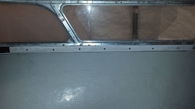

              • This weekend was one of those do a lot of work but not have much to show for it times.
                Last week I removed the one remaining piece of wood from under the stbd window that acts as a backer for mounting the cubbies. It was pretty much rotten, but I managed to use it as a template for replacement. It follows the curvature of the deck on the outside, allowing for a straight line on the inside. Originally, it was held in place by special bolts riding in a track under the window, along with through bolts to a flange on the deck. During removal of both sides, the special bolts had to be cut due to rot. I figured I could do without them on reconstruction and just mount the new wood to the flange. However, when I did this, there was a considerable gap between the window frame and the wood and it looked bad. So…
                Removal of the seized leftovers was in order. I used a punch and hammer to do the port side, but the stbd side parts were firmly stuck. Out came the cut off wheel and both sides were cleaned up. I would recommend the cut off wheel method for any future use to people here. It was much faster and easier.
                Last time I dealt with the special fasteners was when I mounted the windshield. I used stainless steel bolts and cut them down to fit the channel. I know, disparate metals, but try finding aluminum fasteners… I did the same this time around by using what was left of a punched out fastener as a guide. I ended up with 1/4 inch bolts at 1.5 inches. After sizing them down they fit like a charm. Only problem was, the channel was wider than the head and they spun easily! Thinking cap on, I made wooden blocks to fit in the channel to allow the head to be tightened. They mostly worked and I was able to capture the heads enough to tighten them down with a non-locking nut. I used a clamp on the sill and wood to put it in position, tightened things up with a socket until it felt like things were as snug as they were going to get. After releasing the clamps, everything stayed in place. Between the tension on the nut and then tension of the wood, everything is pretty immobile. Just to be sure, I chased the nuts with locking nuts to insure nothing moves.
                With both backers in place, I'll be able to tackle the cubbies this week.
                Image is the stbd side backer. What a thrill!

                    The table looks good too. I somehow missed that post. Did you end up shortening the leg or are you still waiting to see how much it wobbles?
                    I'm guessing that's why I see a lot of tables with double legs or double points of contact with the hull. I hadn't put much thought to it until your post but it makes sense.
                    • Table seems to be somewhat stable. It moves a bit, but it doesn't vibrate constantly, which was my concern. We'll see how it fares this season and I'll adjust as needed in the Fall.

                              Table update. The leg system sucks. It is almost impossible to get the leg out of the table to change position. Maybe in an RV it would be OK, but in the small cabin space it is just too difficult to remove. On the advice of a fellow down on the docks, I'm going to measure and see if the seat posts that I have will do the trick. They are height adjustable. I may be able to just do a high/low to handle the issue. I'll address this in the off season as well.
