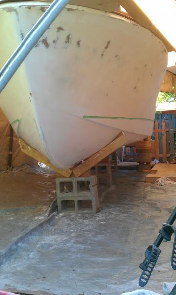

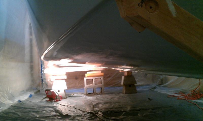

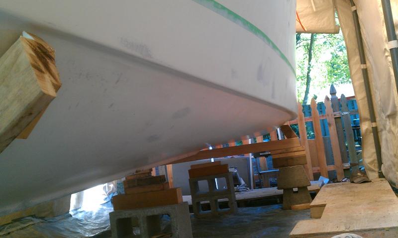

        As promised, and late as usual. Here are some shots of the underside with the first coat of primer on.
        I never did go with Sound Specialty Coatings. They were impossible to deal with. I emailed trying to get product info over several weeks and got vague responses or none at all. When I called and finally got ahold of someone (after several tries), it was more vague responses and disinterest. Eventually it came out that they don't do retail and the gal was going to find me a reseller. It never happened. So, stay away. They may have a good product (or may not), but it is apparent that they really aren't interested in selling to the little guy.
        I ended up going with Supermarine (Top Secret Coatings). After reading the product web site I was a bit cautious, as their advertising is pretty over the top. I called up their support line and was immediately connected with a support person who was able to answer all my questions. So I ordered up their two part epoxy primer and Revolution paint along with the appropriate solvents. I was even able to get a custom color at no extra charge.
        Epoxy Primer
        I went with their Formula 150 Epoxy Primer. it is a 2 part primer with a 24 hour full cure time. I played with it a bit on the underside to get a feel for the lay out. It is a pain to work with! using a 3/16 nap mohair roller it left some orange peel, even with thinning. Using a china bristle brush I was able to get a smoother lay out, but still some visible brush marks. It is pretty much unsandable. When you do sand, even after full cure, it loads up the paper pretty quickly. There is no smoothing it out before paint. As a result, I have used the roller below the chines, and a brush above the chines to about 6 inches off of the chine at the stern, marked off with tape. I figure this will give me an irregular surface for "water line" looks. Above that line, I am going to use the Rustoleum marine primer. I've used it on the hatch as a trial and it dries level and sands well. Should be a treat to use.
        SM1000 Revolution
        Their topsides paint is supposed to be submersible for up to 40 years simulated! riiight. Well, if I can get a few weeks out of it without issue then I'll be happy.
        I have a sample that has been soaking for over a week now in Liberty Bay (hanging on a line in the boat house). I've checked it daily and it continues to show its original shine and no sign of bubbles or lifting of any kind. I have to say, I'm impressed! This was just a dip of a lure in the can with no thinning and no primer (just a quick scuff of the metal). Took a while to cure as it was a bit thick and this is oxygen catalyzed but it is nice and hard now and I can't dent it with my finger nail.
        For topsides, I went with Epifanes monourethane. I have yet to try it out, but will post results when I do.

          Paint is on the hull!
          It has been a month since my last post and I've been busy. After priming the hull on the underside and applying two coats of the Supermarine, I was pleased with the paints performance, but not so much with the flatness of the primer. Luckily, the paint was thick enough to fill most of the irregularities so I used it as a sandable base. I knocked down the high spots and ended up with a fairly smooth surface.
          I also ended up hand sanding the epoxy primer that I had laid out above the chines. It smoothed out fairly well. After long boarding the upper section it was time to get to work this week.
          I now have 4 coats of paint on the hull! woohoo!
          I've already discussed the Supermarine epoxy primer but I wanted to touch on the Rustoleum marine primer. It is great! Goes on fairly well with the roll and tip method. Block sands easily and is nice and smooth. It does create a bit of fine dust though, so a respirator is required for sure.
          I'm going to have to do some surface sanding on the paint to get the shine I want out of it, but it sands pretty easily. As it is, with no sanding, it has a good lustre that shows my shop light when I look at it. I can see detail in the reflection, which is pretty good! The only thing making me want to sand it is to get it ultra smooth and hide any brush marks. Should be about a weeks worth of sanding to get it to that 2000 grit stage. Then I'll polish it up and be done.
          The paint has to sit for a week to fully harden, so its break time for now. I'm going to move on to trial and error with the Epifanes on my hatch. Once I have that sorted, its on to the deck!
          I'll snap some pictures and try to get them up soon.

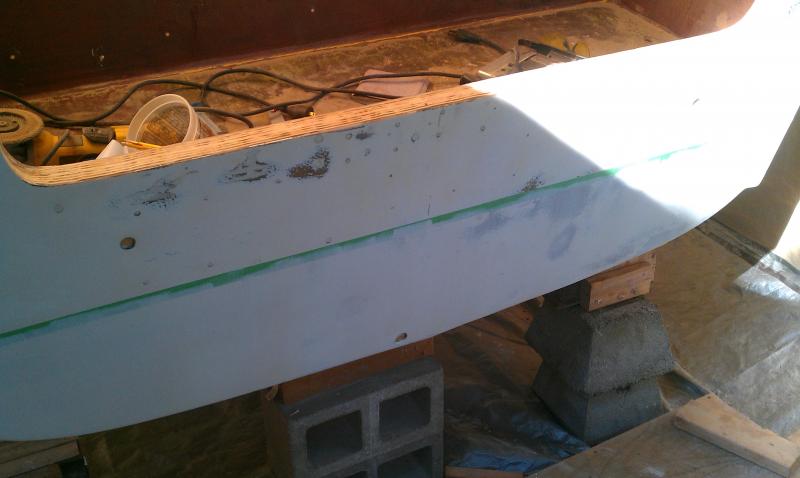

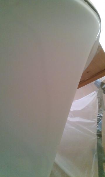

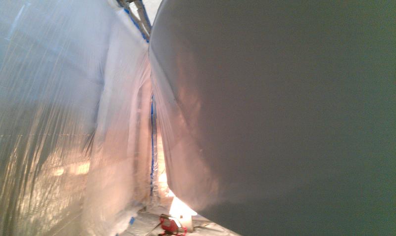

            OK, as promised, some shots of the blue. It is really hard to see the color in the light that I have in my work shed. It turned out just like I planned! With indirect light, you can see the blue nicely. With a bright light on it, it almost looks white.
            I played around yesterday and cut the transom down to 2000 grit. the shine is quite nice! I'm really impressed so far with the workability and results of the SM1000 paint.
            Transom shot shows the tarp I have laid out under the boat reflecting.
            The bow shot has a bit of reflecting going on, but I haven't sanded any of it yet.
            The underside shot is similar. Not much shine in it compared to the sanded transom, but you get the idea.
            On the Stbd shot, what looks like a huge bump in the hull is actually a reflection of the pole supporting the shelter. Also, unsanded.

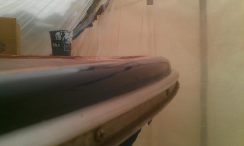

                  Just a quick update.

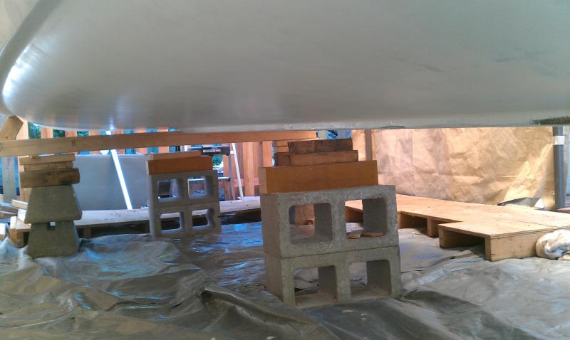

                  The bottom is painted! Blocks have been moved and it is uniform front to back. yay! It will sit in it's current position for another week or so until I move it back to the original, more secure, placement. After that, I'm going to tape it off and hang a visquine drape around the whole thing to keep primer and paint off of it while I work on the deck.
                  I tried my hand at the Epifanes over the weekend. I just painted the hatch as a trial piece since the rest of the deck is no where near ready for paint. It was reasonably easy to apply and tip. I'd say the Supermarine was probably easier to work with but not by much.
                  My brush wasn't clean enough (didn't start with a new one) so I got a lot of contaminants on the surface as well as a few brush strokes. Despite that, the shine was amazing. It hardened up no trouble in less than the prescribed 24 hours with about 10% thinning.
                  All and all, I have to say, I'm impressed. The color is deep, has a rediculous amount of luster and reflects like a mirror. I can't wait to apply a second coat. I have a new brush, new container, and paint tray. Just need a new roller. If it sets up without any issues, this will be a no sand/polish paint. It is THAT good. I've already sanded it with 400 (wet) and it is smooth enough that if it works out, it will be done on the 2nd coat.
                  I'll snap a shot of it when it has the new coat on it so you can see the results. Should be this week.

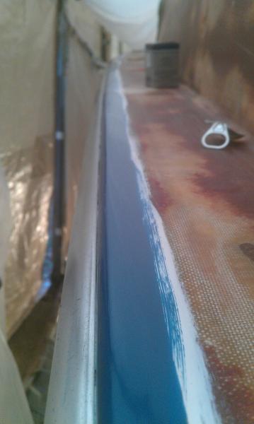

                    With that in hand, I've prepped and panted the edges of the deck where the rail will attach. I have two coats on and will apply a third tonight. I plan on attaching the rail this weekend after the paint has had some time to harden.
                    Once the rail is on, I'll be able to block the hull in it's correct, final shape.

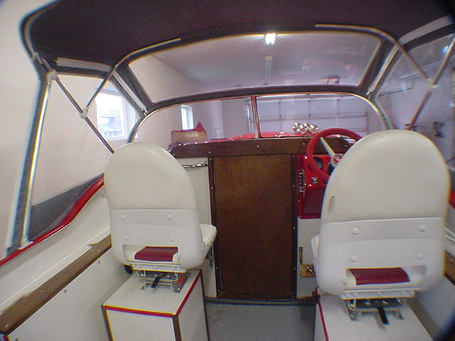

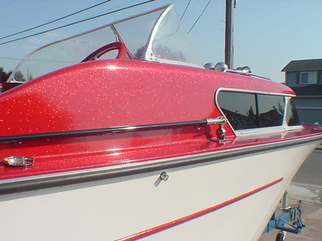

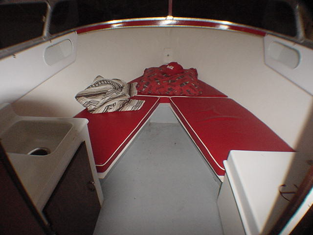

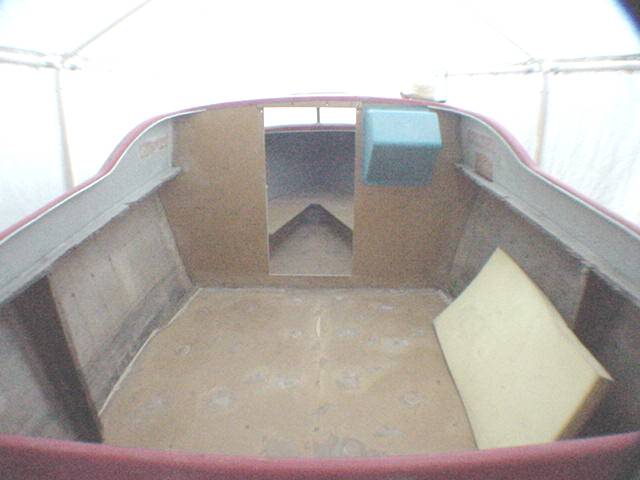

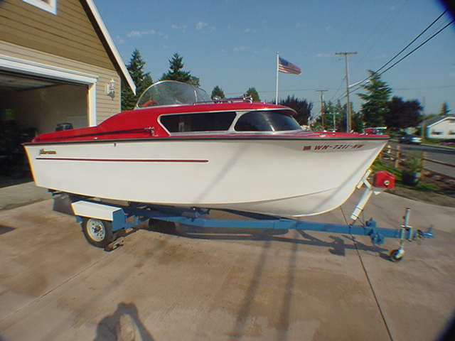

                      ]I remember my good friend Jeff Ault found our 404 and said we could have it going that first summer. Well.... 5 summers later we did. Once you are done though what a treat! It will be well worth it.:Skipper1:
                      [ATTACH]13957.vB[/ATTACH]
                      [ATTACH]13958.vB[/ATTACH]
                      [ATTACH]13959.vB[/ATTACH]
                      [ATTACH]13960.vB[/ATTACH]
                      [ATTACH]13961.vB[/ATTACH]
                      [ATTACH]13962.vB[/ATTACH]
                      [ATTACH]13963.vB[/ATTACH]
                      [ATTACH]13964.vB[/ATTACH]
                      John & Diane Kelly

                            I'll add to it by saying that the darker color I have used is about the same in opacity as the light blue color. I'm on my third coat for the edges of the hull and the coverage is looking great.
                            Thin as appropriate up to 25%. I've started at 20% but will probably drop it down as I go through the paint. What I don't use in a single pour gets placed back in the pail and is thinned already.

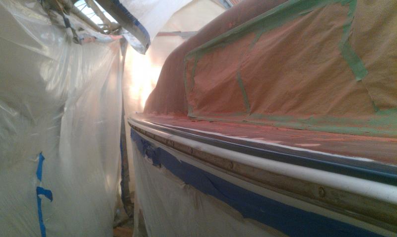

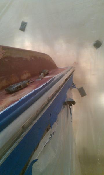

                              As promised, here are some pics of the rail all snugged up. This is a big step on this project! Now that the rail is on, the structural work is totally complete. Everything else is running gear and creature comforts from here on out. Woohoo!
                              I'm going to let the rail sit for a week so the 5200 can fully cure. Then it will be back to sanding down the major fills that I did. With those done, I'll start laying on the primer and begin the messy business of blocking and such. I am on target for an early spring paint application for the deck. At that time, it will be on to the trailer! If I can get that done this spring/early summer, I'll put it back under the boat and might even take it to the launch and float it...
