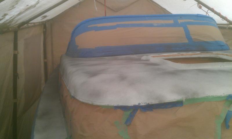

        Update.
        First coat of primer is on the deck! Over the last couple of weeks I was able to get the majority of holes filled and faired. It is decent enough for now. After getting the first coat on, I can already see areas that need filling, which is a good thing! Once the 4th coat of primer goes on I'll tackle any fills and then start on final blocking. I have 5 quarts of Rustoleum primer on order so I'm in a holding pattern for now. Once it gets in, I should be able to get the next 2 coats on in a single day. It takes about 4 hours for the stuff to dry, so if I start early in the day I can get two down.
        I'm holding off on any pictures until I get the second coat on. The first coat is a bit see through and doesn't look all that great!

                  3rd coat on today. 4th tomorrow. I took some pics but can't post right now because I am at work with no USB cable....

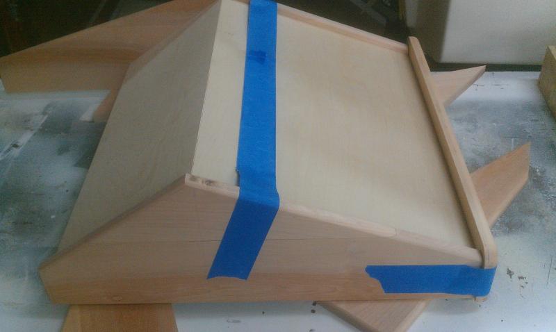

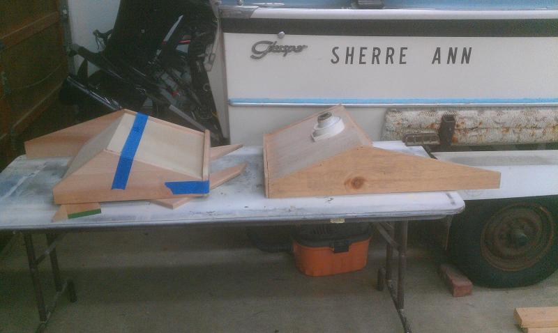

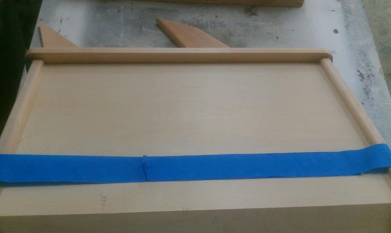

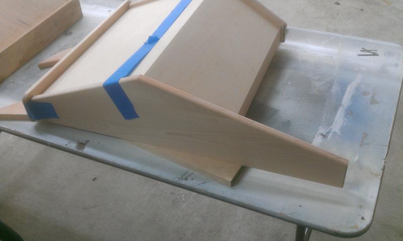

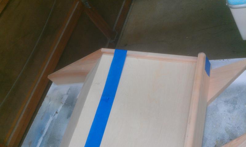

                    Here are some shots of the helm in progress. The original mock up still has the steering gear in it, but it will get moved over once the gluing and screwing is complete and the helm is actually mounted to the bulkhead. The wood is birch. Ply for the big facing pieces, and hardwood for the sides and top. The sides are two pieces laminated together to get the depth needed. They are held together with biscuits and some glue. Pretty sturdy!
                    The insides will get cheap fir to allow for mounting to the bulkhead without screws showing on the outside. Interior screws will be nice stainless jobs with finish washers.
                    To tie the two ply pieces together so that they don't wear and chip, I plan on using a piece of aluminum bent to the correct angle and screwed in on the bottom. It should look nice with the 60s era MerCruiser dash plate that I am going to use.
                    And the Sherre Ann Glasspar in the background is my friend Ron's SeaFair Sedan ('63). He has the sweet planer and a good table saw, as well as the woodworking know how to get all those complex angles to work correctly. Thanks Ron!

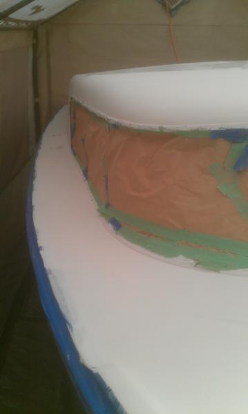

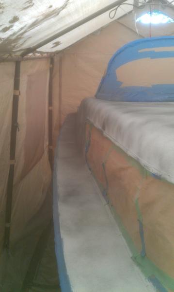

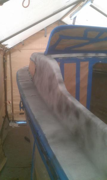

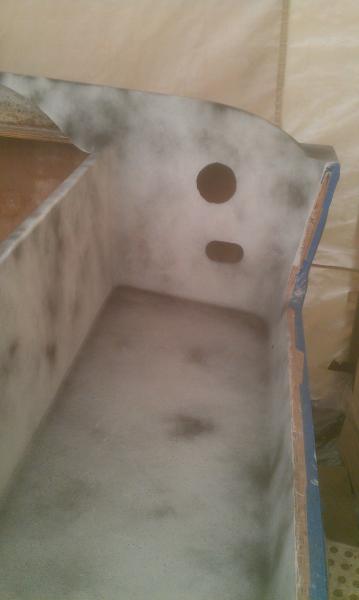

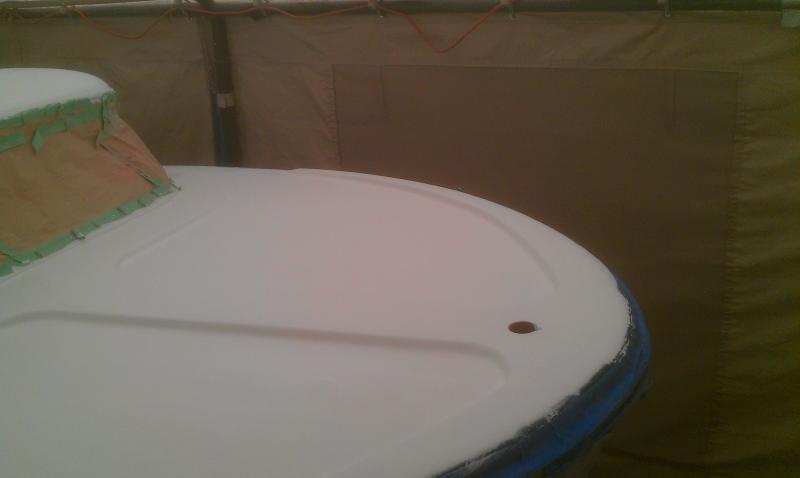

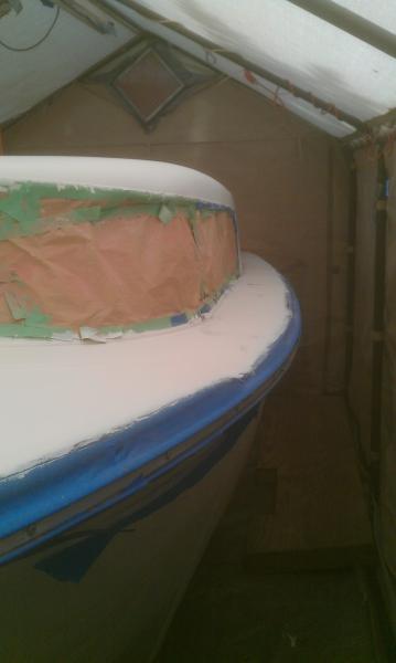

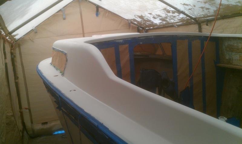

                      Here we have some shots of the upper deck with primer on it. Exciting, I know
                      This is after 3 coats. First two still had some red dust from the original gelcoat as well as the filler. Made the whole thing pinkish! This latest coat is the first that really covered all the see through bits from the first 2. I plan on doing one more coat tonight then it is on to last bits of fill.
                      Due to being sick and the messed up order, I may not achieve my May target of getting paint on. It will be close though! No sense rushing these things. If I make it fine, if not, there are still 2 months until the salmon open up...

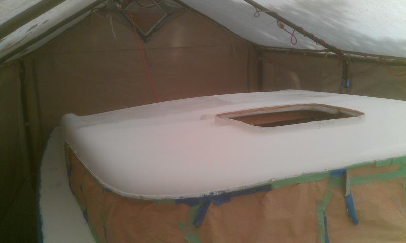

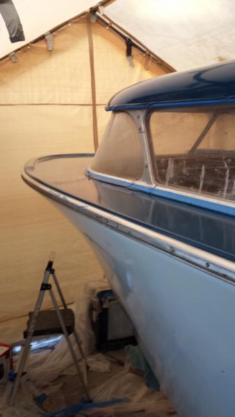

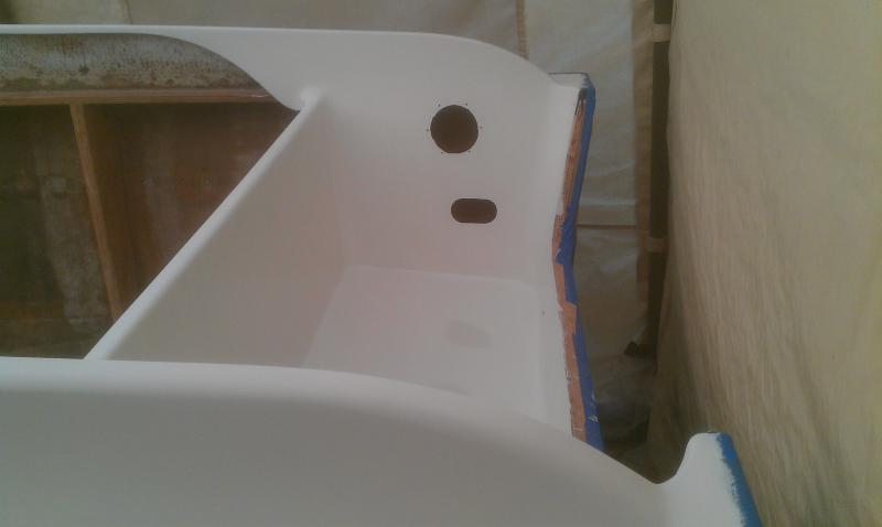

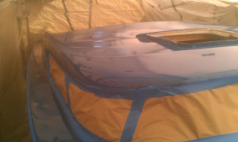

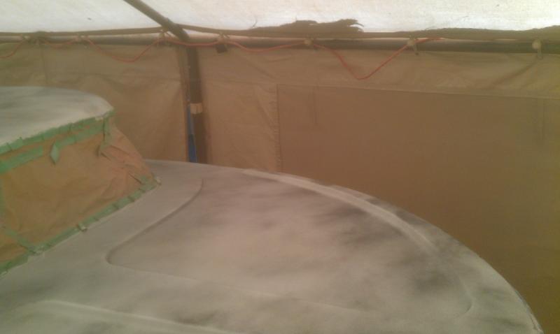

                        More work on the 404 over the long weekend.
                        The roof, as expected, was/is highly problematic. I didn’t get to work as much on Saturday as I would have liked, but after much consideration, the wife and I decided on windshield placement. It fits nicely, but looking at the pictures of the original, it does fall short. It just isn’t big enough! The factory windshield comes further back and goes further forward than what I have. It looks nice, but it just isn’t correct. Maybe some day I'll find a donor boat with the correct one, but until then it will do the job nicely.
                        After bolting the windshield to the roof, it did as I expected: the deck pulled up in the corners as the bolts were tightened. This helped straighten some of the roofline, but not all of it. The good news is that with the flush fit, I will only need to weather strip the underside to keep the water out. Much easier to source than wide trim like the old windshields use.
                        Tackling the roof line from the windshield back was a bear. It is really deformed. Lots of dips and rises. It is so bad, that at one point when I was taking a break in the cabin, I looked at it and you can actually see the deformation from underneath. Not sure why I never noticed it before. Lots of filling and sanding Sunday and Monday. I have it down to one last small section to sand down and I think I’m going to call it. It isn’t perfect, but it will have to do. I feel like I’d be chasing it for months trying to get it spot on. It will get a couple of coats of primer and one last guide coat to even it up and that will be that.
                        Forward of the windshield is good though. There are two spots right in front of it that dip a bit. I’m going to put two more bolts in there to pull it up and tight and call it good. I'll have to make them from hex bolts, but it isn't too tough with a vise and an angle grinder... There are two dips on both sides of the hatch brace that I am going to leave alone. They are symmetrical and I don’t want to try and get them to match…
                        Outside of that portion of the hatch, the rest of the roofline is perfect (or close enough!). No fills needed. Sanding on the bow and the gn’ls is also as expected, relatively straight with a few fills needed. I have more repairs to do by the corner of the sides of the cabin windows where my paint stripper ruined the gelcoat. There is a bit of a rise on the very tip of the bow by the nav light, but I’m not going to tackle that. I can have either a slight rise obscured by the light, or a slight slant that doesn’t belong, also obscured by the light. The stern also has the same effect at both ends at the transom where the deck rises up a bit. I’m not sure if this is by design or just from age, but again, I’m leaving them alone since they are symmetrical.
                        I expect I will finish the sanding on the roof top tonight and then tackle the remainder of it Wed/Thur. I’d like to have Friday night to clean up and set up all of the new booth plastic, and filters, etc. I'll also re-mask the rub rail so that I can blend the paint with the existing that I put on when I installed the railing If I can get that in place then it will be paint on Saturday morning. Woohoo! If not, then Saturday afternoon. Also woohoo! If the splashwell gives me extra grief, I can see paint getting pushed out to Sunday. At any rate, I should have a blue boat this weekend.
                        Pics are of the whole thing with guide coat on it prior to sanding.

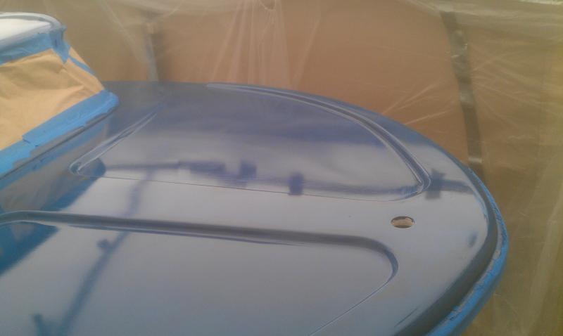

                          Friday and Saturday were spent taking off all the old masking tape and papers, re-masking, cleaning up, and building out the "booth". What a job! The previously painted edges at the rub rail had to be blended into the primer, which was not difficult. I even got to run the single longest piece of tape I think I have ever done when I covered the rail from stbd all the way to port on a single pull of 4 inch masking tape.

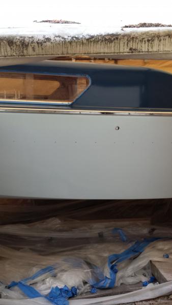

                          Sunday morning bright and early and with good weather, I set out for the first coat of paint on the topsides! WooWoo!
                          As usual, the Supermarine paint is pretty easy to work with and didn't present any problems. Rolling and tipping solo took me about an hour and a half to apply. For a first coat, it looks pretty good. There are two spots of concern that I am keeping an eye on though. My last big repairs on the side gnl's are rough. I used a spray primer on those areas and sanded it down, but it isn't laying as flat as the rest of the boat is. Tonight when I go out for coat number 2, I am going to start there. If the paint fills the roughness, which I expect it will, I'll leave it alone. If not, I will clean the paint off and then hit it with a 230 grit to smooth it out some.
                          Attached are various shots a few hours after painting. I think the paint is still wet at the time of the photos, hence the super shine. Having worked with this on the bottom, I expect excellent coverage and shine when it is all done.

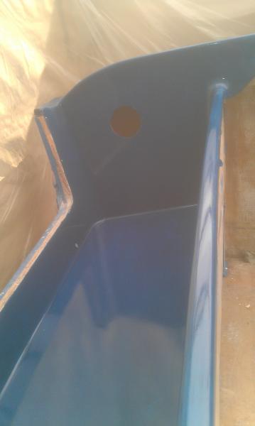

                              • #90

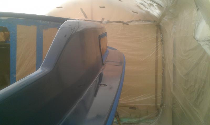

                                Painting is done! 7 coats on the topside. I still have about half a gallon left, so I should be able to use it on the trailer in the comming month or two when it gets rebuilt.
                                I removed all of the masking and covers last night except for the window wedges. Ran out of time.
                                No sanding done yet on either the top or bottom, that is to come later. I'm pretty happy with it so far!
                                Here are a few shots with both colors. And a reminder of how awful it looked when I brought it home...
