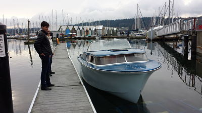

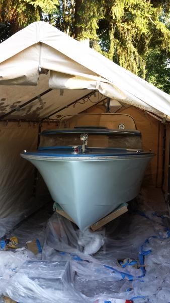

    I've been doing other things than messing with paint for the last week or so. Helm is stained, windshield is fully restored, and other odds and sods. Last night I pulled up the front door to the shed to get a good look at the boat while I fiddled with placement of deck hardware. None of this is actually mounted yet as the jury is out for placement of the horn and spotlight. Still, my first good look at the boat from further away than 3 feet!

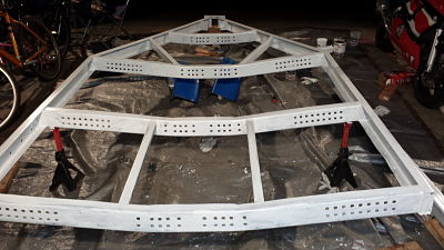

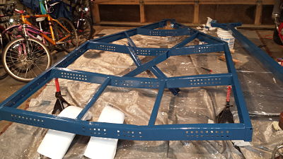

        Trailer.
        I've completely restored the original EZ Loader trailer. There is a lot of metal there and despite the rust, it was in really good shape with the exception of the axle, hubs, wheels. I wire brushed the whole thing down to bare metal and then gave it a bath with phosphoric acid. Then barrier coat primer went on, the nasty 2 part stuff that I tried using on the hull. After that, it got 2 coats of the topside paint I am using so it is a great match. New rollers, roller brackets, and bunks, new winch. I have a new axle and hubs on order and will install those when they come in. Light kit is in hand and also needs to be installed. All in all, it is around $700 worth of parts. Not cheap, but still a lot cheaper than a new trailer!

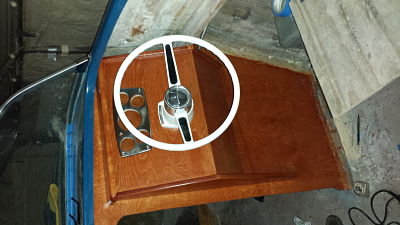

          Helm.

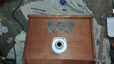

          While the helm was built and stained a while ago, it needed to be completed prior to mounting. The steering column needed to be centered and installed (4 holes), gauge cluster positioned and mounted and instrument holes cut (7 holes). Additionally, the gauge cluster plate needed an extra hole so I could place the 4 2 inch instruments I want. It is a 60s era Mercuriser plate made of some really hard stainless steel and was a total pain to cut out. With that done, the instrument holes were then cut. Not fun cutting the big 4 incher! Prior to mounting, I measured a cutout for the backside of the bulkhead to allow for wiring and steering access. It will get a nicely trimmed out cabinet style door when the interior is done. Inside the helm I'll have a 12 bus common bar as well as the main power switch. Once the holes and such were in place, it was time to mount the steering fully. Cable in, rack and pinion in - time to mount! It mounted up great. The only mess up is that I didn't notice the top portion is touching the combing as it comes down by the corner. Oh well. It still looks good but will have to be dealt with when trimming it out.

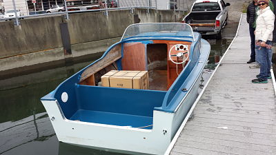

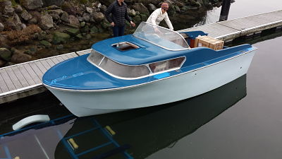

                          • It Floats!
                            Took her down to the launch Saturday after rigging the trailer axle up. With two batteries, two downriggers, 20 pounds of downrigger balls and the stern seats in the back and 240 pounds of sand amidships (fuel simulation), we dropped her in. Very buoyant! Even with two adult males standing on the transom, there was very little displacement. She should handle the 140 with no problem!
                            The plan is to haul her up to PA this weekend and get the engine mounted. With that done, sea trials should start in the next month. I can hardly believe it.
