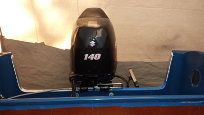

                  • Back from the shop. Engine is mounted and looks great back there! We ran it at the shop and it sounds fantastic. With open exhaust it is quieter than my 2 stroke in the water for sure. And it certainly smells better! Should make the wife and kids happy! Heck, my dog might even want to ride with us now.
                    Gauges are all wired up with the exception of fuel, but they all need to be properly mounted. The thickness of the helm means that the factory brackets will need to be tweaked to work. I'll be tackling that this week.
                    There were two snags. The tech wouldn't tap the ACR wire, so I'll have to identify that myself and wire it up.
                    The other issue was the steering. The tech coupled it up nice and tidy at the engine. But it was backwards! Looks like I installed the rack upside down. I got it sorted last night (not easy in that limited space helm!) and she will now turn in the correct direction...

                    • That's one sexy outboard! I'm excited for your first run...you should have your kids video the launch and take off...then come back and get them

                        That is a great engine. I have the same one that I use for waterskiing and towing tubes behind a 19' bow rider.
                        It is so very quiet. I love it.

                          Good to hear that it is quiet for you. I was so impressed with my friends 90 for that and other reasons, that I knew that I'd be getting a zuke.
