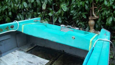

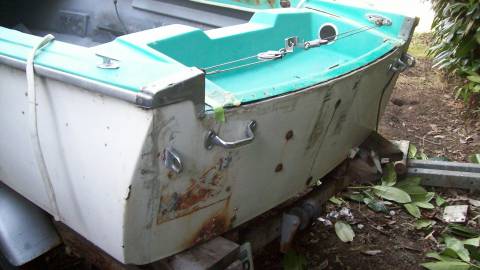

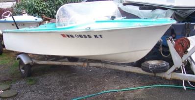

All this talk of transoms has me ready to pour out some resin.Went to battle with my classic-in-waiting,the Teal 14` Trailorboat needing new transom and Floors.
Let`s start with the transom.

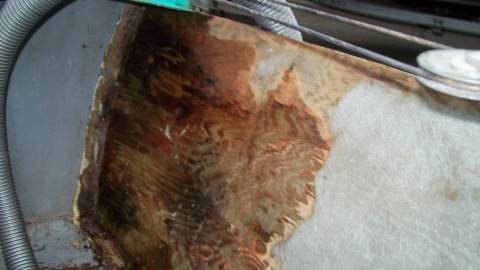

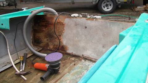

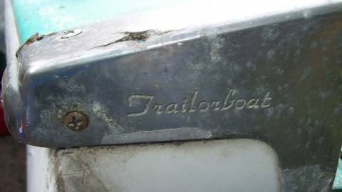

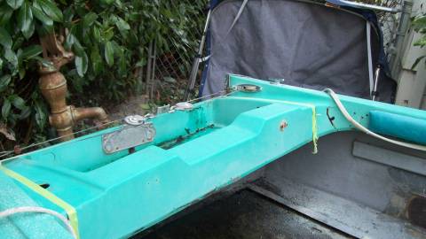

Day 1: Cut the splashwell for easy replacement and so I can address the very thin corners ,broken flanges and major crack on one side of the gunnel.
The wood came out with a prybar and chisel and my Grinder chewed out the last 1/4`` layer.
Now to dry it out and clean up the corners for good clean flanges and a true pattern.
Spent 2 hours chipping,then 2 more a day later grinding and am ready for a pattern today.Smaller boats progress quicker,more switching of tools than actual work......guess I should do the Glasspar next to it.
Hope these pics help.More in camera from yesterday,we`ll start with these.
