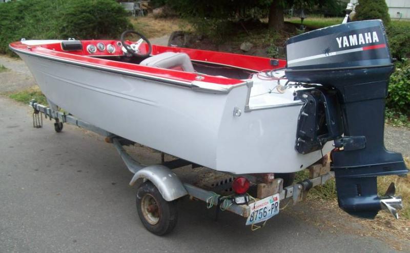

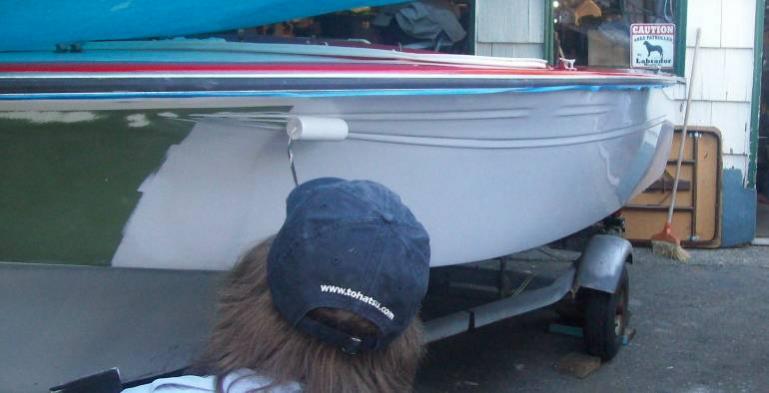

    First ,see if the old stuff will come off with acetone so you know whether to scuff and paint with similar or if primer is truly needed.
    I used some 2-part Perfection over ugly green Glasspar sides and did it with no expensive primer just to see how it held.....$50 boat ,what the heck.
    It hasn`t flaked or anything along the edges which I sorta expected to want to lift.It worked great and I`ll only do full primer for topsides and hulls with major repairs and plugged holes.
    A good car/Boat painter ,Tom Casilas ,showed me a 1960+Suburban he used this technique since he has now realized most primers have Talcum powder of some sort for the leveling.This is the same stuff gymnasts use to keep their fingers FROM sticking to the bars,NOT for gripping.
    Now he`ll only prime on new construction and over heavily faired and hole filled Cars and Boats.Show cars/Boats of course will get the full treatment of course.
    Pretty sure you`ll find it is single part which can still be re-coated after some oil removal (from motors,and from the road) first,then simply scuffing with scotchbrite until fuzzy all over.
    If you really want to prime,then use Brightside for one-part topcoats.No-Sand primers are available too.....Brightside needs some 220-320 action before topcoats,again more work......
    You could do a test on the transom if in doubt of what you`ll get.The first coat is best to be thin ,then fuzz it up once more before another coat.A 3rd coat would make it very nice but you guys will use it so enjoy what you get,then stack the 3 rd one later when it shows some wear.
    If you really want to save some time ,bring it by flipped over and I`ll sand it down for you guys with my dustless........1 hr and you`ll be on the way home.
    You guys do the edges and buy the sanding Pads! And don`t forget the Beer!
    2nd:Old Firehose can make a nice soft rubrail if found somehow.Makes it look older and not so shiny like modern rubrails.Or some White Rubber "D" shaped dock edging would be easy to screw right on with cupped washers.
    3 rd Look for a 90`s 4-5 hp one cylinder Nissan/Tohatsu/Mercury as it will weigh only 37 lbs.....most 2-3 hp motors will only be forward only.The newer 4 strokes will weigh 44-46 lbs lbs in most cases.Some of these are still fwd and neutral only with no reverse.Some new 4`s have a remote fuel fitting AND built-in fuel tank options....5+6 hp won`t offer it.The 4 weighs the 46 because of the tank.
