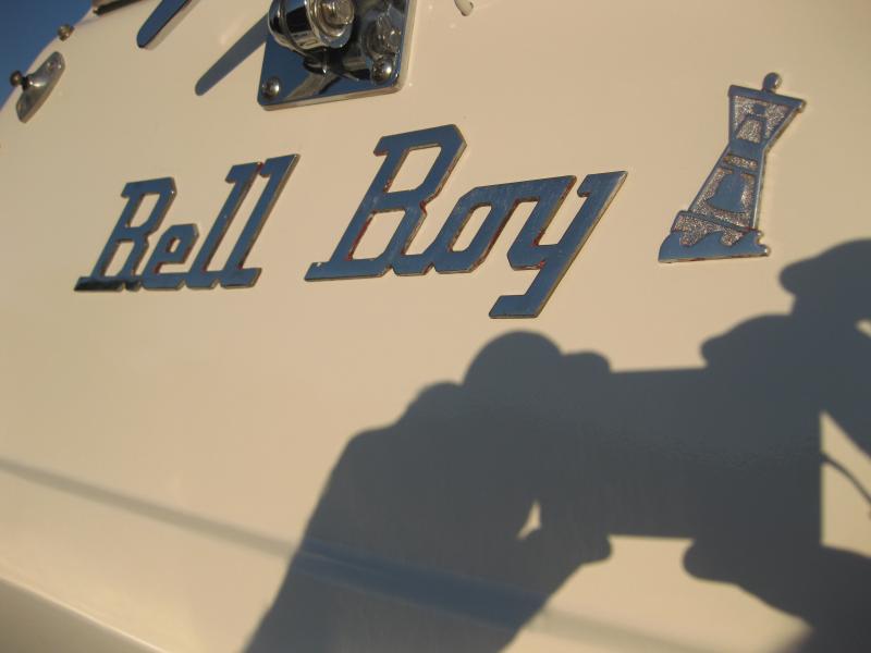

      Marty, I could not help but notice this resto was done with newer block style emblems. Were these just re-chromed or were they fabricated by someon up there? My guy felt he could not get the forge right because my emblems did not push deep enough into the clay mold. It looks like you had better luck on your end.
      Congrats on such artisan -level work.

        Bell Boy 21 Emblems
        Bob -
        Thanks for the nice comments....
        The BB21 emblems were originals, rechromed.

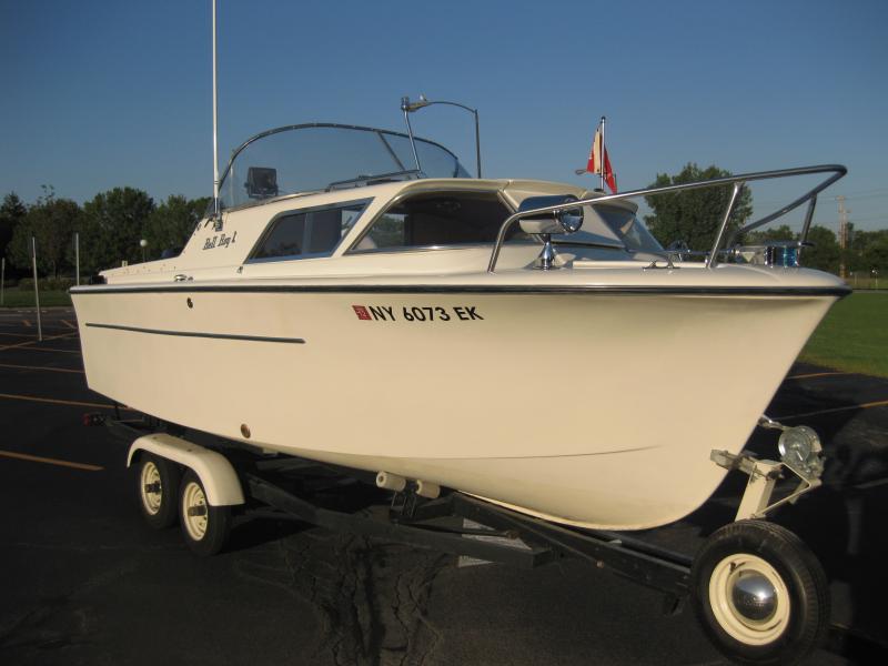

            It has Sterling paint on it. Roll and tip and the hull looked like it had been sprayed on. Fact is, most of it looked like it had been sprayed.
            Typical glassing in the larger tank fill holes and such, fact is, anything larger than a pencil has fiberglass patches inside and out, anything smaller was Evercoat lite with the fiberglass hair in it..
            Marty and I painted that boat.

                Sterling is obviously good paint, but I'm still not sure it's worth the (high) price, when compared with Interlux Perfection or other choices. Between the two colors of Sterling, plus Sterling primer, reducers, catalysts, etc., we--meaning Bruce, the customer--spent just over $1,200 on paint/primer alone. And that's before you start the process of painting, wet-sanding, buffing, etc.
                The two-part Perfection paint we've used on other projects went on just as well as Sterling, covered just as nicely and seemed to cure just as hard. So maybe there's an advantage to Sterling I'm not aware of, but we could have purchased all of the required Perfection products, including primer, for $400-$500, vs. $1,200 for the Sterling package.
                Anyone have more experience with two-part paints?
                For my personal boats, I'm thinking of going back to the simplicity and affordability of Interlux Brightside Polyurethane or Pettit Easypoxy, the one-part paints that go on just as nicely as the two-parters and seem to hold up well enough.
