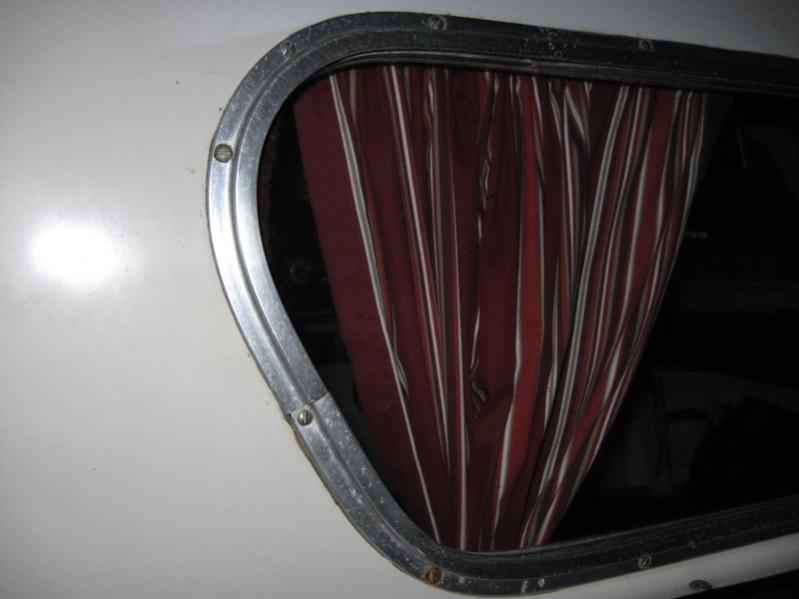

          @ Kent, the Skagit window frames are fastened from the inside with no exposed fastenings on the outside frames as shown in the photo you attrached.
