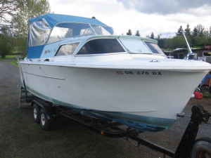

    Hi all, Kent WA Bell Boy owner here. Finally am getting off my duff and working on the old gal. Bought her out of Portland around a year or so ago, came with a pair of matching 1960 Evinrude 40 Lark II engines.
    Thanks to this forum I've found that Middy Marine has the windshield molds and can supply me with a replacement, mine's not too bad but it is cracked and as typical stress lines throughout. The cabin windows have been painted (!) and rather than try to clean them I'll replace them instead. This will give me the opportunity to polish the aluminum trim around them...and the repaint will be that much nicer without having to mask around the edges.

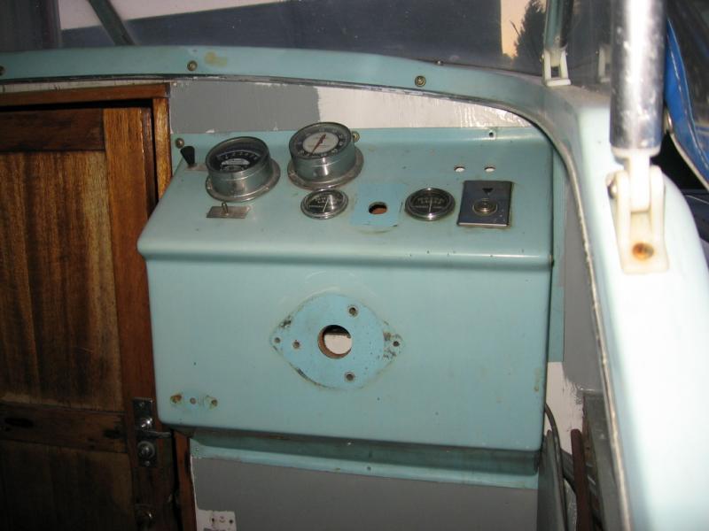

    Was wondering if anyone has photos of the interior and dash as built...even a sales brochure would be helpful. There are missing switches etc from the dash and additional holes...would like to know what to remove/replace and/or holes to fill to make it original (or nearly so). Especially would like to find an original steering wheel and hub...will adapt it to a modern system but once again, I want the original look.

      Thanks for the offer John. Does your helm have the same shape/bolt pattern as in the below photo? Sort of a sideways oval with a hole on the left and right sides with 3 more around the center.
