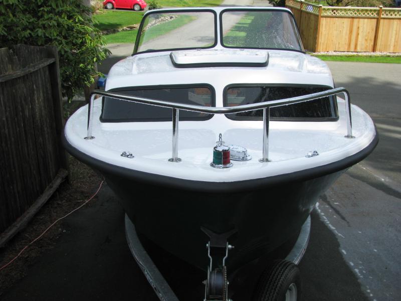

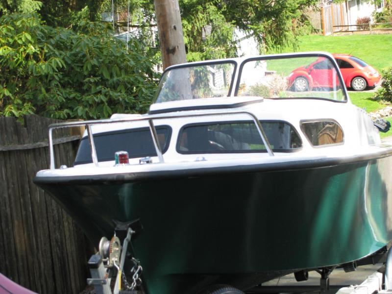

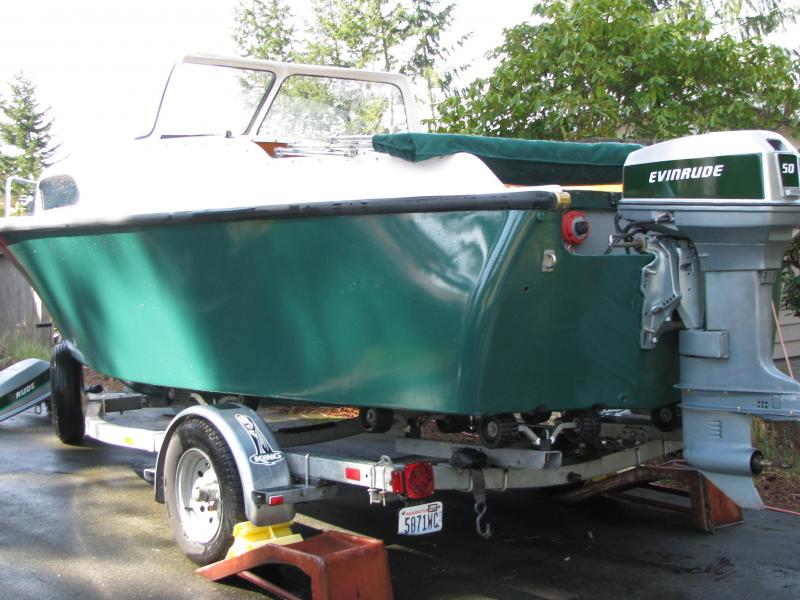

As Greg Lamp put it this was more of a "remodel" then anything else. I got rid of some of the hardware and repositioned some of it also. I like the look of the original windshield frame and the hatch cover was changed to one with a rib down the middle for added strength. I got both of them from Chuck Cary and both were a total mess so I restored both of them. The windshield frame had over fifty holes in it from snaps,ancher light and a spot light. The white paint on the deck was starting to crack and because I had retouched the haul so many times over the years I decided to strip everything down as far as I could get it. I primed twice sanding in beyween coats and the deck got three coats sanding with 120, 220, and 320 grit in between coats. Thanks Lony and Helmar for your nice comments, hopefully I"ll have all this done by opening day, weather pemitting.Greg James
