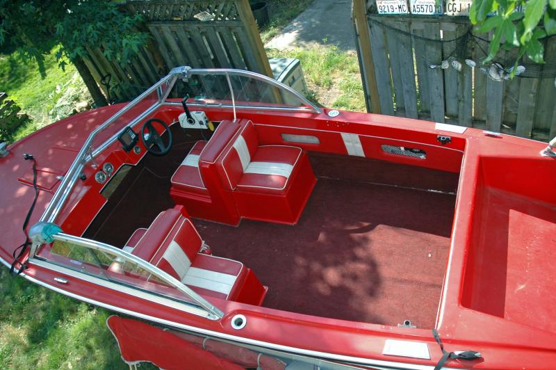

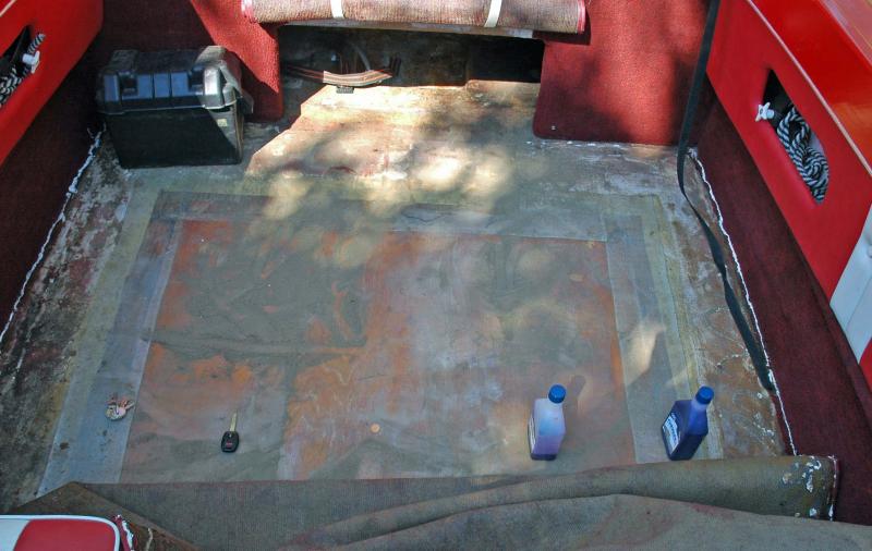

              I looked all over the boat this morning and saw no evidence of fuel or water tanks. They certainly were not in the molded back to back seats. Might have been under the rear floor. There were two "fuel" fillers and two vent holes that looked original so it is puzzeling. They replaced the rear floor at one point so it could have been rot or it could have been tanks. Who knows.
              Hull does seem lighter in construction than the 1958 Offshore that Chuck is now cruising around on.
              With back to back original seats and no rear seat there is a lot or room to move about and lots of space under the splashwell.
