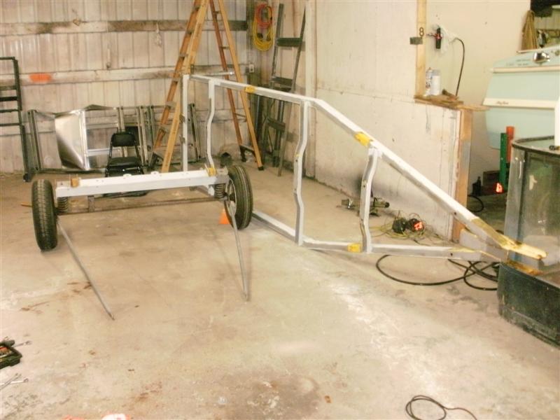

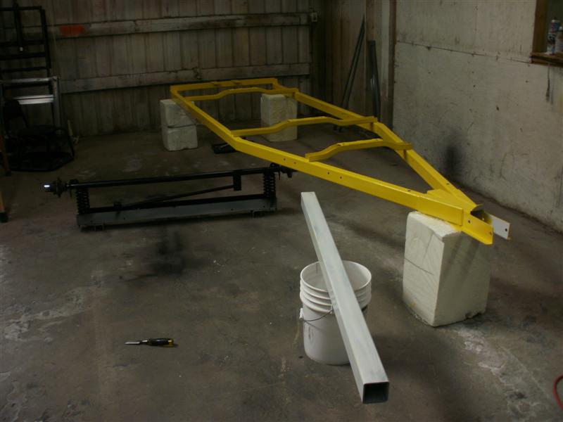

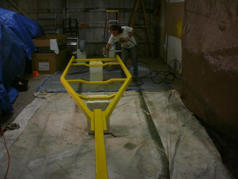

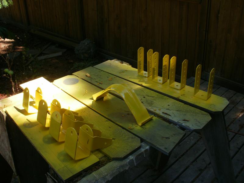

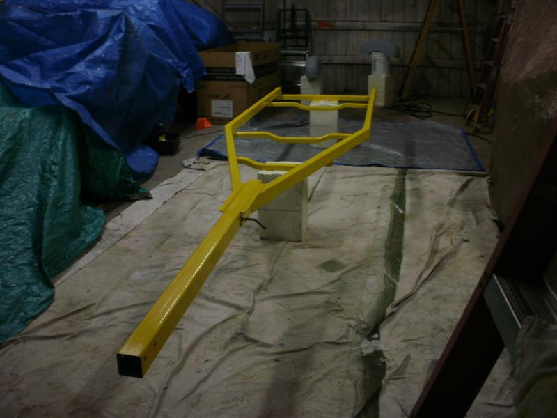

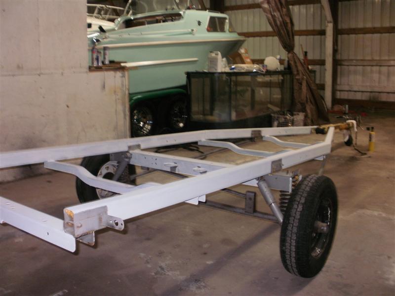

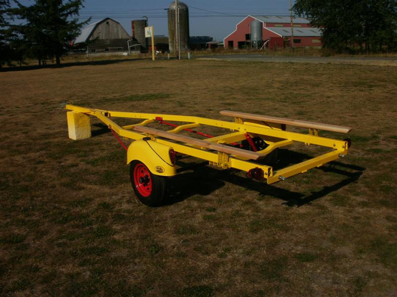

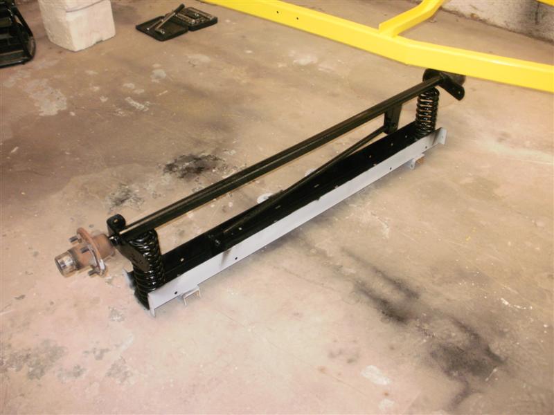

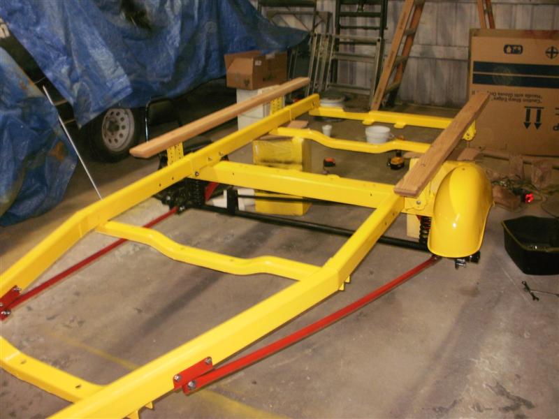

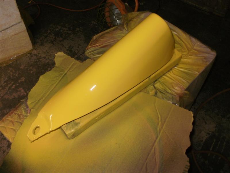

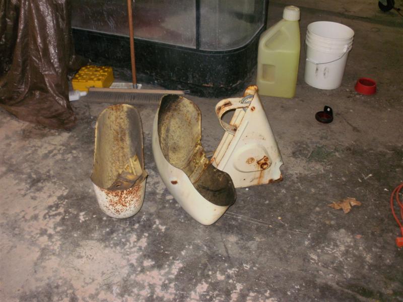

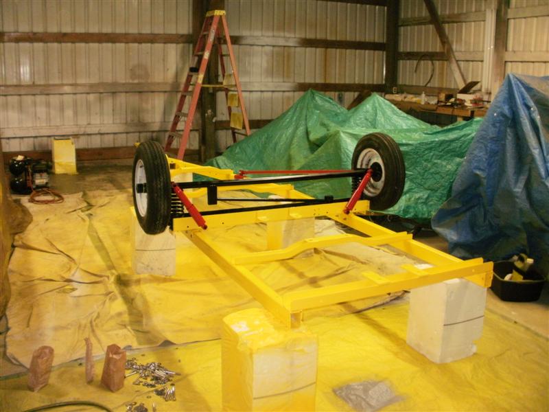

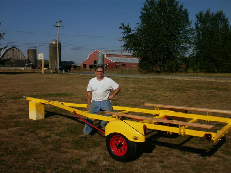

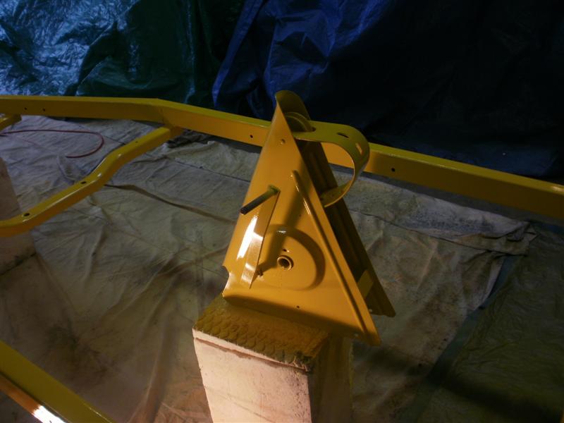

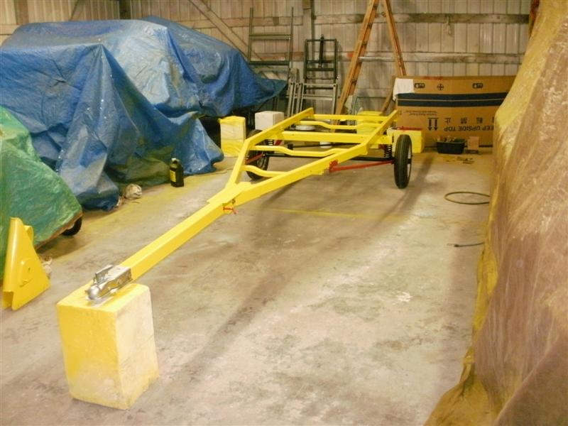

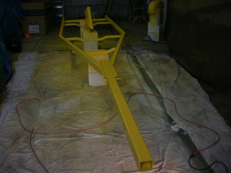

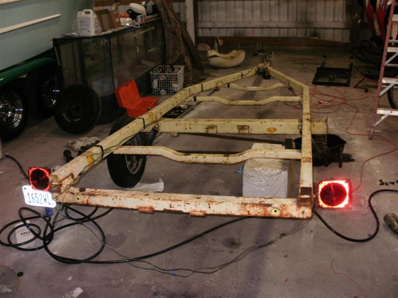

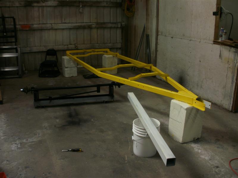

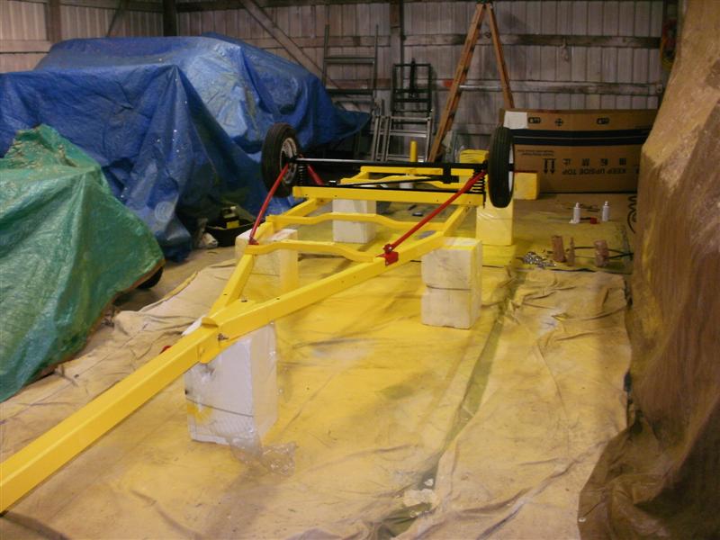

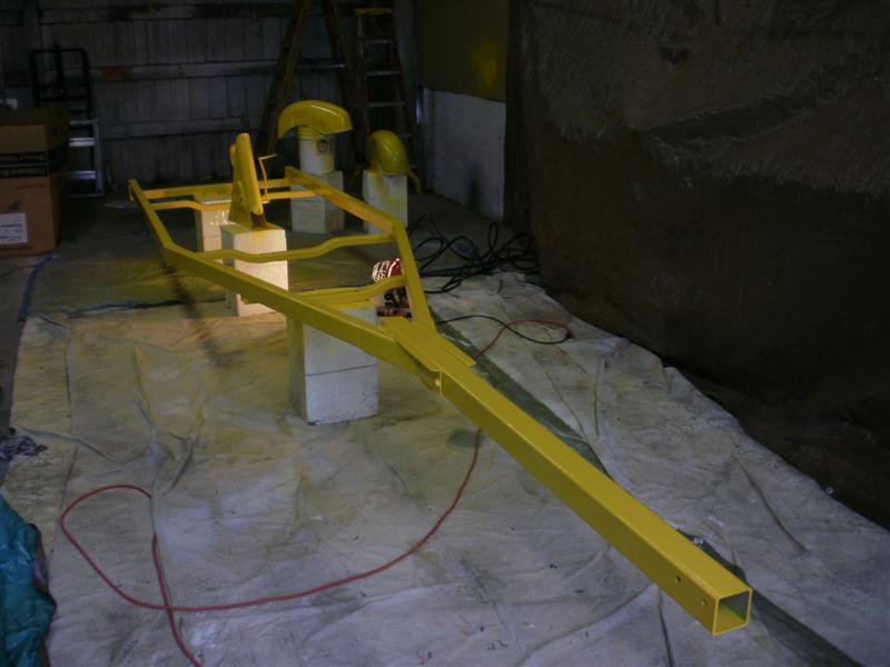

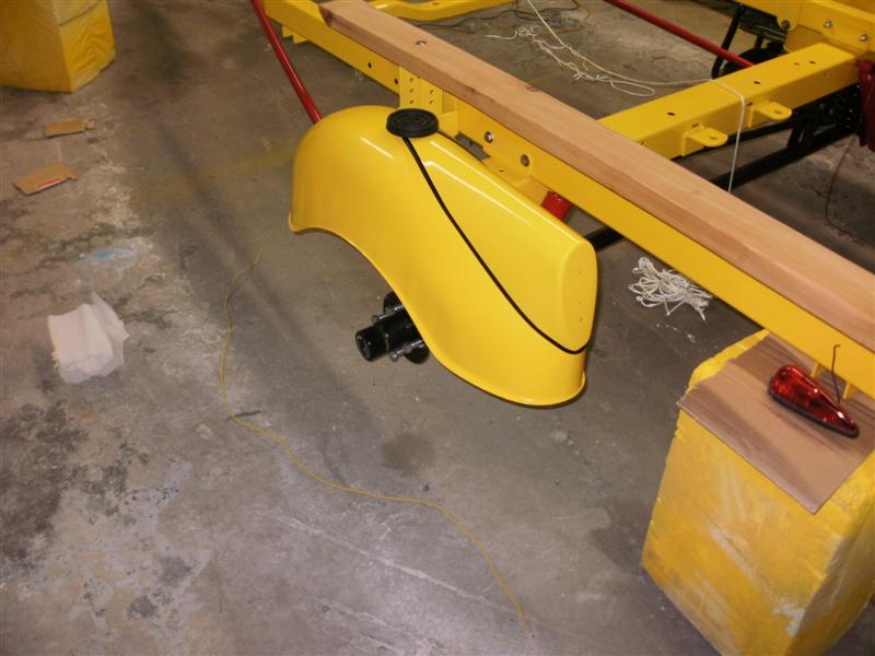

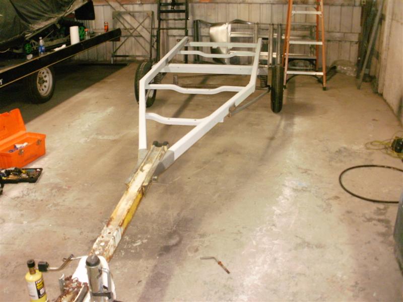

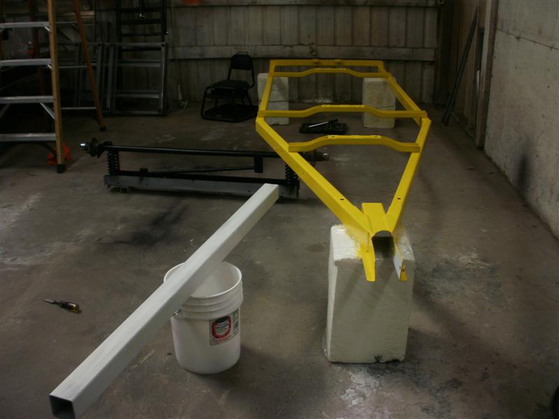

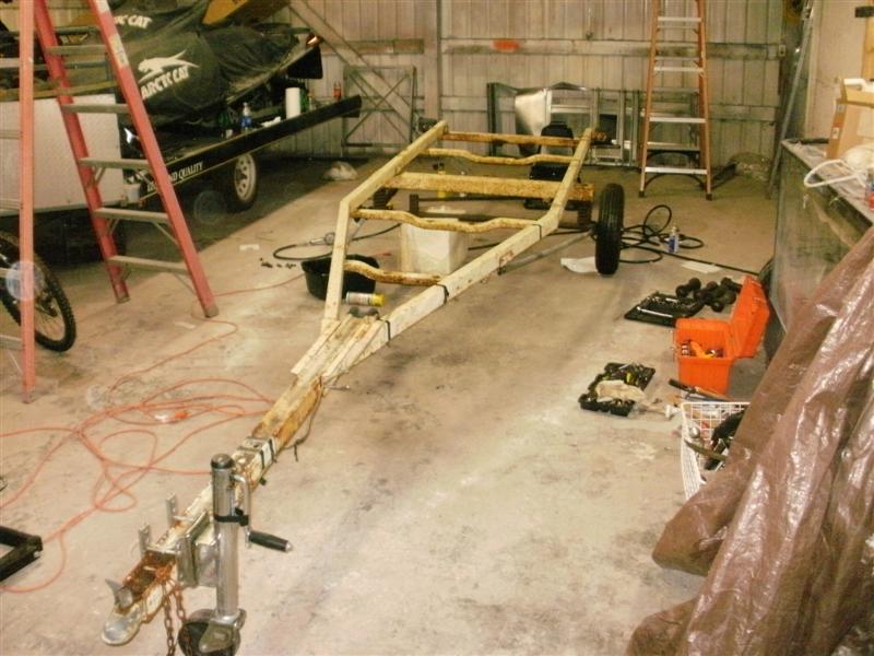

I've been up to my neck trying to get the trailer I bought from Marty Restored so when I get the final coat of paint on the bottom of the Falls Flyer I can flip it over on the new trailer and not have to move it again till it goes in the water. I had a Tee Nee trailer that came with the boat but it had a different roller configuration that was installed when they built the trailer. There was no way to remove the old rollers with out having to either cut the trailer in half or cut the rollers off and drill the frame to remove the pins ? Lot of work either way. When Marty's came up it had a different type of roller configuration and was in alot better shape than mine. Most of the main parts were the same so now I have 4 fenders, two winch stands , Etc . So now I'm completely stripping Marty's down and figuring the best parts to make one good trailer. In the shop where I rent a space for the Dorsett we have an empty bay that I can use for about two weeks so the pressure is on. Got everything taken off the trailer and had it sand blasted. Forward piece with the coupler had been broken or bent and had a dual bolt repair done to it. I removed that piece and got a new 3" pipe to fit and a new coupler. Got everything primed and all the small pieces were bead blasted - primed and painted. Melanie came over and switched the hubs and bearing buddies off the old trailer and I have a set of new bearings coming. Every piece is ready to put back together. Painted a coat of primer on the frame and a coat of yellow over that. Monday Melanie and I are going to drill and fit the new steel and coupler then spray a final coat of yellow on the frame. With this heat it will dry real nice and it's always fun putting the pieces back together. Spent almost as much on Stainless bolts and washers then I paid for the trailer but everything will be brand new. Figured I'd start a new thread since this wasn't really part of the Flyer restoration. Also have Thom ( Frankenmerc ) putting me in the cycle for a 1959 - Merc 58AE Motor. If the one he is checking out for me is good I should have that done by next spring for the launch. Now both of my trailers have been owned by Marty at one time or another.

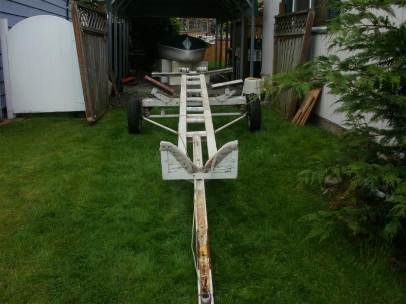

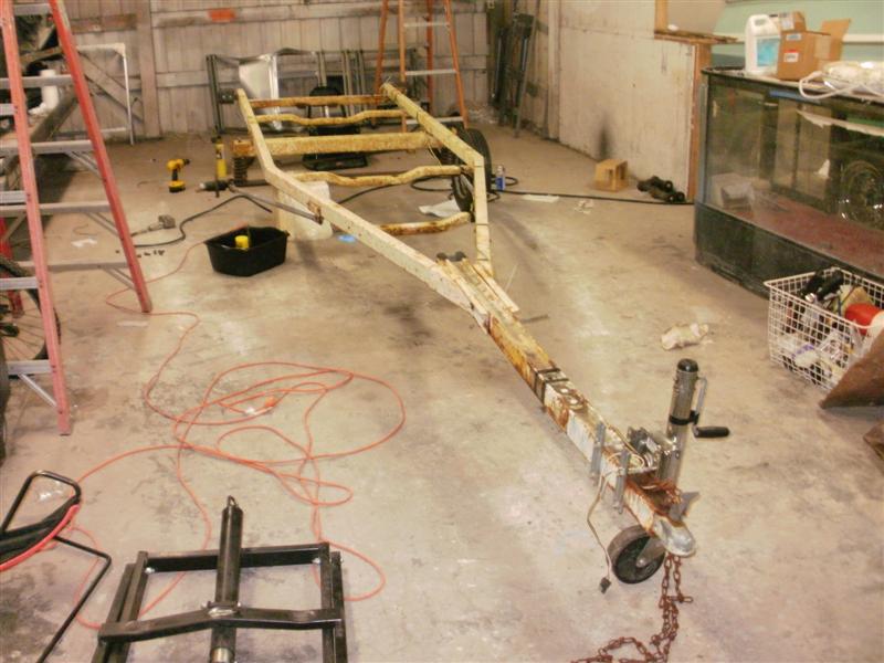

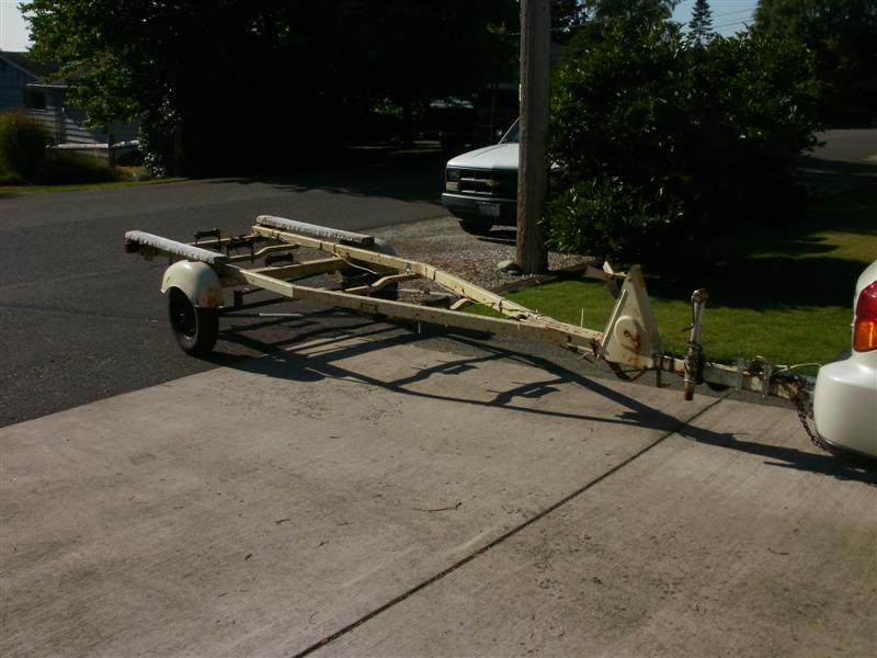

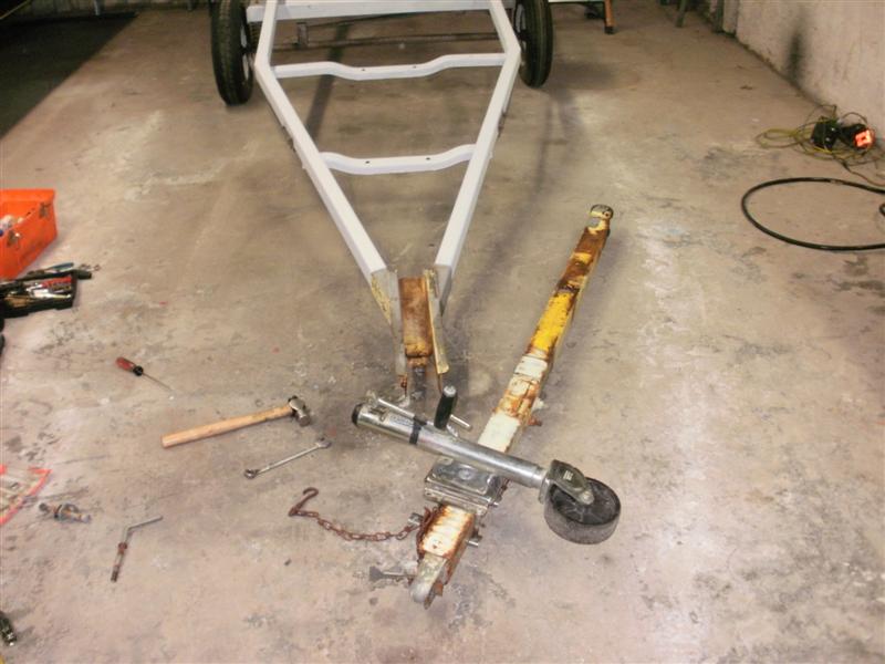

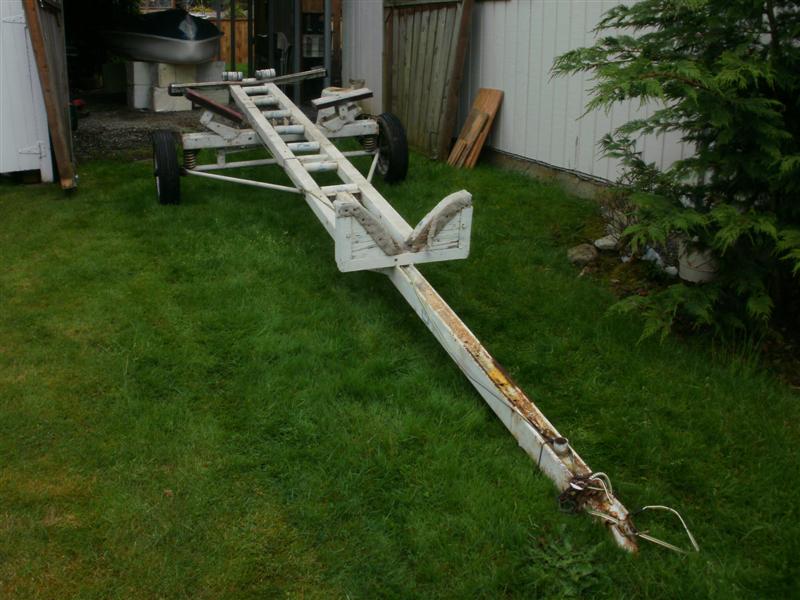

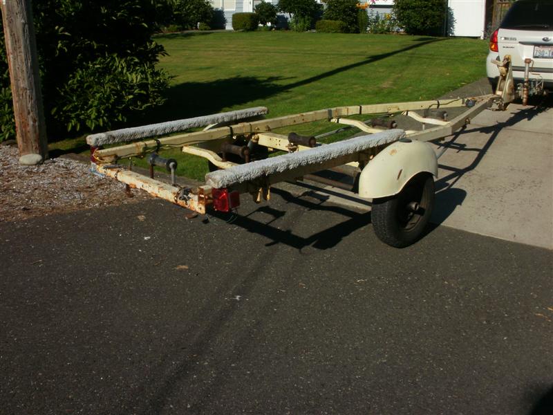

First picture is my original trailer note the rollers down the center .
