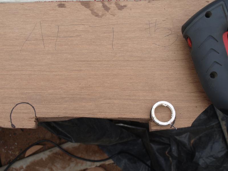

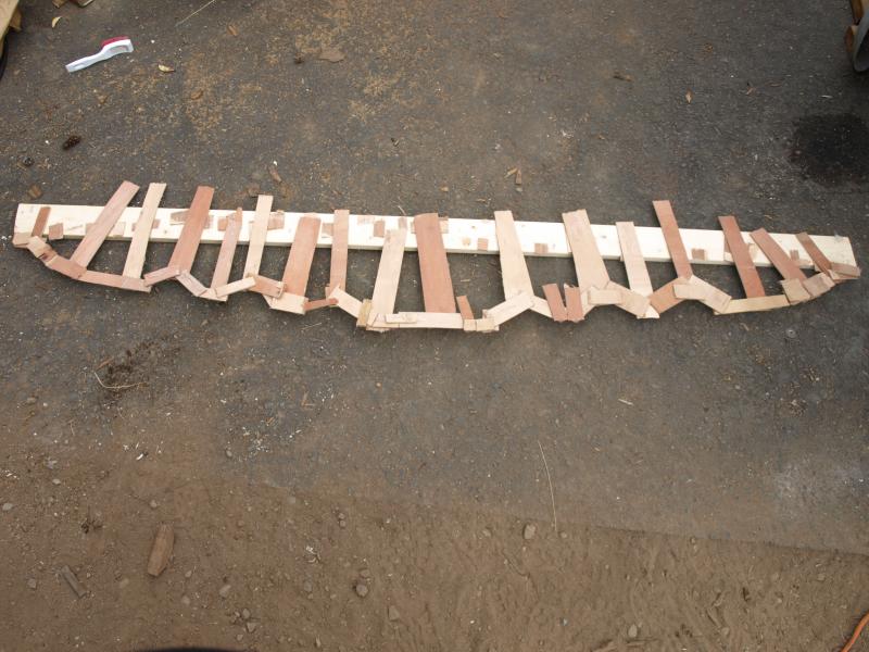

          The initial templates and frames were a waste of time. I thought I would make the frames, set them in place, mark on them where the stringers were going to go. Then I'd put the stringer reinforcements in, and everything would fit nicely. Wrong. There was too much change in stringer shape due to the reinforcement. I now see that I spent more time trimming and fitting the frames than I would have to just make new templates and start over. I couldn't make the template for frame #5 until I had the cabin bulkheads and floor out. Attached is what this template looks like. Much more useful that the eariler templates I made.
          Also, it was taking me forever to trim the bottom of the frames. That Okume 1088 ply is solid stuff, and an inch of it cuts like steel. I tried with my saber saws (I have two) and a rotozip spiral saw (horrible- not only slow but impossible to control.). About the fifth blade I tried with my Craftwman saber saw was wonderful. Not sure why I was having such trouble with the other blades. It would be better if I had a band saw, but I don't. Anyway, with this template and the correct blade, cutting and fitting took no time.

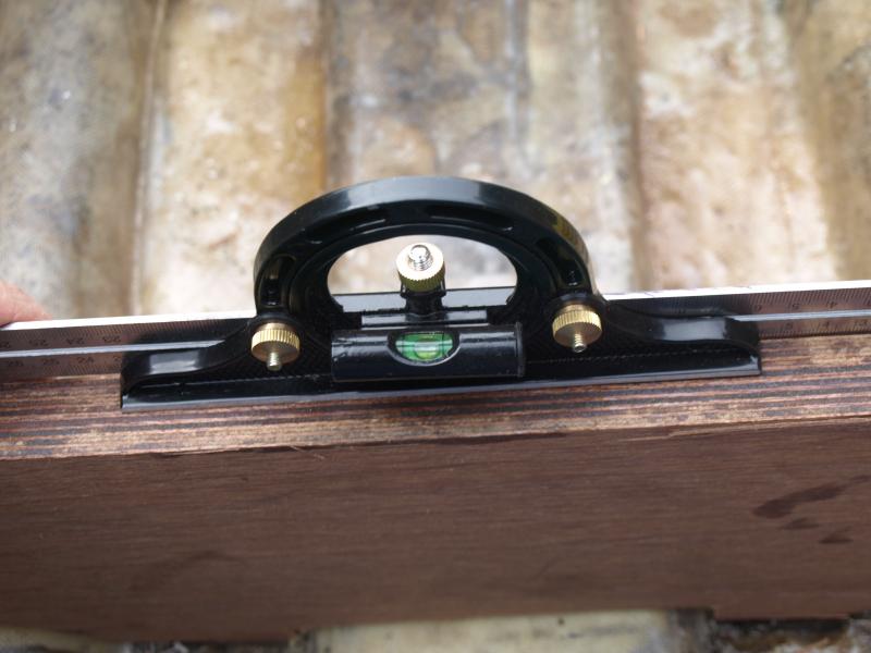

          Next I checked to see if the frames were parallel. I have this.. not sure what to call it. Poor man's clinometer? Anyway, it's a bubble level on a protractor on a ruler. I set the angle from the front three frames, inside the cabin. Fortunately those are nicely parallel. Then I checked the other five frames. Within the accuracy of the bubble level they are parallel.

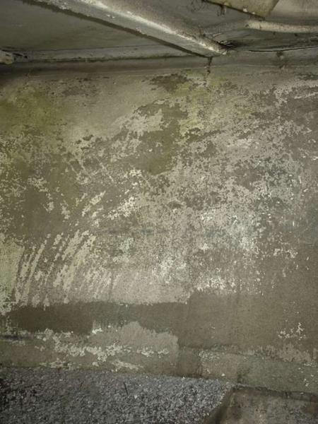

              Interesting comment Helmar. Thank you. I've always thought of these old boats as the standard of excellent worksmanship, and it's been downhill from there. Maybe I should think of them less idealistically. But either way, I love the design and I love that it's a classic, and I'm going to fix the defects.

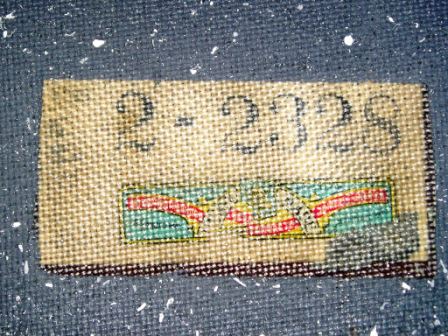

              I looked on the port side under the cabin window, and the only number I can find is in the first photo. Certainly looks to me like a hand-scrawled '8'. This was aft of the airbox, at about the aft end of the curved windshield and forward of the first flat window. The second picture shows the same area after I roughly scraped off the peeling paint. The number is gone- it was applied over the first coat of paint. There's a light-colored rectangle visible in the center of that picture. The top layer of glass has delaminated. Probably got hit at some time. Another small repair job. The third photo is a bit forward- above the airbox. No numbers there that I can see. So I guess I have hull #8.
              Question- does hull #8 mean the eight hull of that design, or eighth hull built? If the second, this probably is the prototype. Not that it makes any difference.

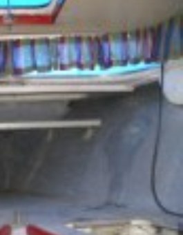

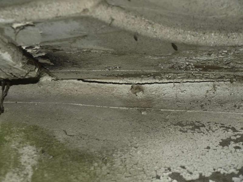

              Another thing I saw while poking around here. The glass connection between the deck and the hull doesn't look very strong, and it's broken on the starboard side under the forward deck. See photo #4. So that's going to get reinforced all the way around. I think a putty of epoxy and milled glass fibers to make a larger radius, and two layers of glass tape should do it.

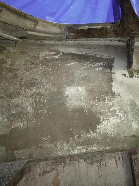

                The tag location is the second picture.
                Could be number 8 as not too many were built.
                The cabin windows - outer edges, were buckled and broken and popped out.
                This required some structure change as the front of the cabin deck was, well sinking down into the cabin so to speak.
                Meaning it was a weak design.
                Let me see if I can find a shot of what we did to beef that back up.
                I used some cribbing and blocking to jack the cabin back up until the window corners were relaxed, then went past that point just a hair and glassed in this structure beam that was custom cut to fit.
                It was made out of 1 and 1/4" thick mahogany, but could be out of whatever you like.

                  Don't know about the CA rules, but here in WA I took a picture of the hull number and was good to go with the licensing Dept. First picture shows location on starboard side, second is tag after cleaning. It was molded right in the fiberglass.
                  • #39

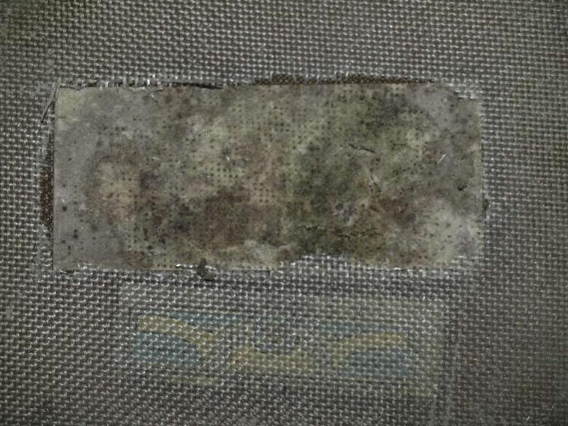

                    Thanks, Helmar and Sammamish1. The area where Sammamish1 has a tag is exactly the area where I said there was a delamination. I looked again and cleaned up carefully. There were two tags originally. The lower is just like the lower part of Sammamish1's tag. I can almost read it. The upper remains a rectangular gray area. So I cut off the overlaying lamination, and here's what it looks like now. There was a small visible defect, and obviously water leaked in. It was only one ply of glass anyway, and that's nowhere near 100% waterproof.
                    I'm going to let it dry, but I can't imagine I'm ever going to get a number off that. Expletive.

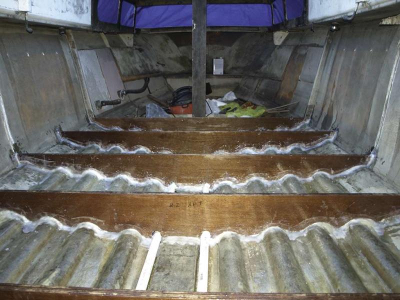

                                I've had a number of non-boat things to do for the last couple weeks, but when time permits I've been working on the floor frames. I've them all fitted, aligned, glued, filleted, and taped. I can now confidently say the floor will be strong.
                                Today and yesterday we're getting rain. At least everything aft the cabin is epoxy-encapsulated. It will be some time before I get the cockpit completed.
