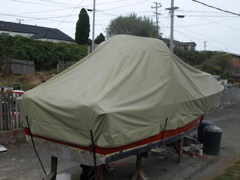

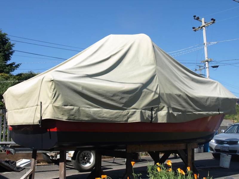

    Well said. Yes, one of the things I did early on was to make a nice (well, for a guy who never sewed anything before in his life) fitted cover. Made from waterproof/breathable polyester marine canvas. Any time I'm not actively working on the boat, it looks like this.
    I plan on using it mostly in the ocean here in the fog belt, so it has to have radar, so it has to have a radar arch, so I had that made first. That's the reason for the hump, but it does help reduce flat spots. It normally fits a bit tighter than this, but I had to remove the front eyes, so the strap at the bow has nothing to connect to.

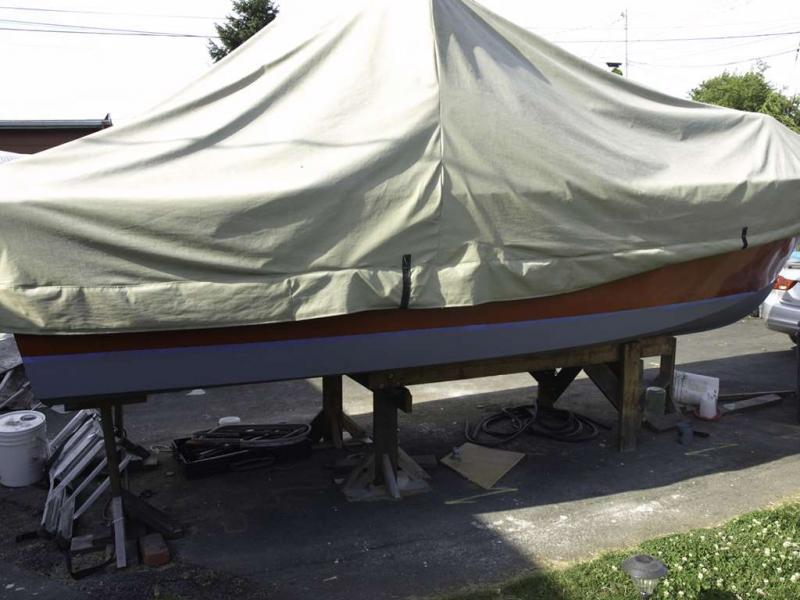

      I did some research and spoke to the paint guy at the local marine supply house, Englund's. The boat is going to be used mostly in salt water, and I hope sometimes to have it in the water for days or even weeks at a time. I decided on Pettit Vivid bottom paint. That sounds like the no-compromise paint. Hard ablative- good protection, hard enough for trailer use, smooth enough to be low drag, good clean colors. Now that it's on, I see it's not quite no-compromise. It's a flat paint, and given a choice I'd prefer a gloss. But at least it's a pretty good black.
      So you all know the drill- sand and putty and sand and putty and sand. The paint guy recommended Pettit 4700 primer. It's sold as a barrier coat against blistering, and the directions assume you're using it that way. So I put on four coats like the label says, but if I were doing it again I think I'd do one or at most two. I think I just gave myself extra sanding. And that stuff does not sand fast. Hours and hours lying on my back looking up at the hull while sanding dust floats gently down. Yes, I work googles and a paint mask. Then three coats of Vivid. I think after a week or so of hardening. I'll do a light hand sand with 400 grit to take off a few high spots, then a really light polish over the part that are obvious as you walk around it.

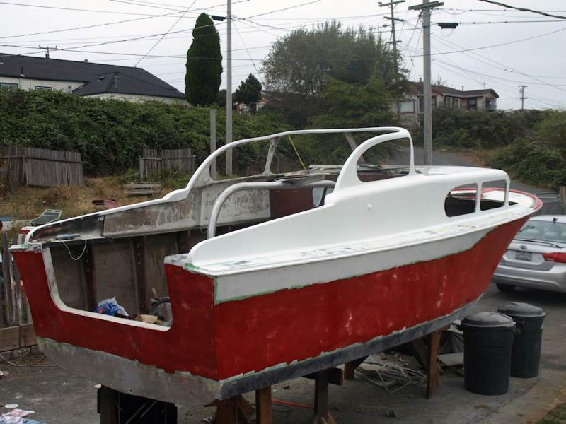

      So in the last month or so I've taken it from the first picture to the second (primer) to the third. I have a good used trailer. I'm going to put on disc brakes and new lights, and a it needs a little work here and there. Once it's on the trailer I'll start working on the interior.
