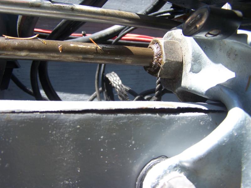

Step 1 -- See the break in the glass at the top of the transom? Considered a bad thing.

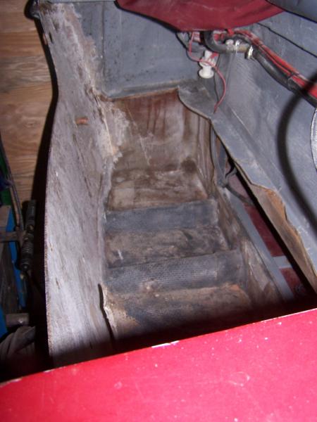

Step 2 -- Splash well cut away along with inside glass on transom. Rotten wood removed.

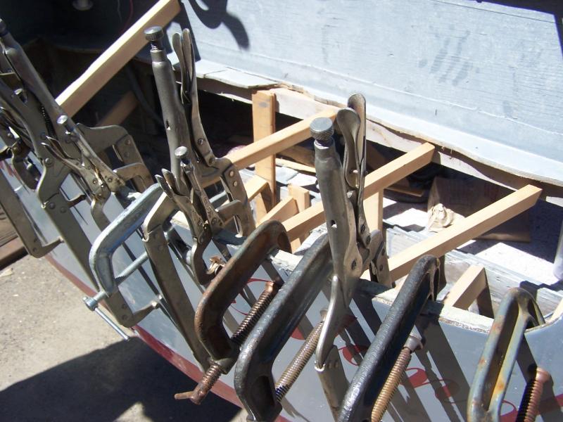

Step 3 -- First layer of Coosa board in place bent to curve in transom.

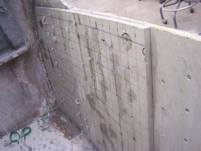

Step 4 -- Second layer of Coosa board added. Holes drilled in grid pattern to allow the fiberglass putty to not only grab the flat board but to penetrate and lock to the second layer.

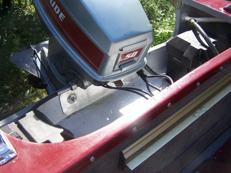

Step 5 -- Fiberglass and gel coat over entire splash well and aluminum plate sandwiching the transom. A bit of paint and some wax and ready to go in the water!
