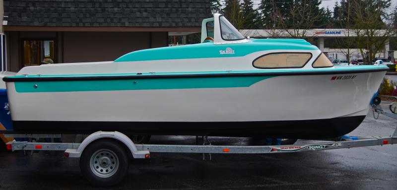

Skagit Windshield Done, At Last
Yesterday, Charlie and Pat Johns were finally able to take delivery of the '58 Skagit we restored for them, picking the boat up at Associated Glass in Lynnwood.
As reported earlier, Associated installed plexiglass in the cabin windows (still covered in brown paper for Charlie and Pat's road trip home to Richland), and then attempted to install 1955 Ford windshield glass in the upper frame. After receiving the one-piece wraparound windshield, Associated cut the piece down the centerline, then radiused the inside corners before installing in the Skagit windshield frame. Unfortunately, after completing the install, the starboard-side piece of glass developed a vertical crack...ruining the piece.
After debating the subject, Charlie and Pat opted not to invest in another expensive piece of automotive glass, and had Associated install plexiglass panels in the frame. The plexiglass looks great, but it's too bad that the auto glass broke...and that the experiment in using original Ford glass ended on an incomplete note.
Our speculation, for future reference, is that if anybody wants to go with auto glass on their 17' or 20' Skagit express, the safest approach is to remove the fiberglass windshield frame from the boat during windshield-glass installation, then gingerly reinstall the frame atop the cabin. If it doesn't want to seat comfortably, adjust with semi-soft rubber gasket material between the frame and cabintop, rather than forcing the frame and glass down into what might be a tortured position. (In the case of Charlie and Pat's boat, we restored the windshield frame off of the boat, painted it and reinstalled prior to Associated's work. While that seemed to be the logical approach, the glass clearly didn't nest in the frame comfortably or it wouldn't have broken...unless there was an inherent flaw in the particular windshield glass ordered by Associated, and/or it was damaged in shipping or during the cutting-fitting process. Just impossible to say for sure, but the fact that so many vintage Skagits with original Ford glass have panels of auto glass that have been trying to "walk" out of their rubber gaskets in the lower outside corners, would suggest that the Ford glass may never have fit perfectly into already-mounted frames.)
In any case, Charlie and Pat were happy with the final results, and we look forward to seeing their boat on the water later this Spring, following installation of a new four-stroke outboard.
