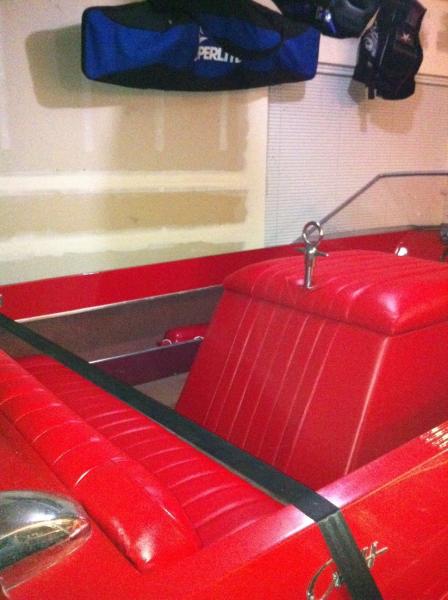

Its been awhile since I posted any updates on our restoration of our 1969 Chris Craft Cavalier, and its been a busy winter...

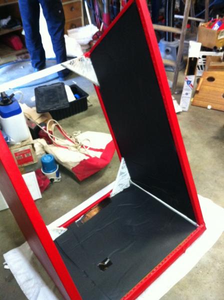

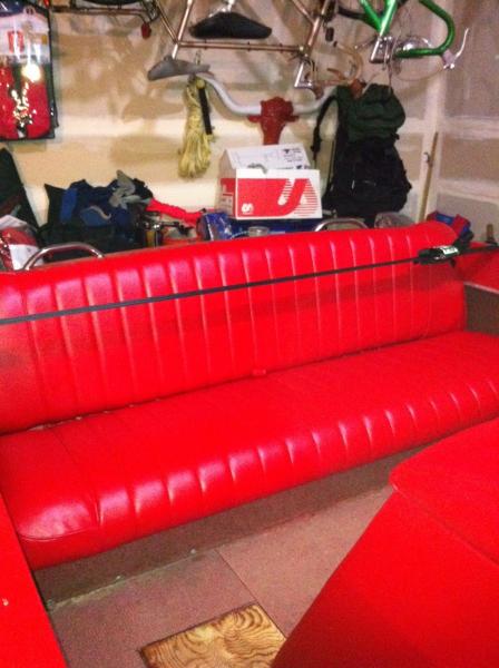

Some hints have been droped in several threads but we finally decided to replace all the interior vinyl in the boat this winter and Tim Mattson and his wife just completed the work...
After getting the pieces back we painted and sealed all the wood and then installed brand new sound / heat insulation in the engine box (old stuff was asbestos and coming apart:NoWay1

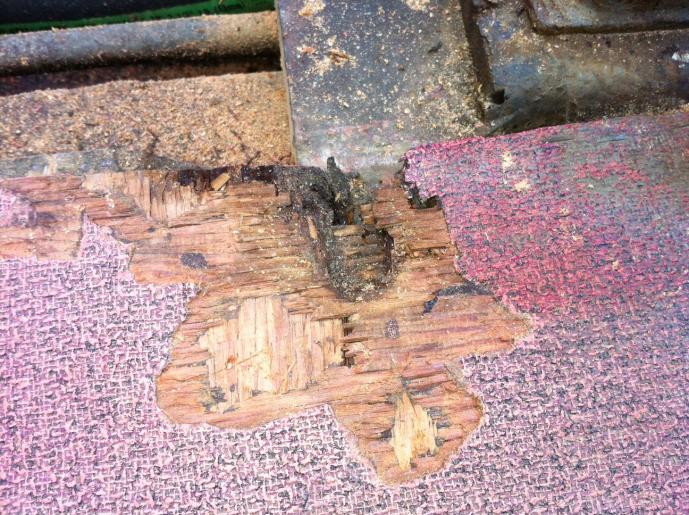

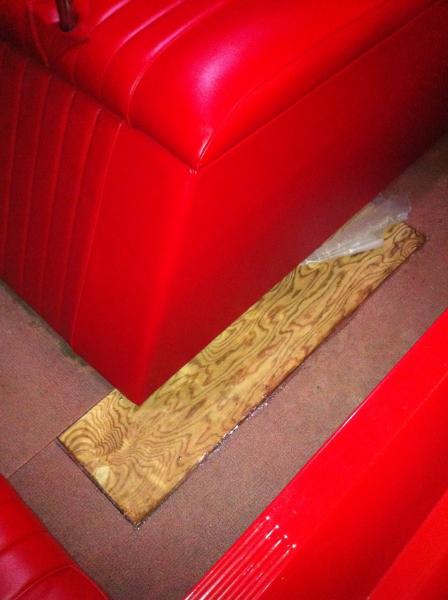

Having all new vinyl was the butt whooping I needed to finally gut the interior and fix the soft, rotted, spot in the floor. The original floor was covered in red Nautolex which is no longer in production so I still don't know what we are going to use for flooring but at least the rot is gone...
Floor repair (the cheater's way):

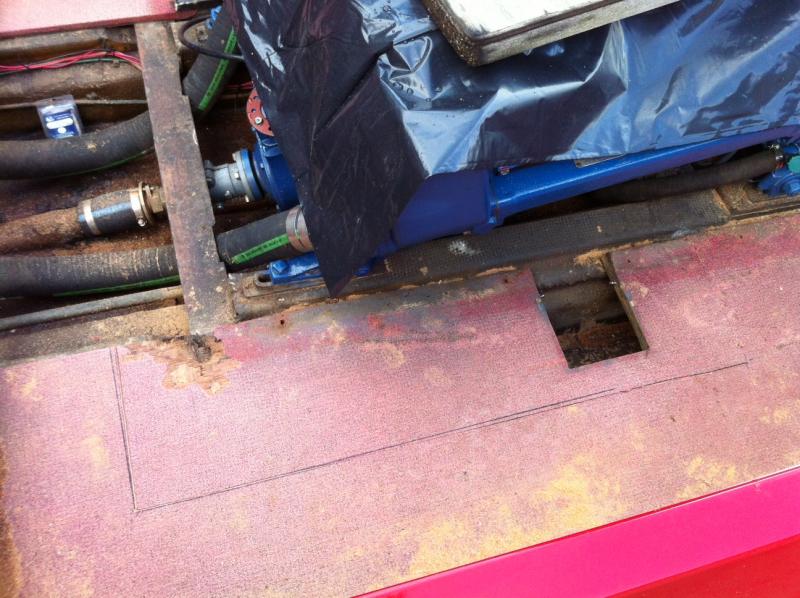

1: identify the ares that need to be removed.

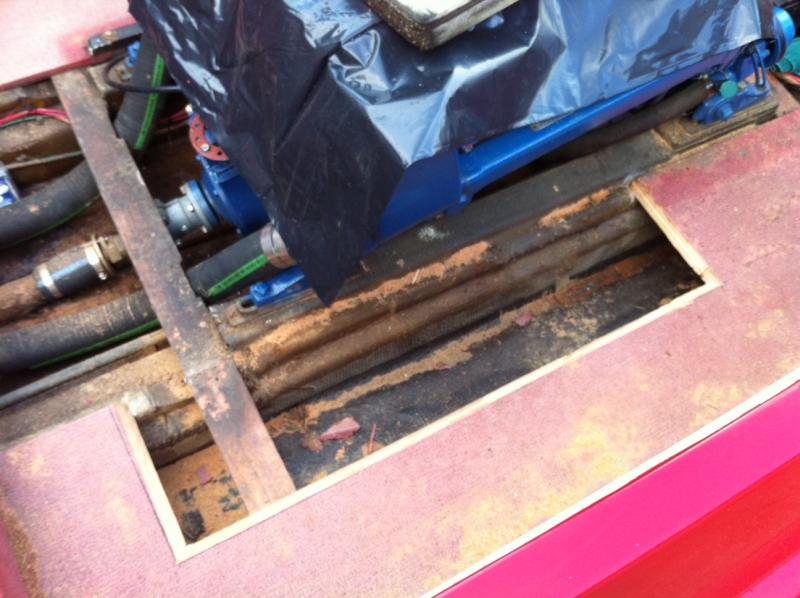

2: Cut out the infected areas using a 45 deg cut (creating a ledge in plywood)

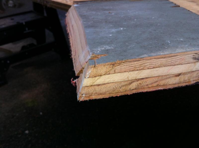

3: Cut a new filler piece using the same 45 deg cut (careful about cut direction)
4: Seal new plywood to prevent futer rot infection.
5: Epoxy new piece into the cutout using the 45 deg ledge to support and provide adequate bonding serfice.
6: Cover with flooring and nobody has to now it was patched. (Oops)
