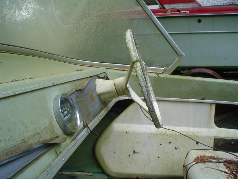

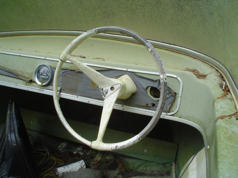

    Also, I have a complete Ride Guide setup in a Larson All American that's headed for the landfill, it's the only thing not yet salvaged off the boat. I haven't measured the cable but the steering works and you're welcome to it if you come pull it.

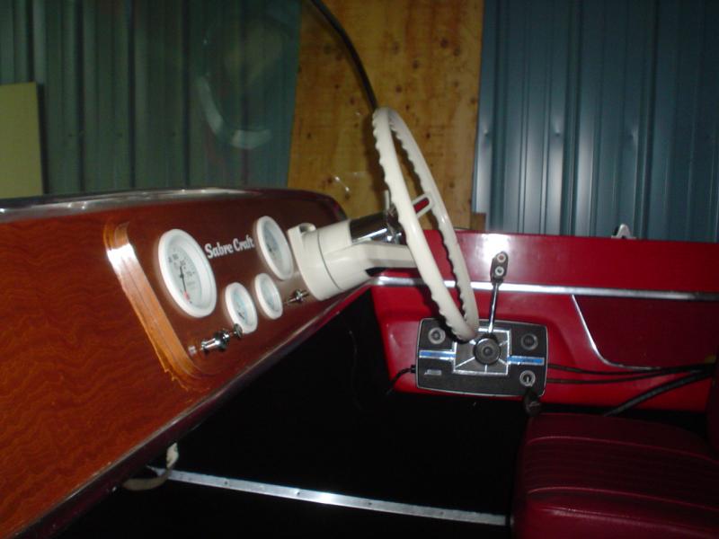

            Tim -- I ran into an issue getting the new helm installed this weekend. I'm pretty sure I have the wrong hub for my my style of boat. Comparing with pics I've seen of yours where the wheel operates in a plane parallel to the dash, the base of the helm I have is angled upwards so that, when attached, the wheel operates in a plane flatter than the dash. Which gives it almost a bus-like feel.
            I didn't realize they made more than one hub...but I'm thinking that's what the issue is. Does the larson have a hub similar to the one you have? I may need to grab that after all.
              The hub on the Larson is parallel to the dash, so it sounds like it would work better for your situation. I'll post a photo later today so you can see.

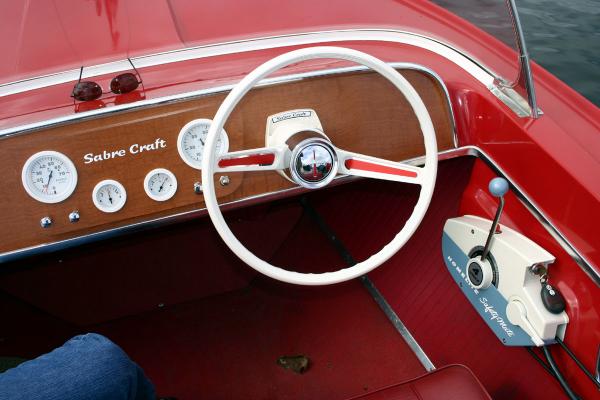

                    Michael - Here's a photo of the setup in the Larson and one of my boat. The wheel in the Larson is a different style but I would imagine that you could use that mount and your wheel. Don't know for sure, maybe someone else can chime in here.
                    John - My wheel doesn't have the stars, it just has the "spears" in red with chrome surround, but the folks at Bend Signs could sure make you what you need. They also made me a new "Sabrecraft" sticker for the bezel, originally it said "Quicksilver" there but Sabrecraft put their own sticker over the Merc one.
