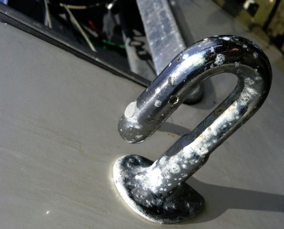

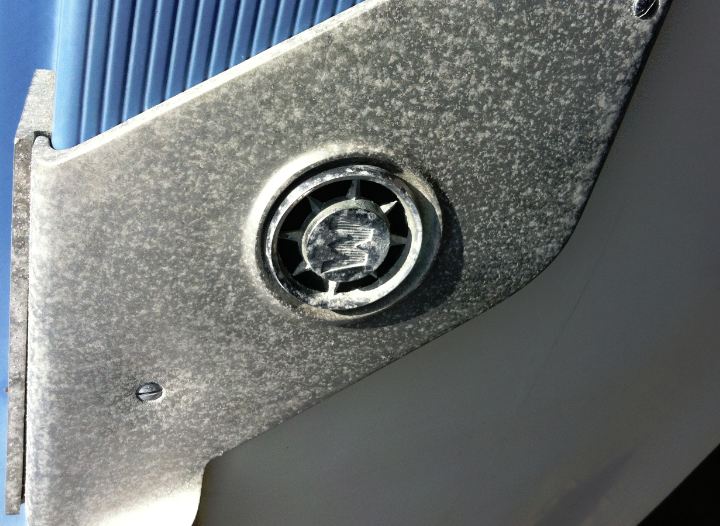

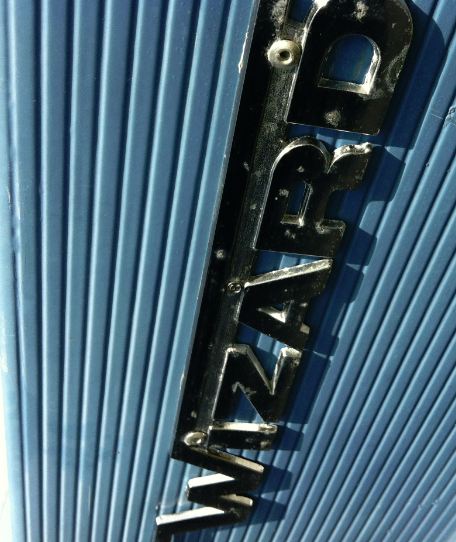

    I could use some advice on some of my trim - see the attached pictures.
    They are pretty oxidized and starting to get that pot metal peal thing going.
    I just bought these new Wizard emblems and they have already started to turn on me. Should I be coating them in something to prevent this or is it just the way it's going to be? My cleats are all the same way too. Anyway, I am pretty new at this so any advice o how to clean these up is welcome.
    My plan was to hit the side emblems with steel wool.... is that the right thing to do? I tested using a scouring pad to knock off the oxidation but it didn't get me very far.

    I have been kinda hanging out on this post to see what others have done myself.
    I did do something different on my Uniflite.
    The chrome was going away and under the chrome was Bronze. I got the old chrome off and was thinking about having them rechromed but them, just polished them up and used the Mag Wheel coating to protect them.
    We had done that after polishing aluminum and it seems to hold up better that just trying to keep polish on them.
    I would start out with double 00 steel wool and see if that brings it down, but then again, thats me and I could be making a Big mistake...
    Hope others chine in...
      Eric,
      I`d wetsand those corner pcs but hold off on the emblems.The Alum pcs can be saved much easier and can be polished with small wool wheel to get like chrome,then clear-coat ,Wax or the mag -polish would give it a surface that will bead up the water again.
      You could also try Vinyl wrapping the emblems with some silver chrome vinyl that is then heat-shrunk and X-acto knifed until wrinkles blend in.
      I`ll be getting some sraps from my vinyl guy and will let you know how and if it works.
      The boat looks cool even with the pits here and there.The cleats may be one thing to replace before they fail.
        Thanks - I'll do some research and experimentation. Keep you posted on what comes of it.
