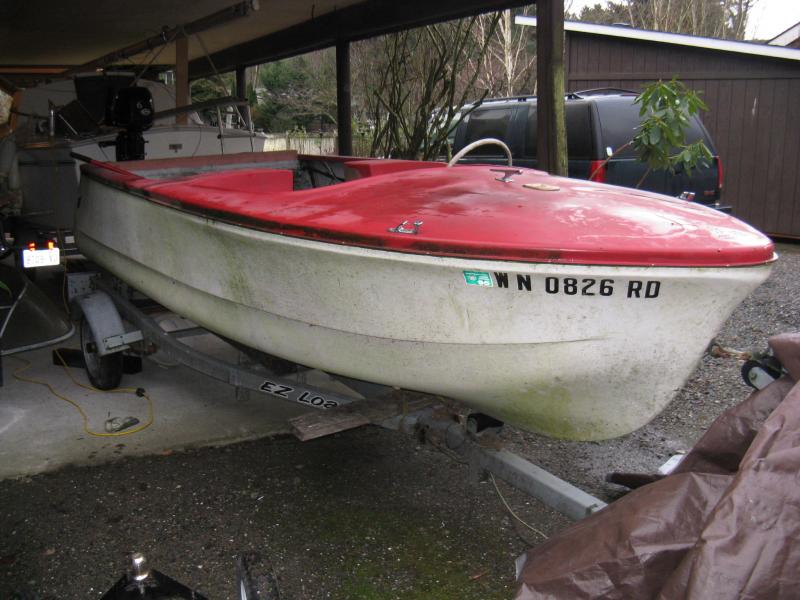

Ok thought I'd start an official thread over here in projects. Went over and grabbed an old P-14 off my father in laws property and dragged it over to my carport last night. Its in pretty sorry shape but I decided it would be the most rewarding to rebuild this particular boat since it is something I kinda tore into years ago and didn't get anywhere, due to the size of the project, and my skills and funds at the time. I love the lines on this little boat.

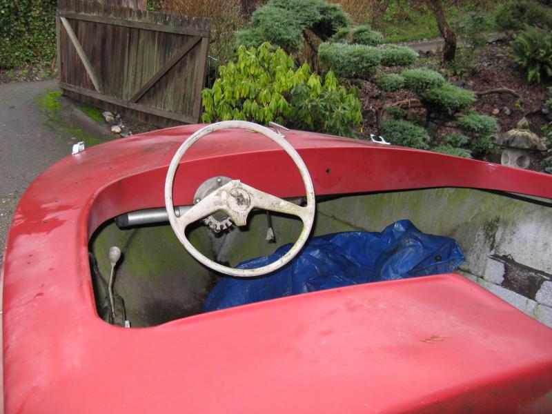

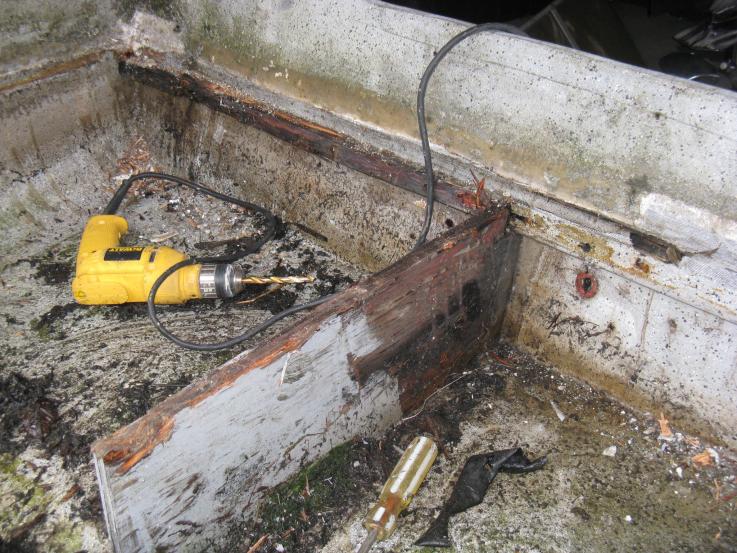

Last night I pulled her old seat boxes out and everything is useable as a template(but stinky!), started getting the old tabbing off that holds the motor well/back seat structure together, and should have that out today and be able to get to the transom. Plan is to do the transom first, then the floor second, rebuild the motor well and then move on to the gelcoat and finishes. I'll try and get some pics up this week. My goal is to have this done by summer which in the Northwest means July
