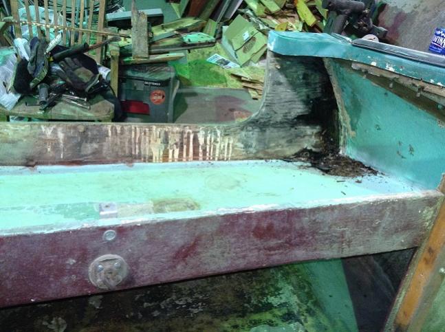

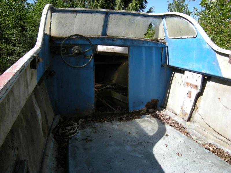

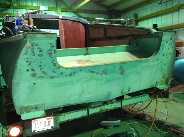

    So what turned into a minor glass repair on the transom turned into transom repair, then splash well removal and transom complete removal, which turned into some odd floor movement, which now has me very concerned about the stringers!!!
    Welcome to classic boat restoration...!!
    The more I dig the deeper I go...

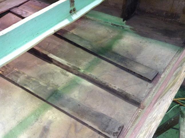

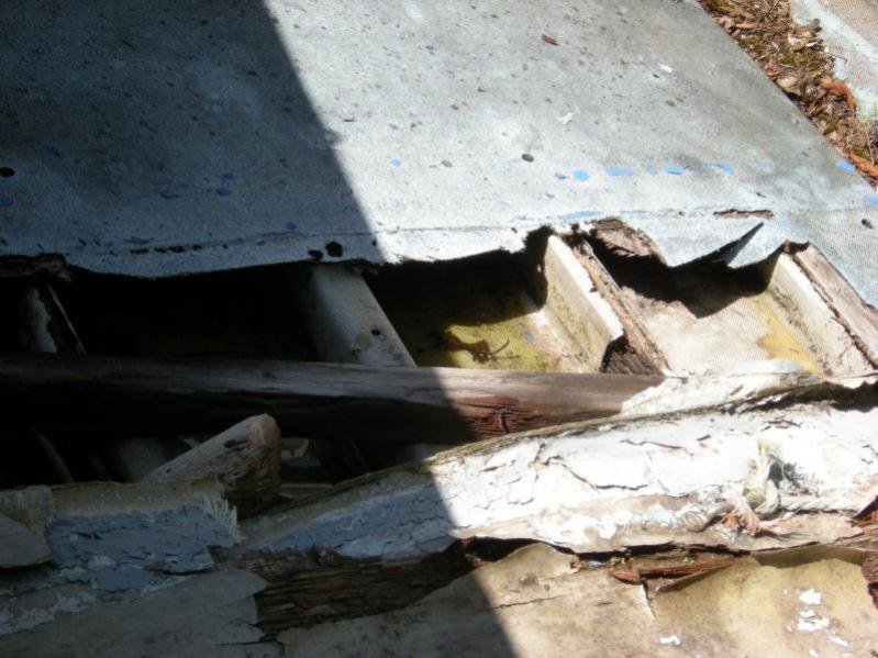

    OK, here's my question...What is a 1957-58 Enduracraft/Dorsett subfloor supposed to look like anyway? I'm pretty sure the stringers are supposed to be attached to the hull but these are NOT!! I can lift the ends of the stringers away from the hull by hand so they are just flapping around, but they don't move left/right so they are anchored farther forward.
    Now I plan on removing the whole floor (4x7 sheet of plywood) but was wondering if any of you have seen this before?? Is this a shoddy previous repair job or is this "factory"??
    So, those are say, 1 x 4 or x6's and they are just laying flat?
    I am no master but have been into a fair amount of down to the guts repair and never have I seen something just laying loose like that.
    The idea was to keep the floor Rigid, no movement.

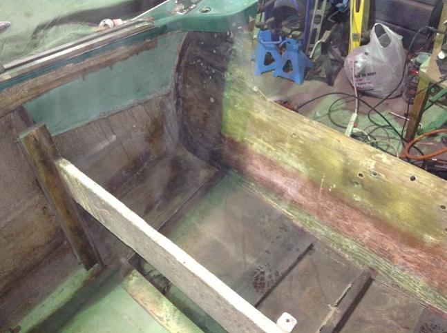

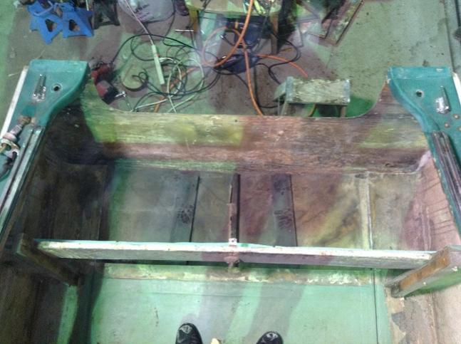

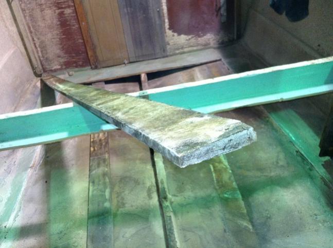

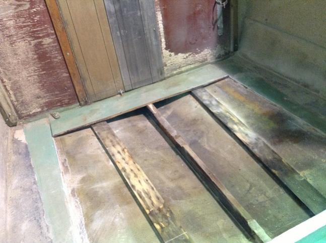

          Removed most of the flooring last night and now I feel that this may be factory built this way.
          The center keel rib is "original" but still seems sound enough to just clean up and re-glass over. I just need to come up with a plan to support the sides of the floor.
          The side stringers are 3-1/2" wide but tapered in thickness 1/2" on the outboard side and 3/4" on the inboard along the whole length to match the hull angle to the flat floor. They had very old chopped strand cemented to the bottom that had long since deteriorated and pulled away from the hull skin.
          My debate now is what to replace them with? If I go a thinner stringer, say 2" then should I add another set? Obviously the space between the hull and the floor is very thin in this boat out towards the sides.
          I could try to reproduce the original design but seal the new boards with resin/cloth and then really mount them to the hull with paenut butter and CSM.
