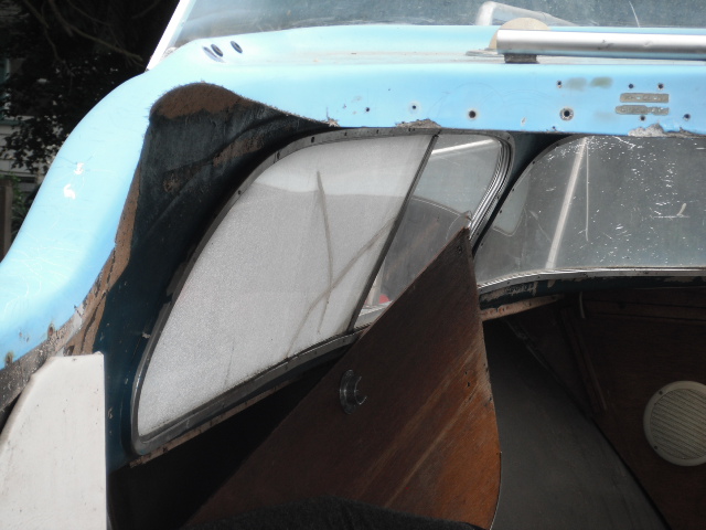

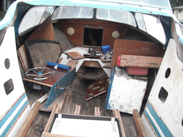

          Yes, thanks for the pipes, please hold on to them for us. Remember how when you start a project (not just boats) there is always these questions in my mind "why in heck to that guy do that for?" Here's a pic of port main bul that is apparently chopped out with a hand saw. My usual question "Why would someone do that?"
          Any ideas? Star bul is also cut out , but not as bad.

            Don't have any idea why a person would have cut that out.
              Do a search for Chelan as Allan and Sue have one on Fox Island. Might have it stored some palace else but you could get allot of important measurements from him.

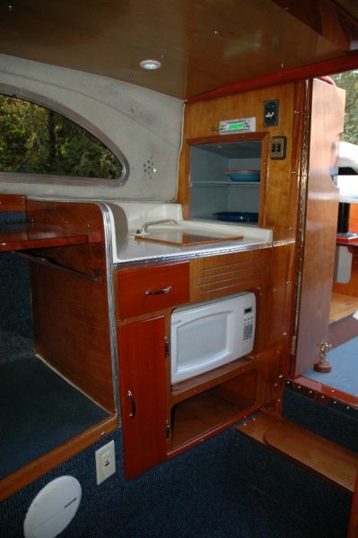

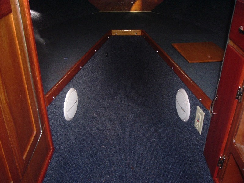

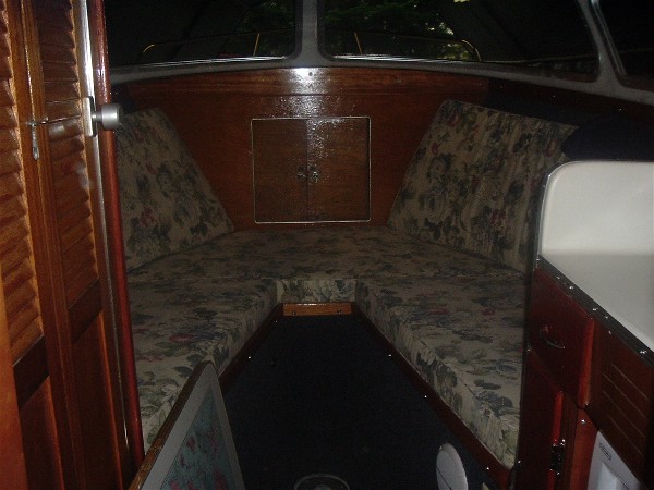

                1958 Dorsett Farallon
                1959 Bellboy Ballerina
                  Cabin

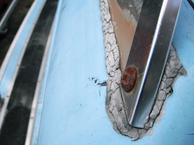

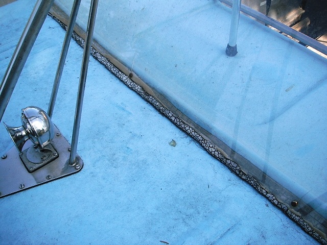

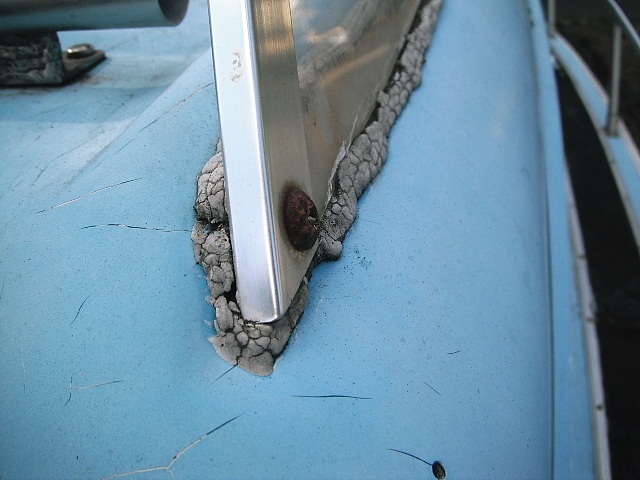

                        Okay, it's time for an update and a question or two. Laurie and I are cruising right along. Since our Farallon has arrived we have been busy taking stock of what we brought home. Lot of Stuff! Finally removed all the "loose" stuff that was in the boat. Still not disappointed, but am trying to come up with some sort of work order with priorities. I am amazed at how many things were held with "Nails". Wooden parts appeared rusty. No, wood doesn't rust, but if you put enough nails and no stainless fasteners, things break down pretty fast. Will be cleaning and just getting familiar for a little while. Besides, it's fun just sitting there and looking.
                        On to a question: Have included a few pictures of the WS. It appears that someone just bought 45 tubes of Boat "Life Caulk" and used that for a quick fix. Is this the way Farallon windshields were installed?
                        I have been looking around, but what did you guys do on your rebuilds? Some pics would be greatly appreciated if you have any around. Will be removing WS and cleaning all the caulk off this next week.

                          At Island Boat Shop, we never had to replace the windshield on them. Allans didn't need re-setting. Chucks was done by a glass shop I think?
                          Not sure but I have it in my head it was Buytl tape was used.
