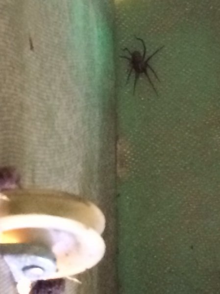

          Nothing stops de-construction faster than having one of these pop out by your hand.
          [ATTACH]16670[/ATTACH]
          He is dead or dying right now... That is a 2" pulley
