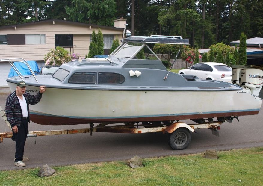

    That is the plan - a real quazi-bulkhead (I read that a real bulkhead can not have an opening in it over a certain size to qualify) with door(s) at the end of the new cabin. Keep the heat in and the water and noise out. Your sliding, tempered glass would be nice, but as you mentioned previously, glass is heavy. The front/side windows in the cuddy are all plastic and I plan to use the same for the cabin side and bulkhead windows, with safety glass in the front because of the wipers. We will still have canvas cover/curtains back to the stern probably, but having owned a convertible automobile, I don't trust canvas to keep the weather out, particularly on open water.

              My 59 Skagit seems to be a little heavy in the butt as she has a cast iron Volvo B18 and one of the first Heavy Volvo Penta outdrives on it.

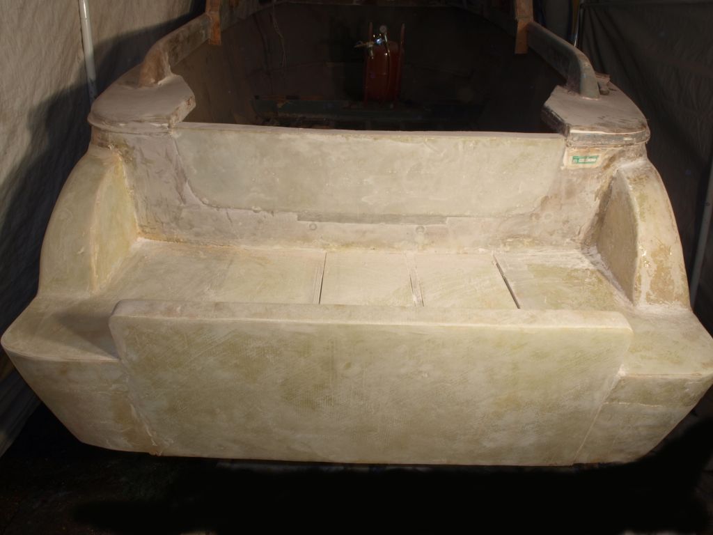

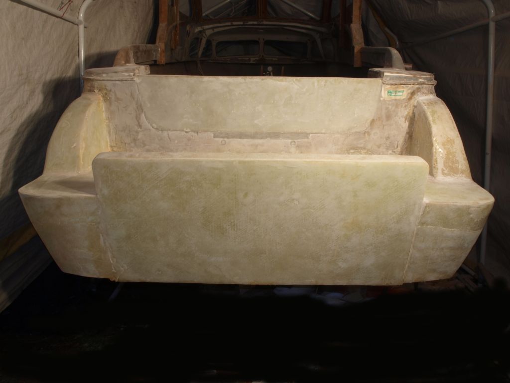

                          Here's the starboard side "arch thing" almost done. I don't think I'll ever get tired of this extension. You guys? Ha, ha. Soon, the final skinning of the rear end top/sides.

                              You may have posted this already, but how much weight do you think you've added to the transom? It's looking really good and like Helmar I'm looking forward to sea trial pics or video...
                              • #90
                                150-160lbs, which floats itself in 3" of water.
