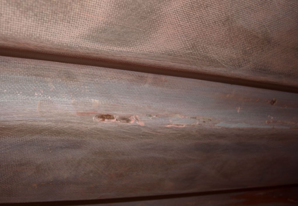

Thanks guys. The anti-fouling paint has already been scraped off, so the white/red stuff sands off without too much trouble. I worked at the Edmonds Yacht Club (Madison Marine) out of high school, scraping/sanding/painting boats, so I know about the patience. Never ran accross any Skagits during that time though. I'm thinking similarly to Helmar on this one - fasten a form block to the sander.

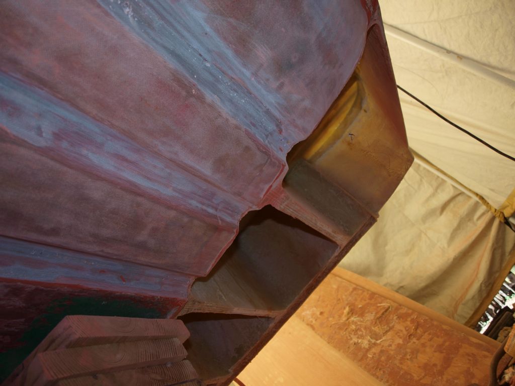

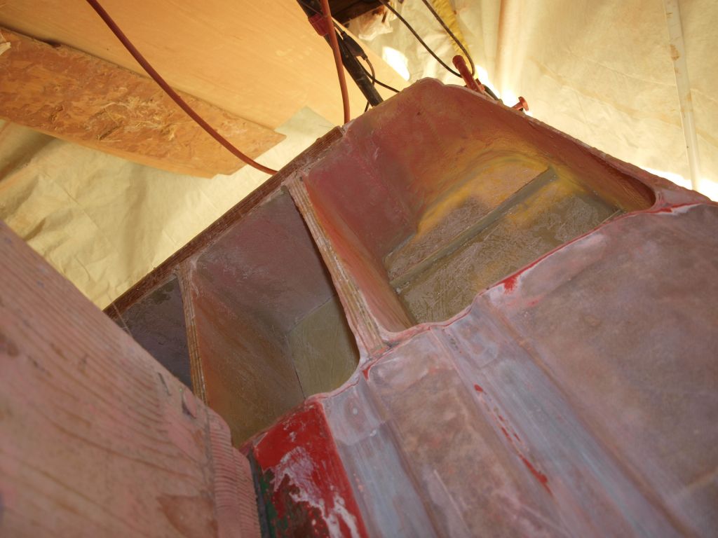

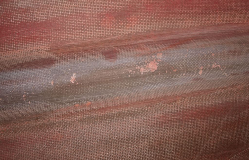

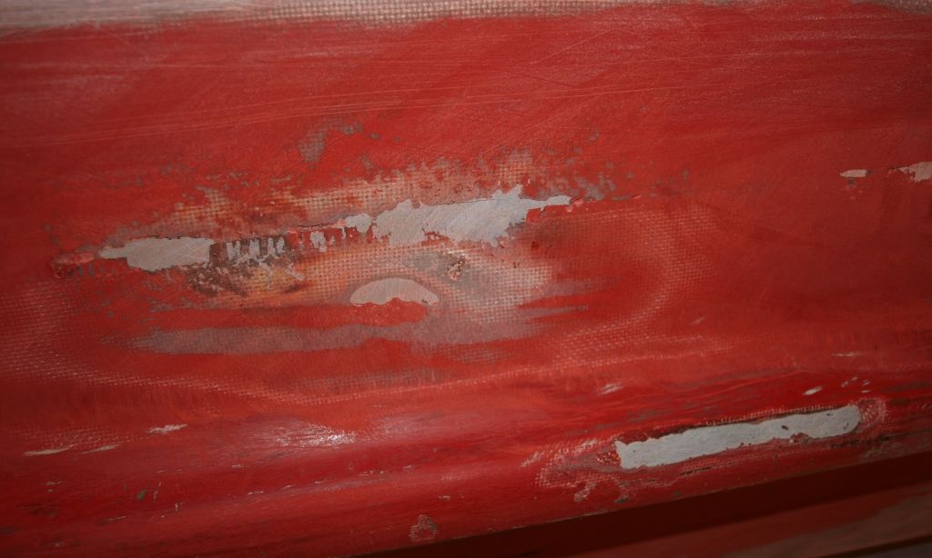

I'm about 3/4 way finished with the first sanding of the hull bottom. As it turned out, hand sanding with 40 grit over a block of industrial felt has been the best way for me to sand the air-o-glide grooves. There are quite a few surface flaws in them that need patching up/sanding.....and some scrape/gash repairs that need redoing.......and, oh, you'll notice there is no bottom hull surface on the newly added transom extension, as yet. I plan to make a hull mold, the same way I molded the extension sides (see earlier posting), gluing thin plastic sheeting over select hull sections, laminating over that thick enough to be stable, pulling the sections off and fitting them together as needed.

Originally posted by Skagit Hideaway View PostI'm about 3/4 way finished with the first sanding of the hull bottom. As it turned out, hand sanding with 40 grit over a block of industrial felt has been the best way for me to sand the air-o-glide grooves. There are quite a few surface flaws in them that need patching up/sanding.....and some scrape/gash repairs that need redoing.......and, oh, you'll notice there is no bottom hull surface on the newly added transom extension, as yet. I plan to make a hull mold, the same way I molded the extension sides (see earlier posting), gluing thin plastic sheeting over select hull sections, laminating over that thick enough to be stable, pulling the sections off and fitting them together as needed.
Notice the sanding supervisor hard at work in the background.
Your at the most hardest part of the job right now. Getting sanded down and prepped for paint.
Boy, she is sure going to look nice for sure !!!!
Great job by the way..Helmar Joe Johanesen

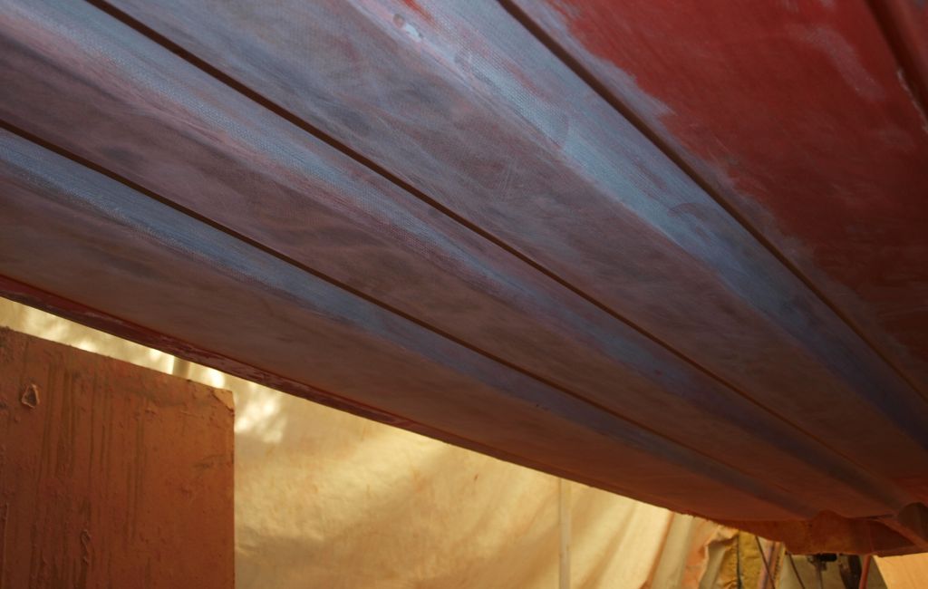

....progress.....almost finished sanding.
This Skagit had impact damage, port side, in the area of the 3 mile head poop hole. Multiple cracks, 6 inches long, and the respective stringer broken in two. Must have hit a log or deadhead. I plan on increasing the foamed area in the cuddy cabin, perhaps angling the deck up the side of the hull, under the bunks/sink/cabinet.
Looking good!
