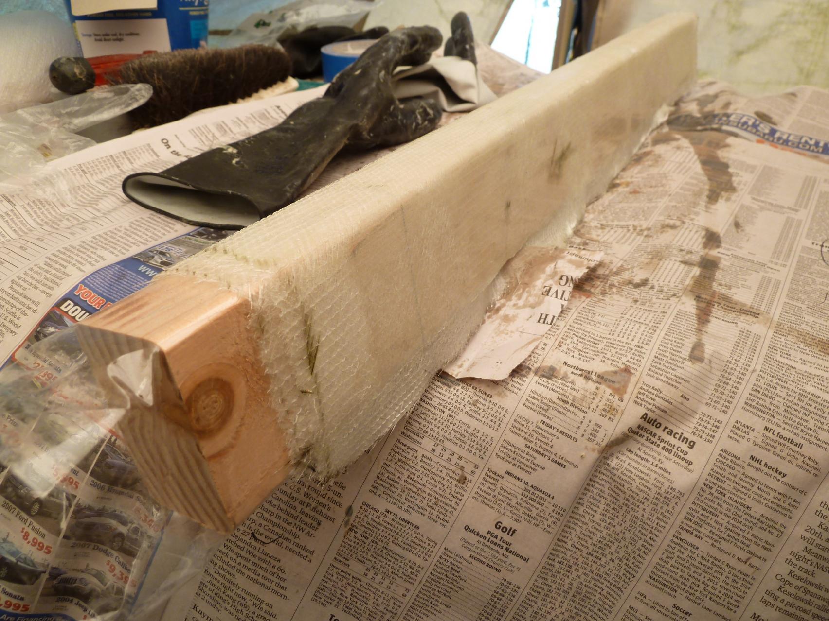

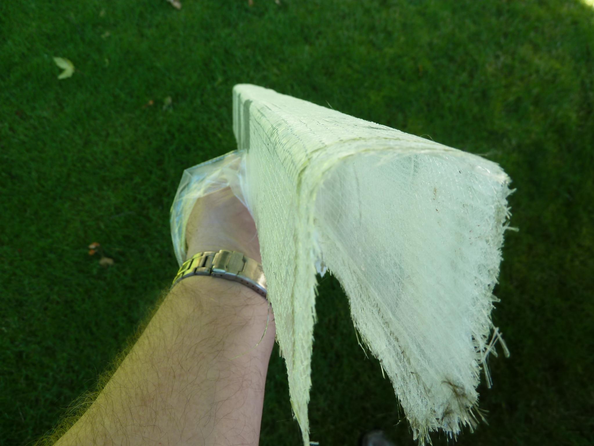

                              Attached is a short support tube I made for transom project that shows the idea for stringer, you'd just make that longer for the distance, fore-aft.
