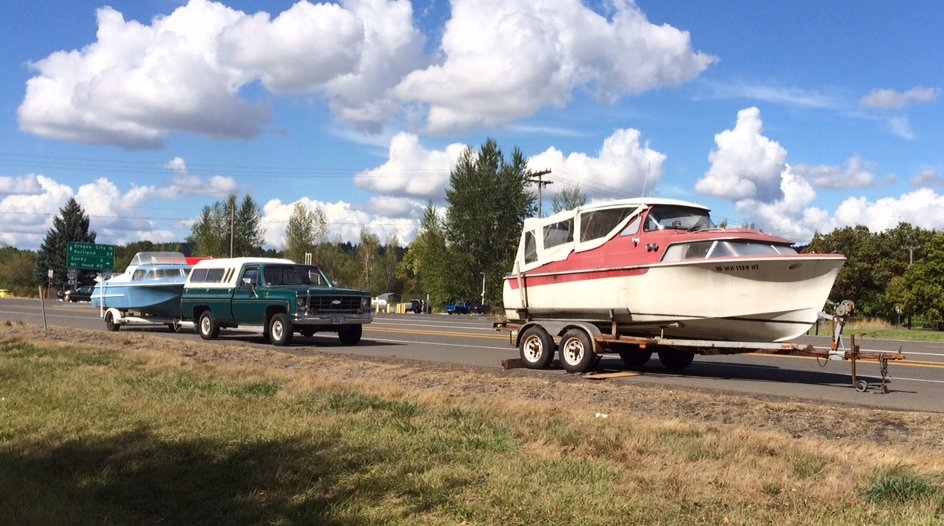

    As you can see my 20 is just setting along side the road and broke down. The saltwater got into the bearings and destroyed All of them. I also had so much saltwater rust that it destroyed the brakes as well.
    Right were its parked in the picture, my Son had to go back to the farm were they were parked and retrieve the floor jack.. I also seen that the walking beams between the axle springs were also rusted Solid so there will be a fair amount of work on the trailer to get her back in shape. It used to have a extendable tongue on it were I could use the little Motorhome to back her into the water. That is now fused by the saltwater rust.
    So, back up to Sandy and now working on getting the Super heavy duty bearings replaced. Those axles are Way over rated for the boat.....

      Yep, 211 and 224 I think. It was smoking as Joejr was going down the hill and he pulled right over as he could see it in the mirrors he said.
      There were even big gaping holes in the backing plates. Once I pulled that one wheel off, I told Joejr, we are done and have to go back as they are all going to be like this.
      Lots of work on this trailer to get her back in shape and I will also lower the boat in the frame as she will fit between the fenders after lowing her down.
      That will make it easy to launch as to float her now, the fenders have to be under water.
