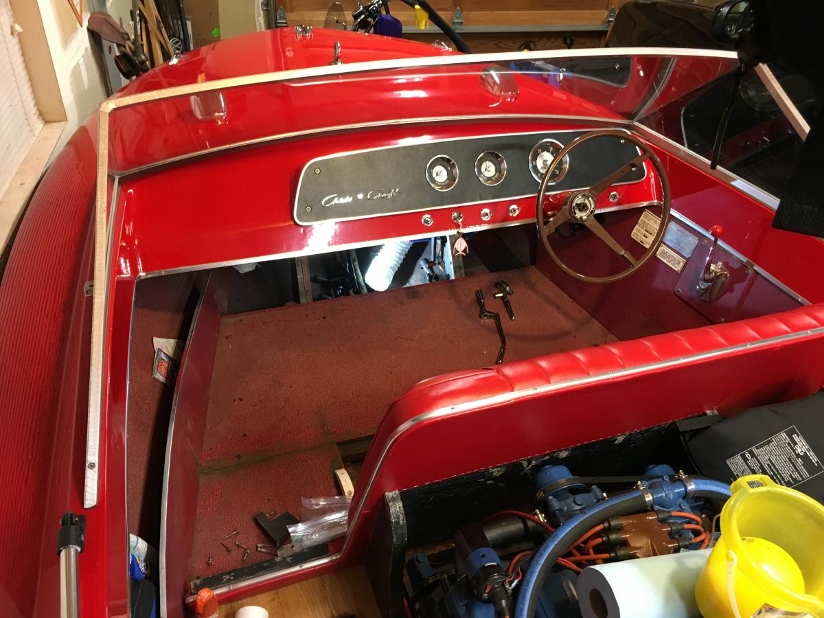

On the 404 I did the same thing to the windshield frame. Except I started with 100 and sanded all the way to 600 I think. Beyond that you can go all the way to 2000, but it is a lot of work for something that will take abuse. 600 gives that nice brushed look. To get your swirls out between 240 and 600, you'll need to use 320 and 400.

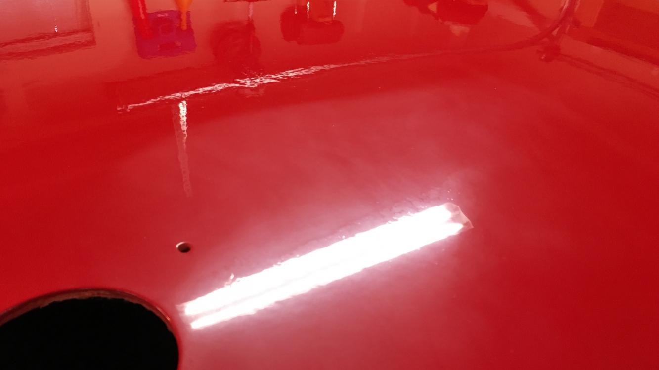

Bummer about the hazing! With all the coats you have on, you should be able to sand it out though. Whether you get it done in time for the weekend is another story…
If I lived closer I'd lend a hand, sanding paint is one of those things that just take forever… One thing is for sure, it will be an awesome paint job when you are all finished.
