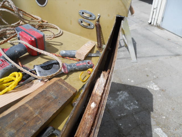

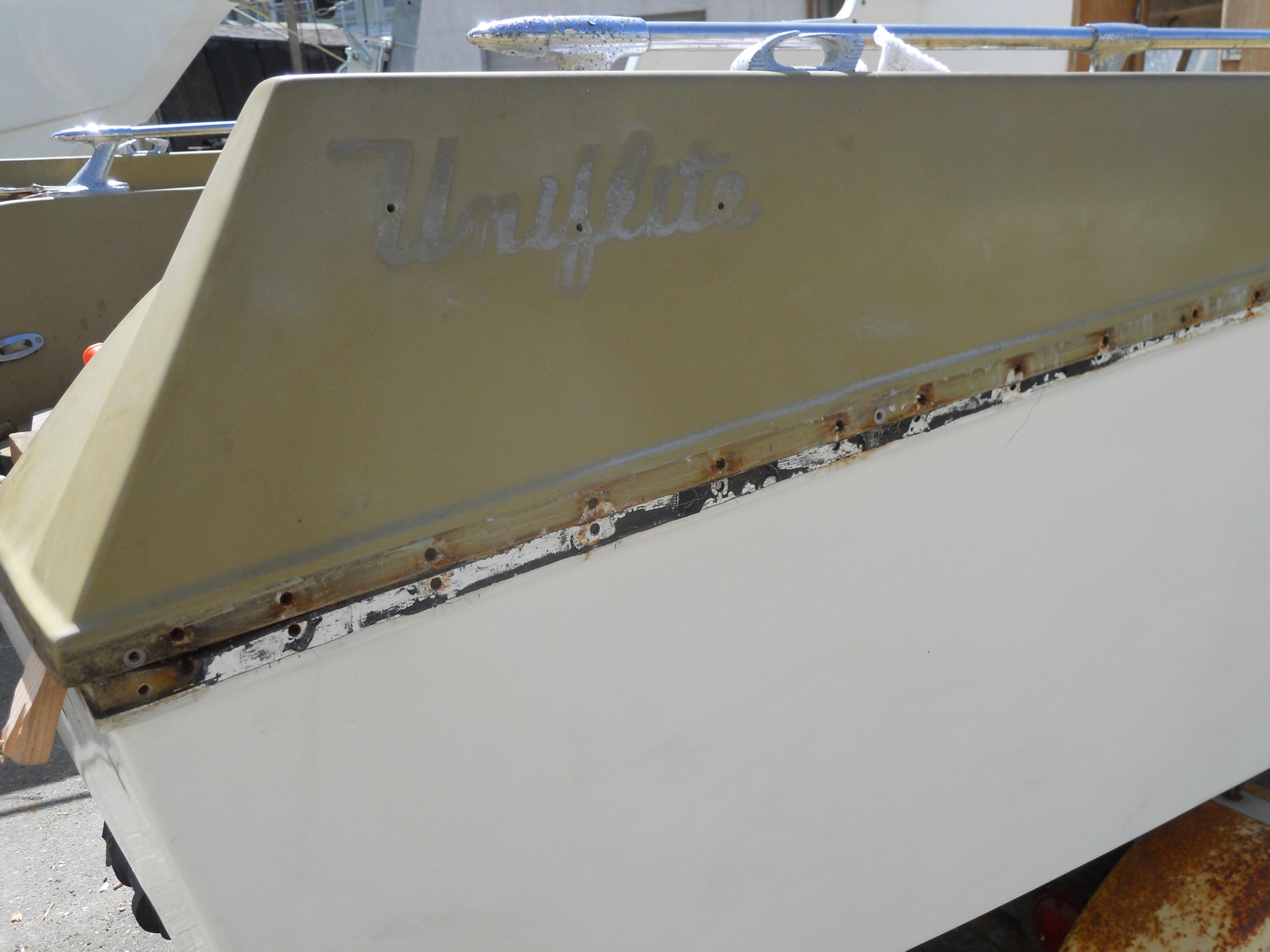

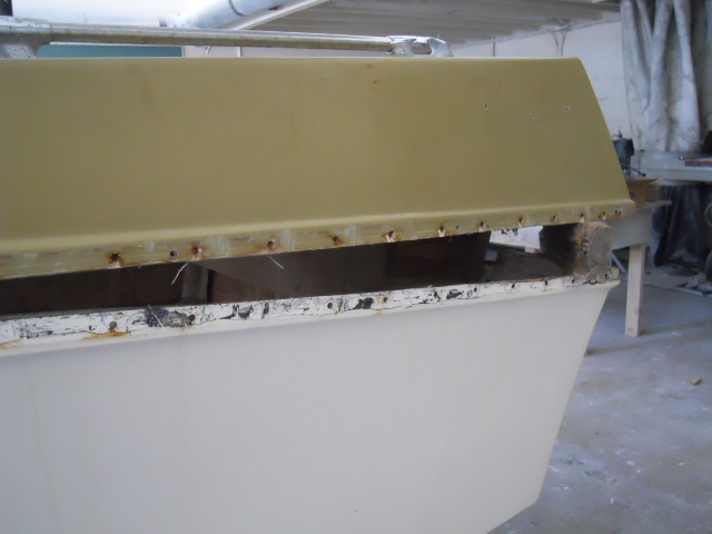

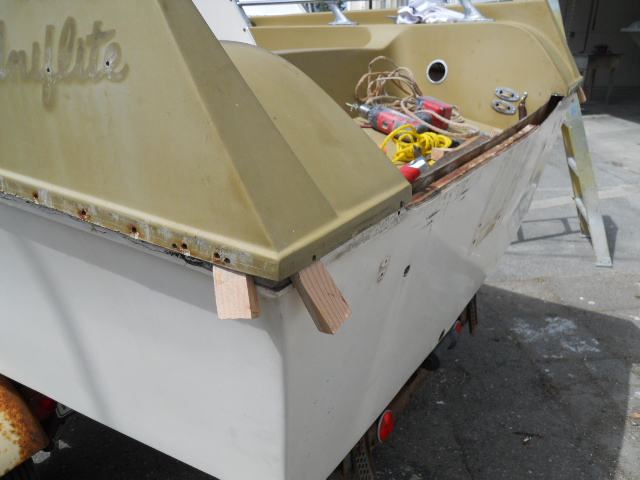

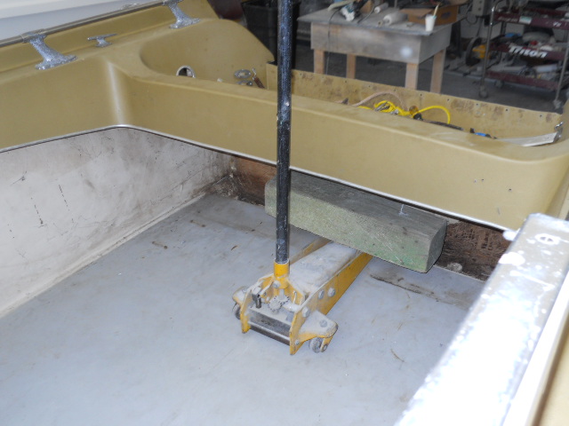

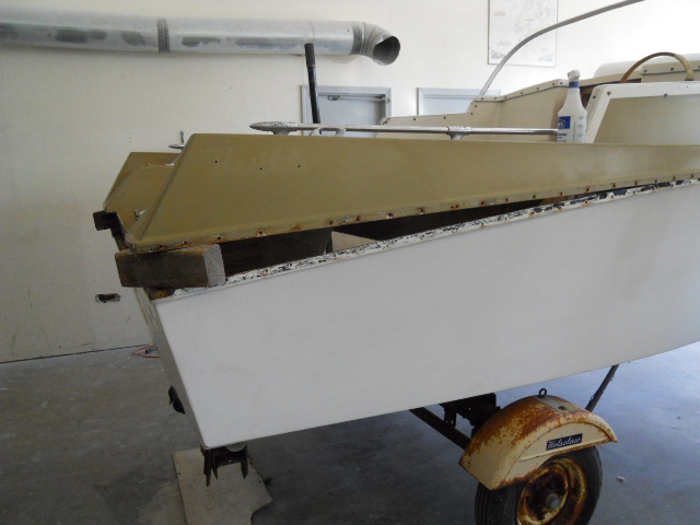

greetings just geting started removeing rotten wood and the rub rail jacking up rear half of spalash well to install new cossa board 1.5 in transom board stringers are ok going to reseal with 3m 5200 sent the 2 uniflite badges to the plating shop in ohio going with what i got cheek out my pictures
