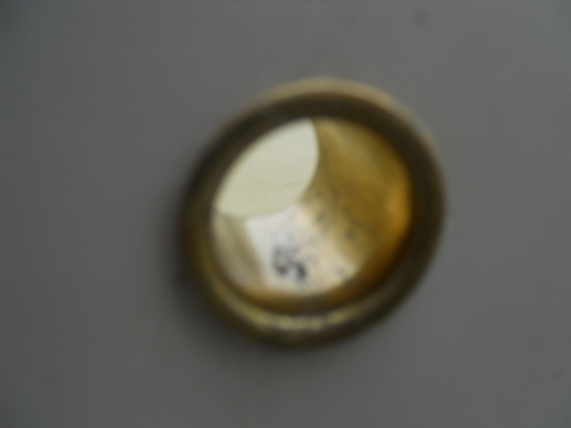

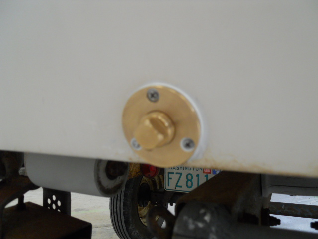

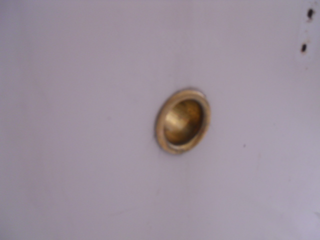

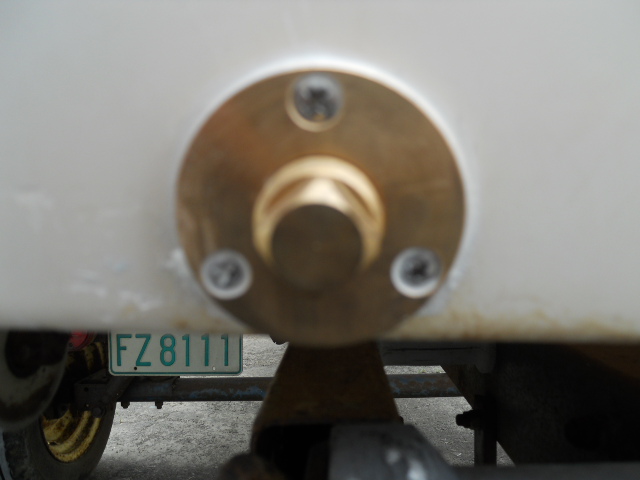

          new type drain hole plug
          greetings u can get the new style drain plugs that new boat company use today also installed the splash well tunnel drain made of brass at fisheries supply co ( under drain plug) SEE PICTURES

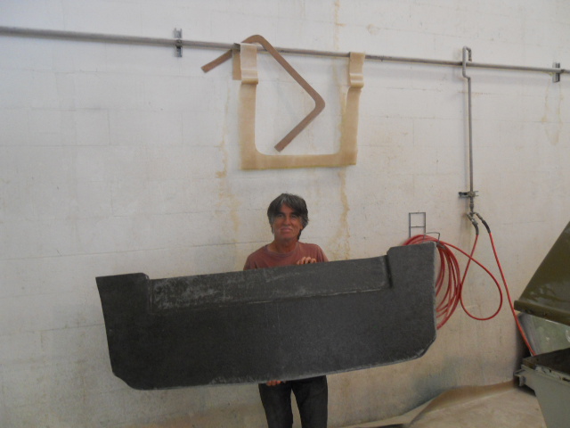

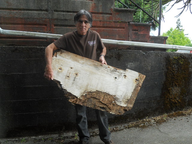

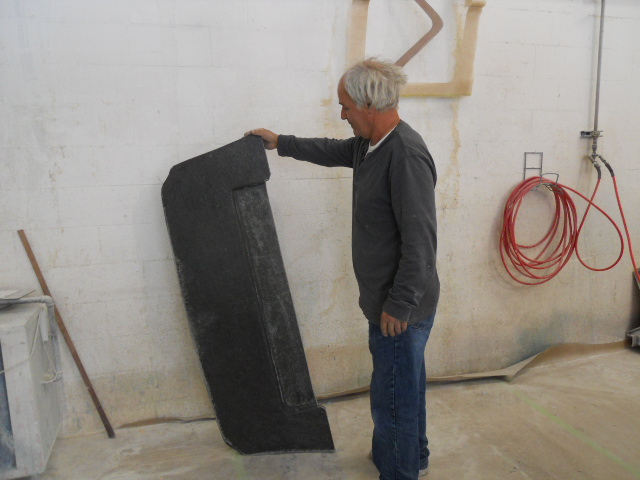

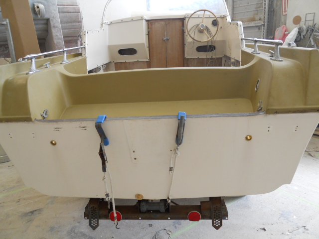

            The transom redo
            THE PICTURE OF THE GUY IS JOHN HOLDING THE NEW TRANSOM MADE OF COSSA BOARD HE IS THE TRUE BRAINS OF THE PROJECT AND THE TWO MEN TOGETHER ARE THE GLASS MEN that SHOWed ME HOW THINGS ARE DONE and did the bulk of the work,,,,,,,,,and the other guy is me holding the old & new transoms>>>>>>.YES IAM A MEMBER OF THE MORE MONEY THAN BRAINS CLUB<<<<,so now we are on to the 1959 SKAGIT 20 I O.......it needs complete floors/paint new engine & outdrive and some real TLC,,,,,,,,,,,,thats it for now,,,,mike pingatore
            • #36
              Originally posted by mike pingatore View Post
              THE PICTURE OF THE GUY IS JOHN HOLDING THE NEW TRANSOM MADE OF COSSA BOARD HE IS THE TRUE BRAINS OF THE PROJECT AND THE TWO MEN TOGETHER ARE THE GLASS MEN that HOW SHOWed ME HOW THINGS ARE DONE and did the bulk of the work,,,,,,,,,and the other guy is me holding the old & new transoms.,so now we are on to the 1959 SKAGIT 20 I O.......it needs complete floors/paint new engine & outdrive and some real TLC,,,,,,,,,,,,thats it for now,,,,mike pingatore
              That is way cool. Glad to see you got help as it can be tricky. Mix the pot wrong and it kicks before you get to the boat.
              I still use the Fiberlay P?? 16 I think, that is a laminating resin. I also add the surface seal to it.

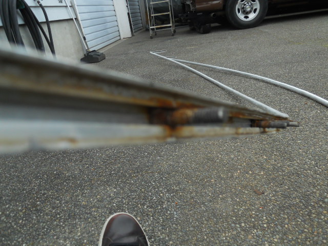

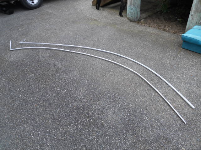

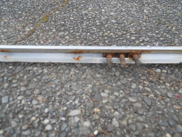

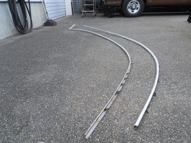

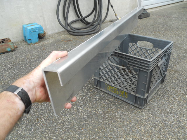

                Uniflite aluminum rubrail

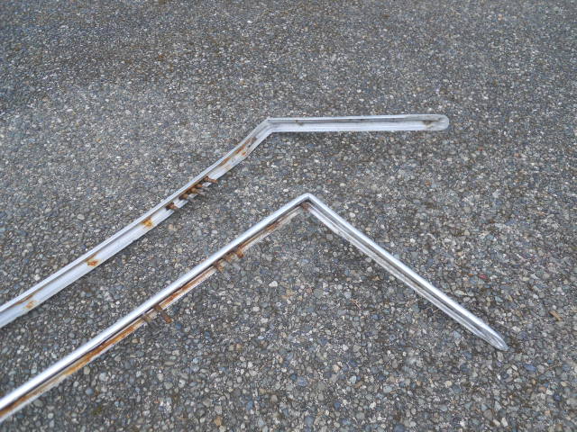

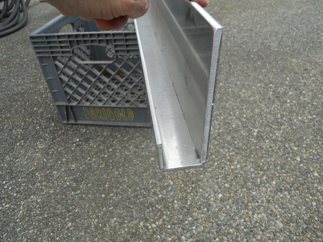

                WOW NOW COMES THE JOB OF STRATEING OUT A MESS ON MY RUBRAIL,,,,,,iam going to take a couple 2x4 10ft long and put them together end to end then rouder out a 1/2 round ress down the center to lay the aluminun rub rail and start clampit at one end then tap it in to the ress to get it strate,,,,i found new T BOLTS ON LINE 1/4 20 1.5in long ,then when i install it ill use 3m 5200 sealer ,,,,start at the bow & work my way to the aft,,,,,,,what u guys thoughts ( see pictures)

                      From working with my aluminum trim this winter, I would suggest NOT straightening it out unless it needs to be straight to fit the boat! Aluminum is not like steel, it will only bend so much before it will crack then you'll be sourcing new material! If you cannot get the bolts in/out due to a bend, you can carefully drill a hole in the channel big enough to rock the "T" head out of/in to the channel. This is how the bottom of my windshield frame was done, there is an access hole in the middle of each piece since they didn't maintain the channel thru the corners or at the tips.
                      Also, if the aluminum is corroded badly you might just want to source new rubrail anyway... Restoring the original can be a lot of work and money if you have it reanodized...

                        17ft uniflite transom CAP

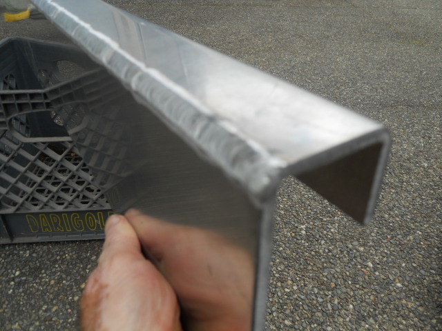

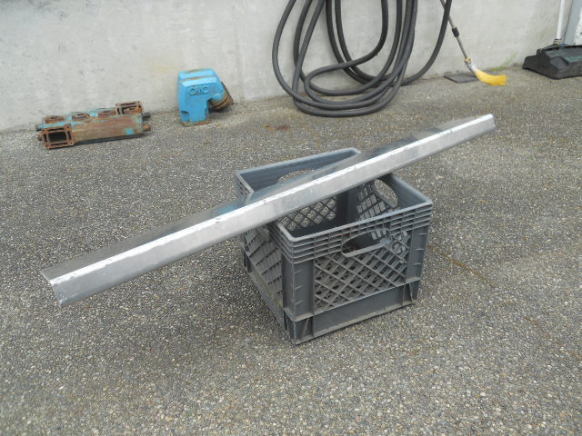

                        just finished my transom cover cap made of 1/4 in staimless 5x 45in long and 1.78in wide and the return i.5 in iam not to good at welding but i get it done,,,,,, L O L ,,,,, i hopeing this helps when i clamp on my 1969 merc 80hp.... ( SEE PICTURES}
                        • #42
                          That turned out pretty sweet. Nice job Mike.
