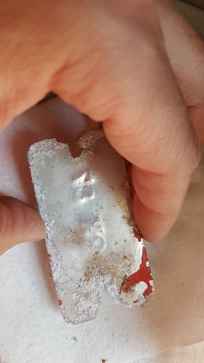

    Bruce I'd like the info on the guy that remakes the Skagit ID plates. This is all I found on mine:
    I know it's not original, but I wonder what it was put there for?

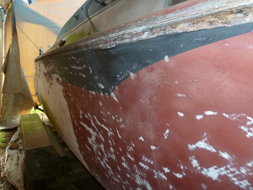

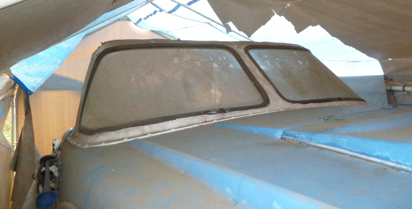

      Oh and I also noticed the original gelcoat colors on this boat are the opposite of Bruce's colors...see pics.

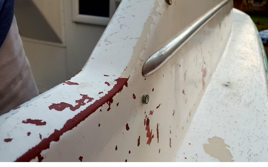

      Window frames are dark and the cabin is the light color. Kinda cool if I could strip all of this paint and find some good gelcoat! Any ideas to strip the paint without harming the gelcoat?

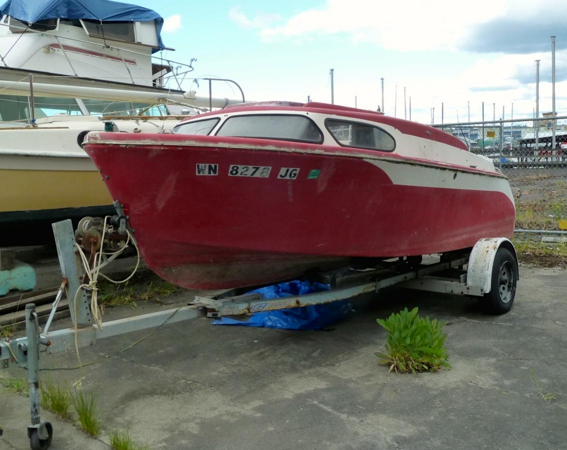

        Going to guess the plate you found may not have to do with a Skagit build plate, never seen one like that before. As for the color combo under the surface on your boat, have found other "mystery boats" with similar paint/gelcoat. There's this one 20 express we found near La Conner with a red/burgundy under white on the hull,(almost looks like a primer) with white gunwales and light blue cabin top. Inside, has an identical scheme as my cabin with gray paint and burgundy gel coated trim panel wrapping below windows. Clint Strobel has a 20 express that looks like the factory painted over the original colors with gel coat. Over time, owners change colors on these for numerous reasons, saw a friend's boat's colors, wanted to match a towing vehicle, or perhaps some other reason..
        Then I'm attaching this cool 57 17 express from Tacoma that is a color scheme (original gelcoat) similar to what you've found on yours- gives you a nice idea of what it might look like, I like it.....first two pics- same boat ! Last pic- Tacoma boat
        Finally, only way I might do that removal is very careful sanding to remove outer layer, very time consuming, boring work ! then more time consuming use of graduated paper to polish it up to final gloss. Using Brian's process, super great write up, there.
          Tim Jones AKA McSkagit, had found a product that would remove the paint but not the gel coat but I forget what it was called. I know he used it on his Skagit Tender (Dingy) that he found.
          I even used it and remember it was pretty skookum, not toxic like some of the stuff that would burn the hair out of your nose.

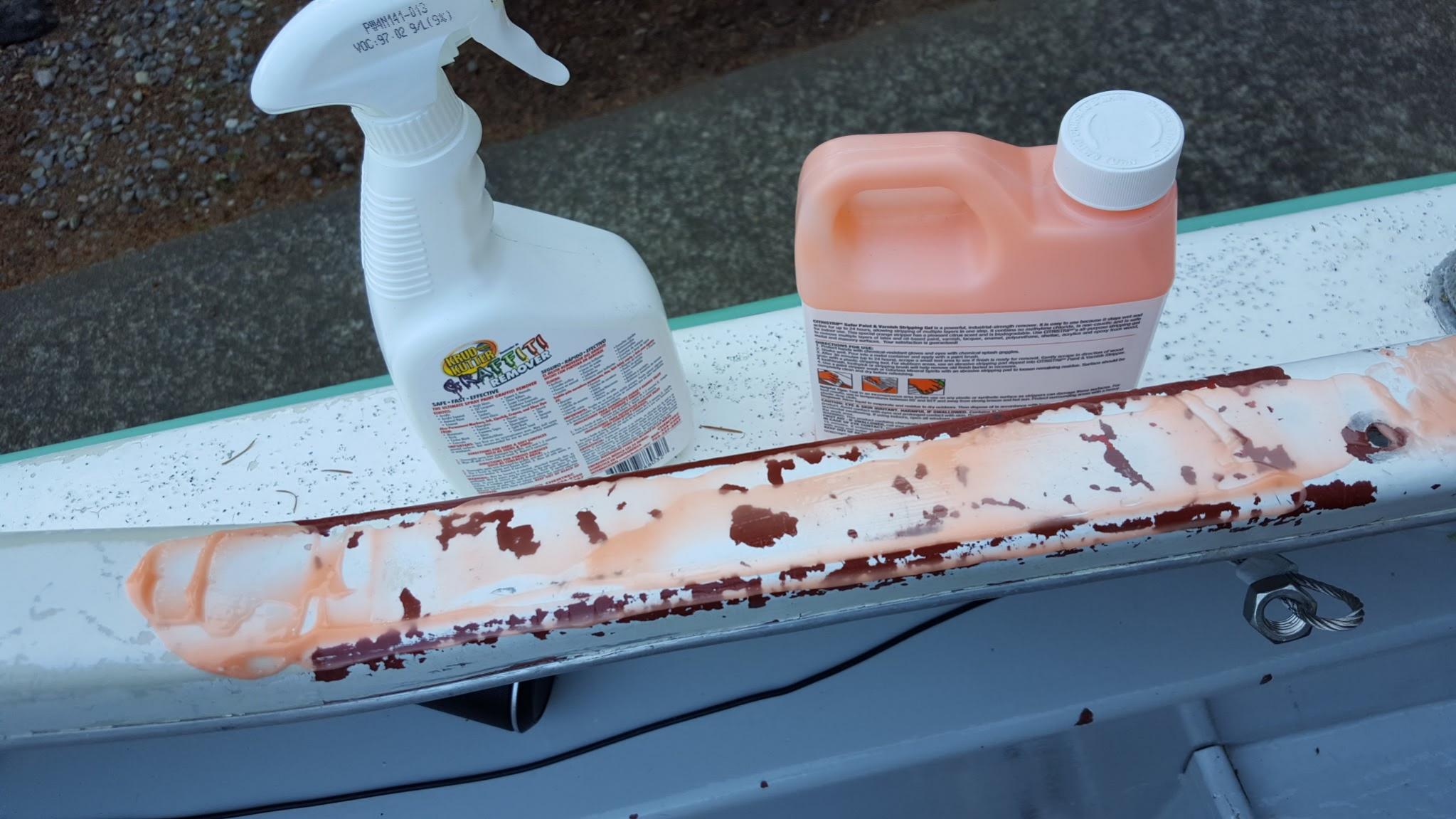

            Here's the stuff I used on the Seafair. Works okay. Just not a fun job removing old paint no matter how you do it.
            http://www.citristrip.com/

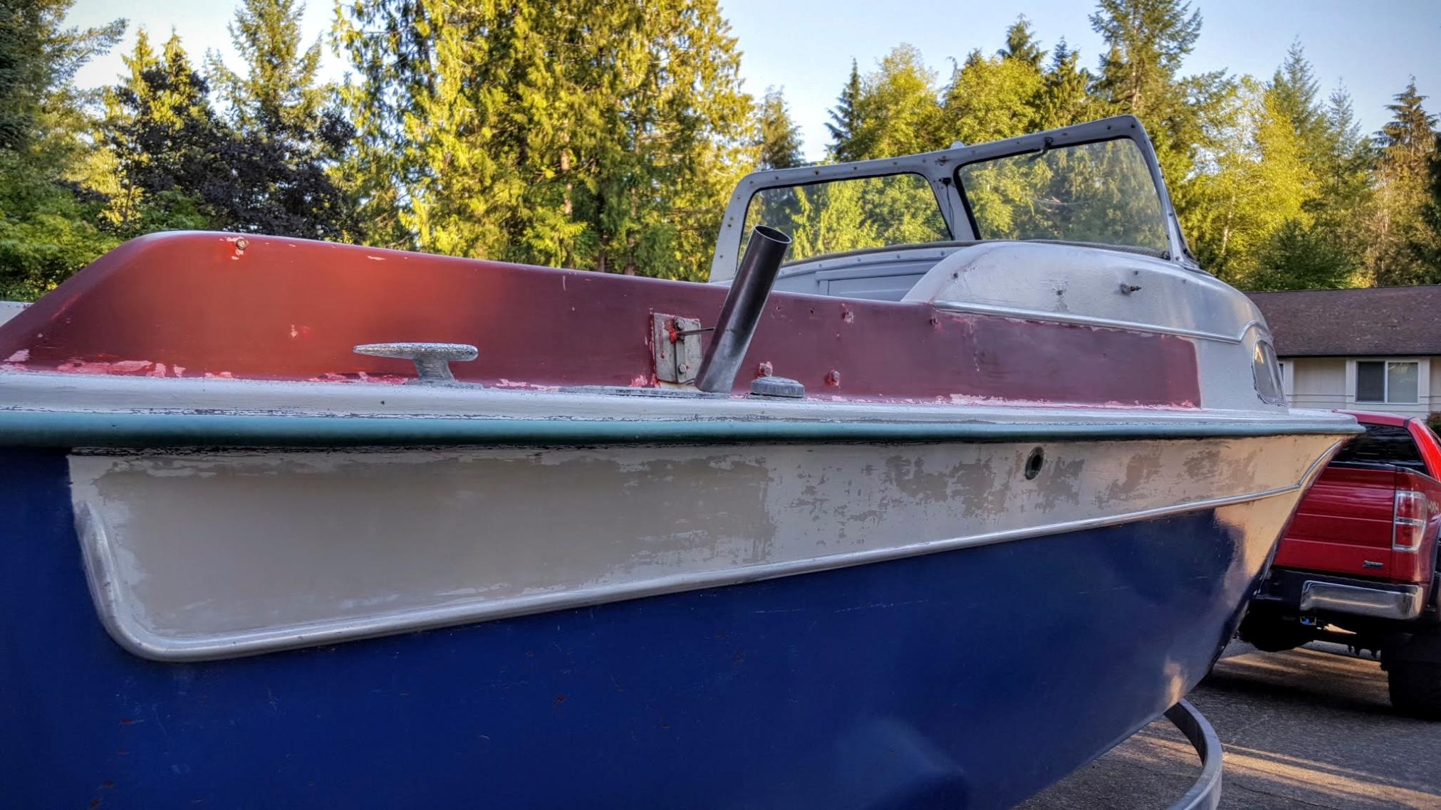

                      It's definitely gel coat and more maroon than red. I've looked at the bottom of the hull and it's showing several signs of maroon as well.
                      Hope to strip it down soon.

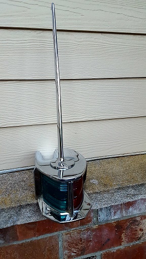

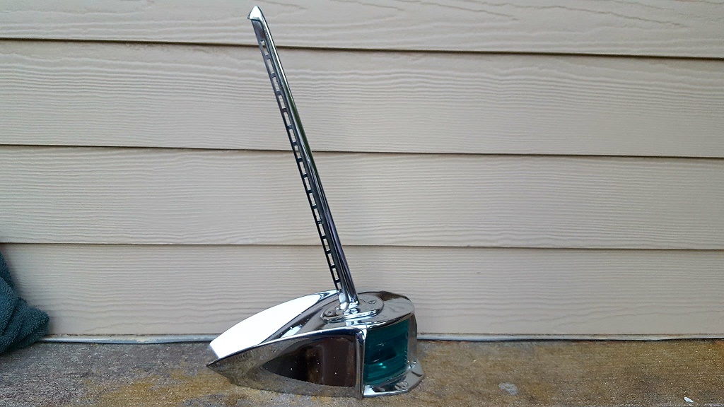

                        While on a mini vacation I "just happened" to find this little fresh water only gem and picked it up for a song and dance. I'll admit though, I can't sing or dance but I got a great deal on it!
                        Might have to see how it looks on the Skagit.

                          Cool, burgundy....the factory did a lot of experimenting, and if it's burgundy, I might be able to guess why it was ultimately changed. The gelcoat material of certain colors does oxidize. My burgundy is only decent looking for two days before it's noticeably faded, and that's using a marine quality carnaba wax.
                          Maybe Brian or John have experience with gelcoat covered by a clear gloss polyurethane with beefed up UV protection ? Does that work ? Otherwise time and effort would be saved by covering gelcoat with burgundy marine paint.
                          Ohhh, yeah, that's a real nice bow light and flag staff !!!

                              The man standing next to the boat is Cole Cummings, sales manager for Skagit. His son Cole jr still lives in Anacortes. Checked your earlier pics of the boat, built-in fuel tanks like this boat in pic. Express model same as yours. The gunwale is the darker color like yours, all the areas match with the scheme of your boat. Then consider the shade of the gelcoat in the b&w picture- lighter than black. Could be red or burgundy. Some might see a deep shade of blue. BINGO -My guess is you might just have that boat !!! Neat that you've connected that all up ! The pressure is on- make it like it came from the factory, Kelly....

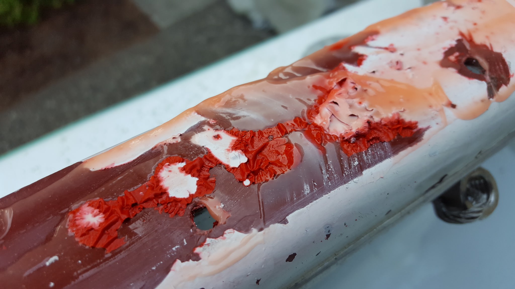

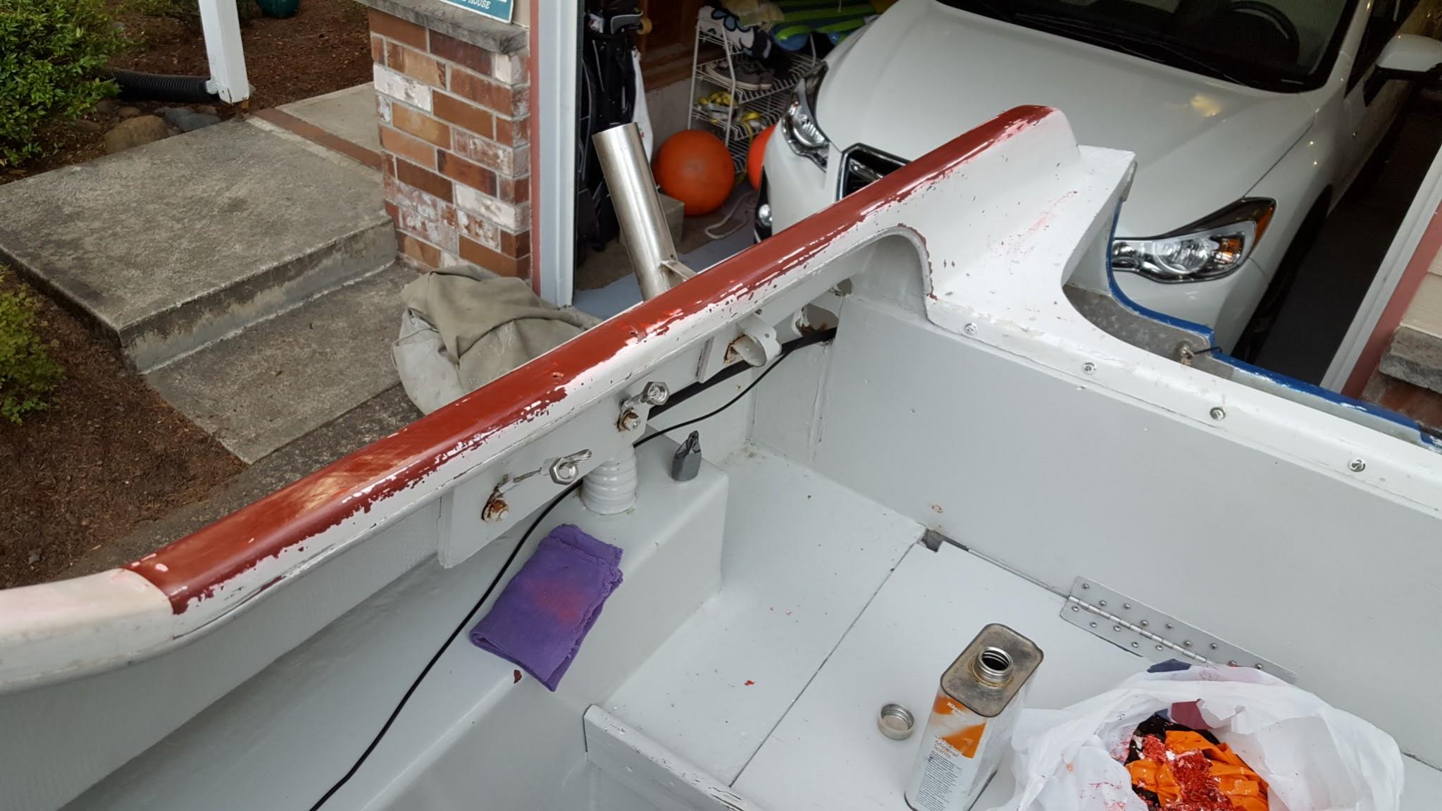

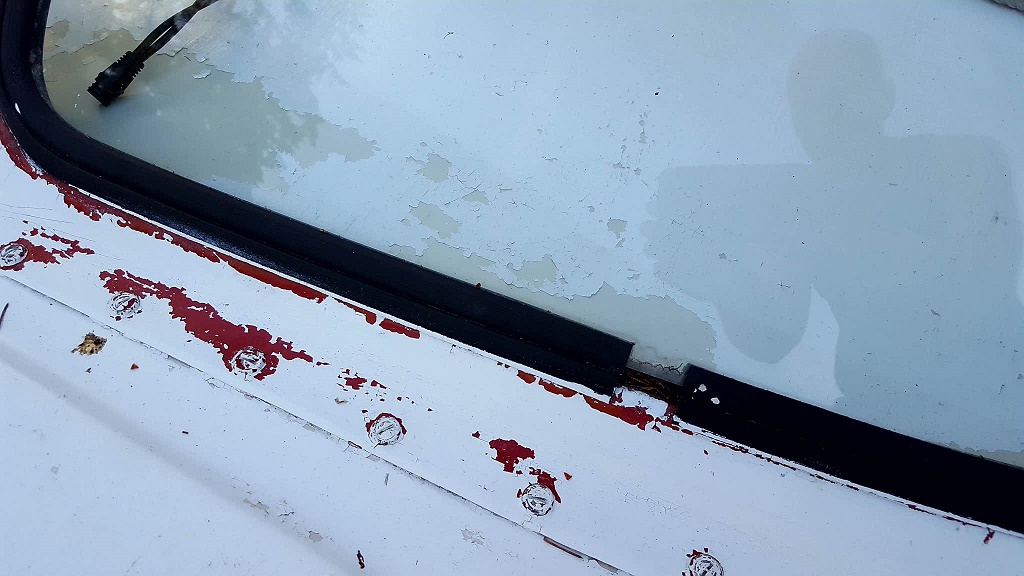

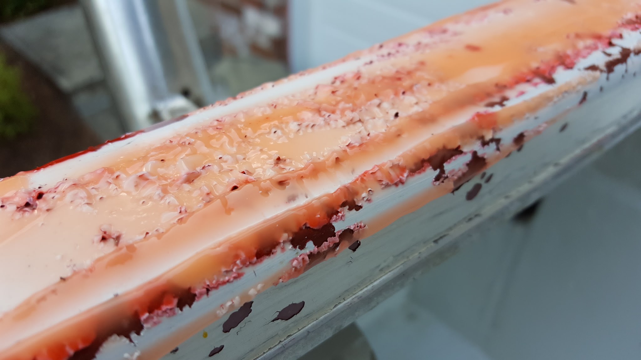

                                So, challenge accepted...for now. Yesterday I gave it a go with the Citristip and started on the easy part aka the part that didn't look like too much effort to remove while standing comfortably. After experimenting with how long to leave the stuff on, I've realized it's like making a pancake. When the "bubbles" appear on the surface, it's ready to remove. On this particular paint, that is a minimum of 1 hour and that's removing two coats of paint that were painted on 20 years apart. As of now, I'm happy with what I'm seeing but realize this will be a lengthy journey to bring this boat back to 90% factory original. We'll see how long my patience last...
