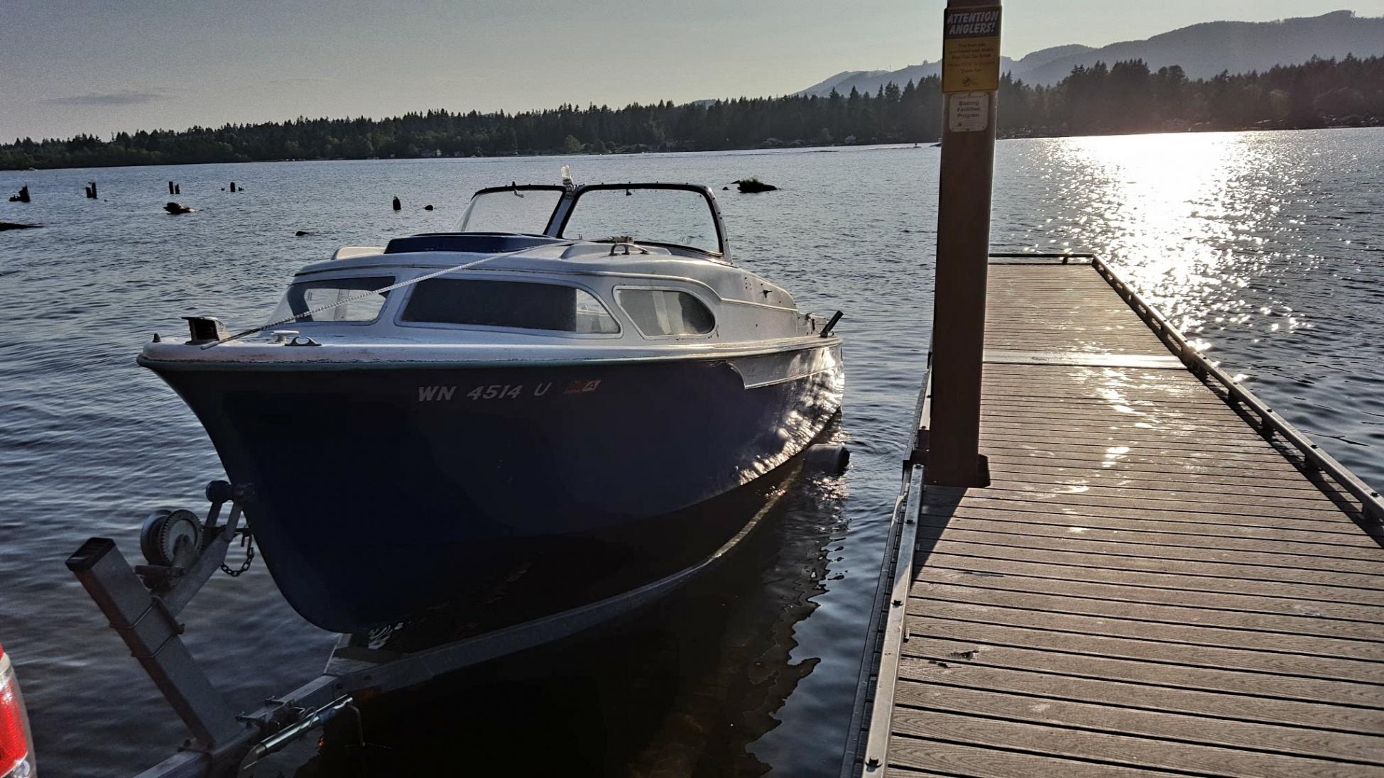

    Here's a small glory shot while soaking in some sun and water...

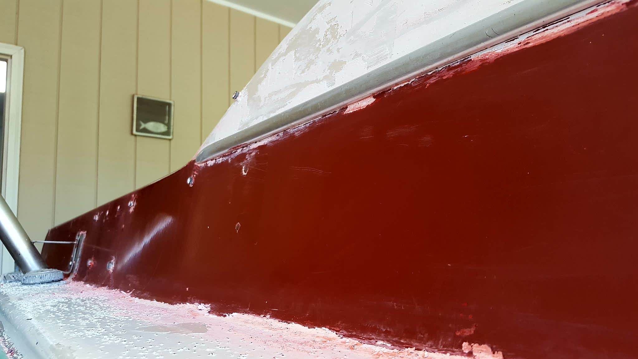

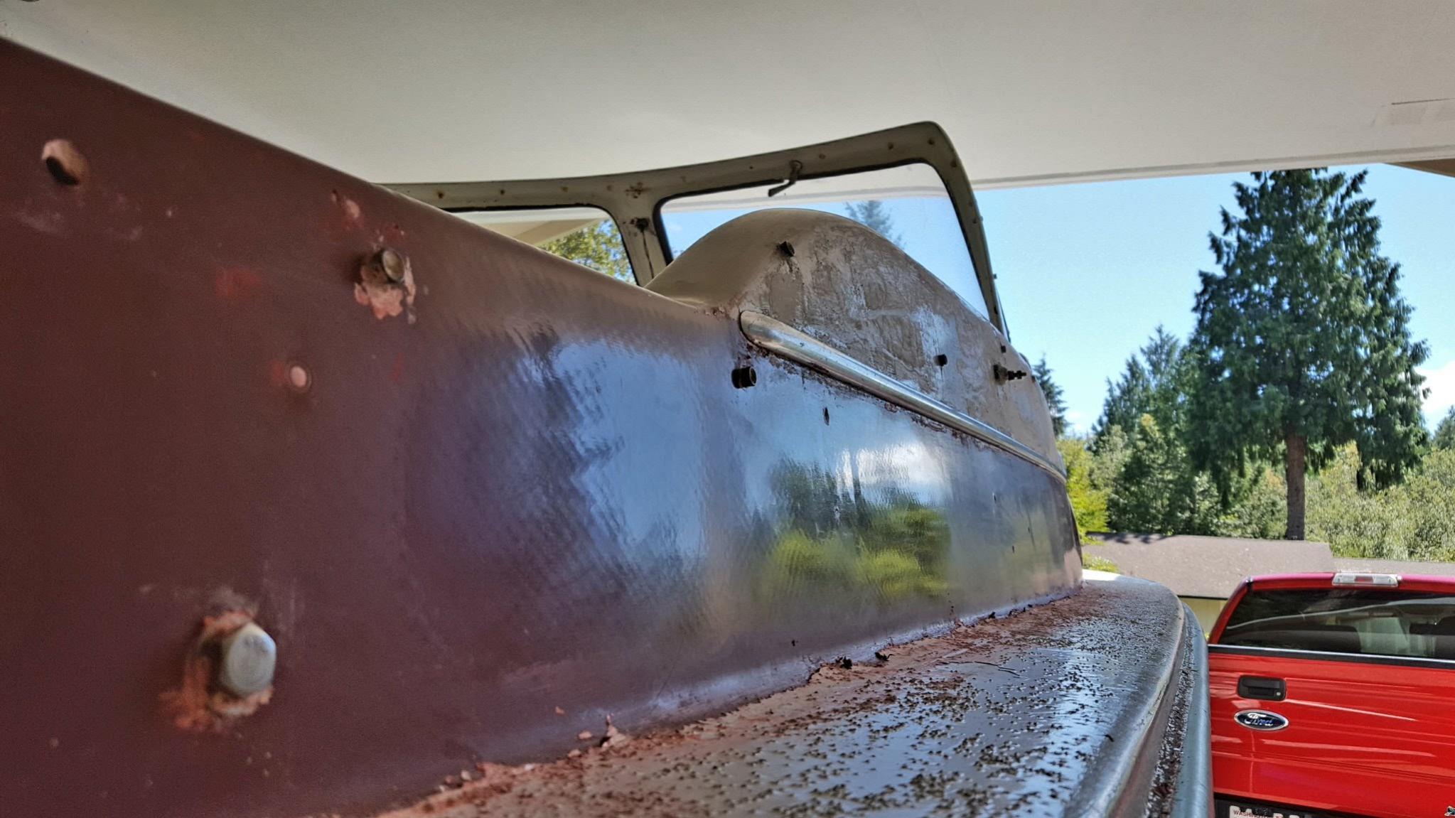

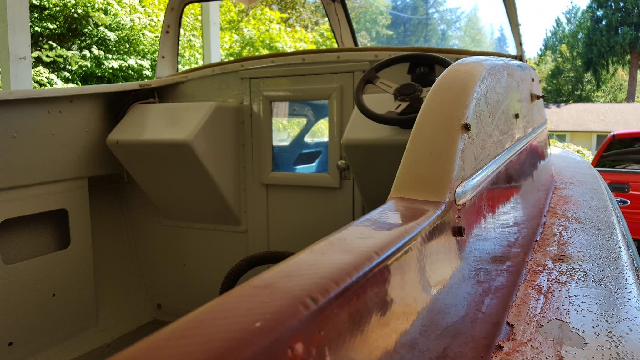

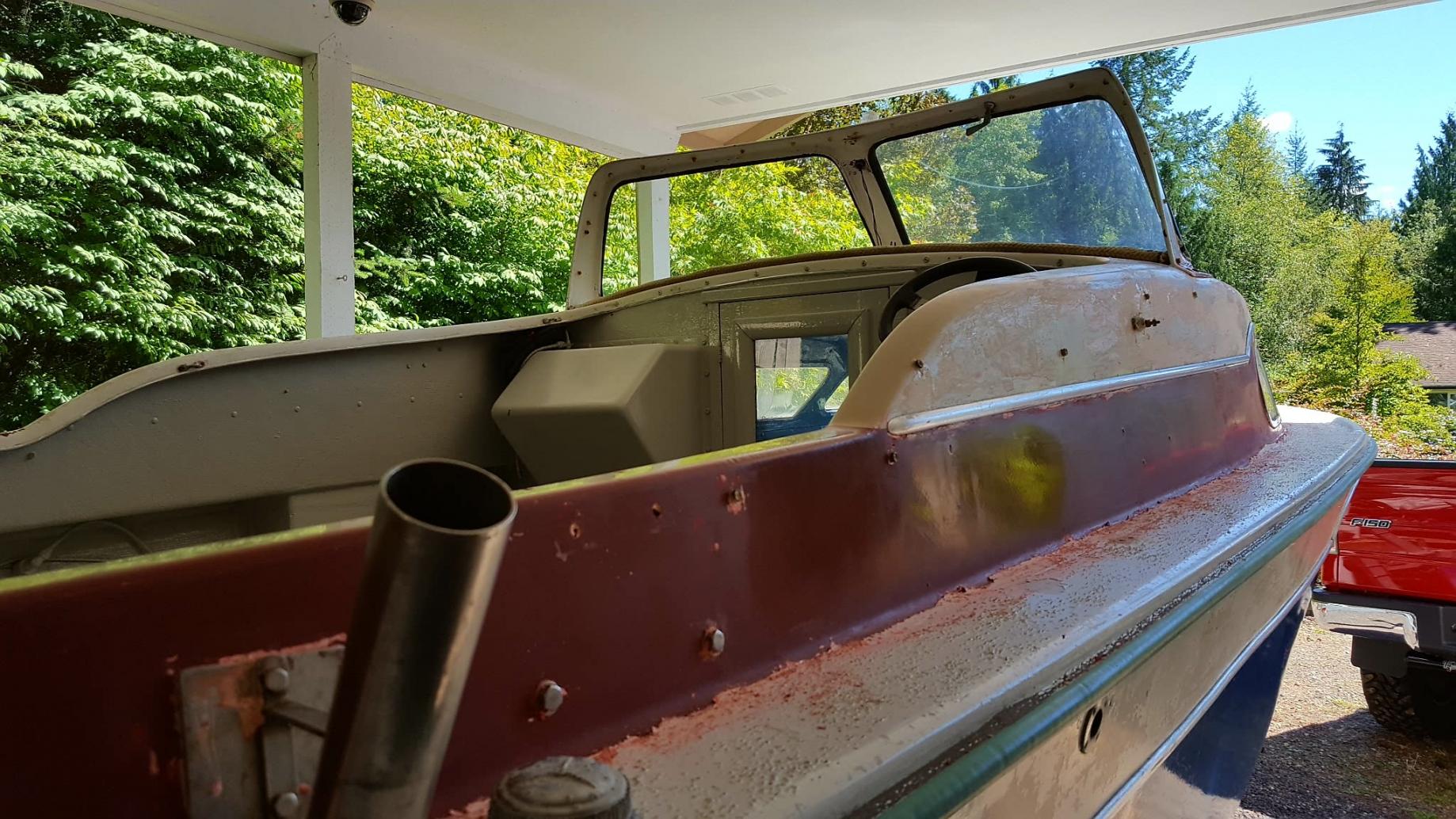

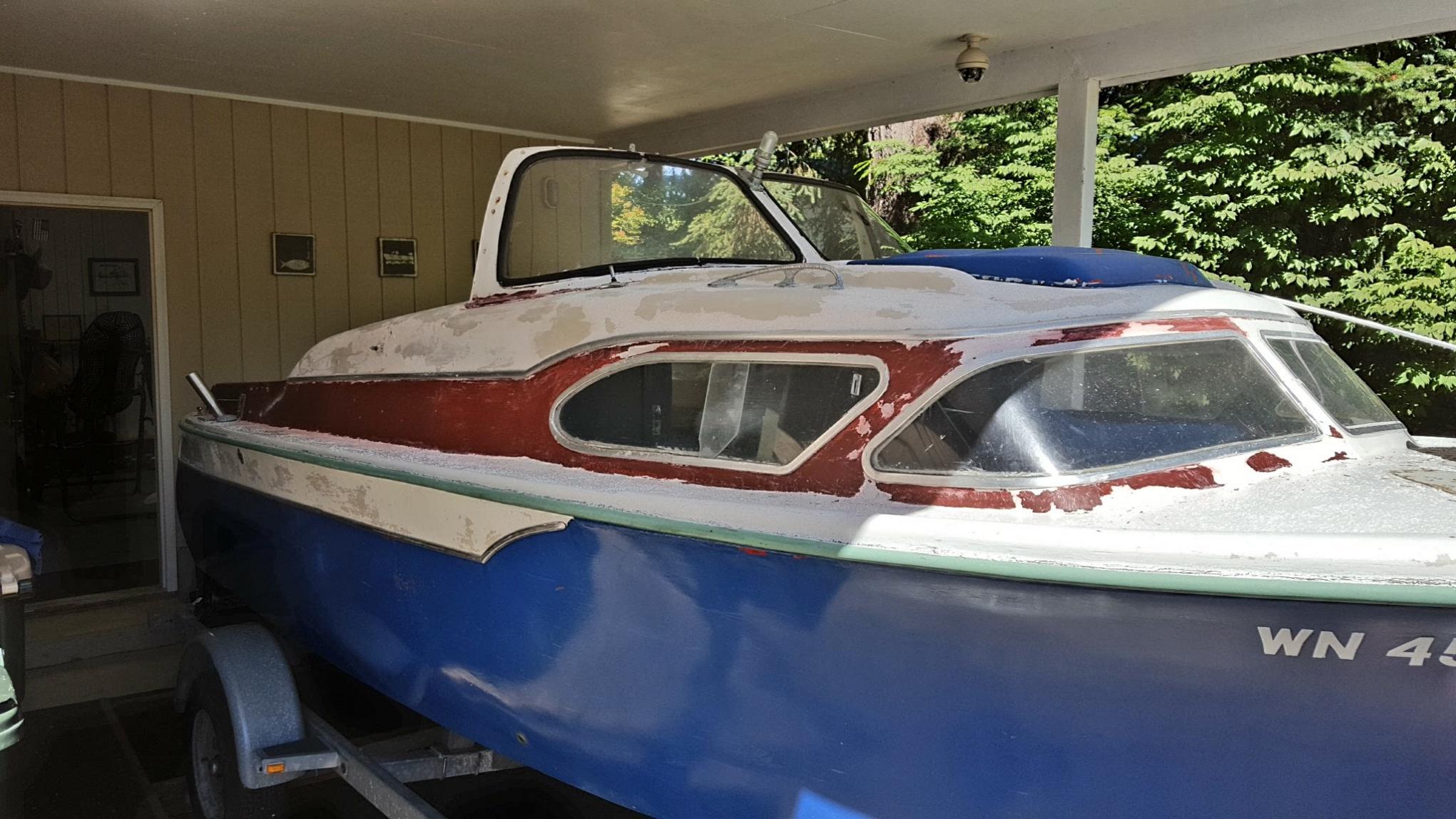

          Hmmm, so I'm liking what I'm seeing! It's definitely hard work, but the results look promising though I still have the bottom half to start on...which will be the last thing I get to. I really wanted to see how the burgundy buffed out so I did a little test spot. Can you spot it? (ha!)
          More glory shots:
          • #50
            Looks good Kelly, I'll keep an eye out for the Peelaway. Might be in storage on San Juan?
            is that a surveillance camera? Let me know if you need any help or advice?
            Cheers,
            • #51
              Thanks Tim. It is a security cam...I have cameras all around the house and I can pan around with the one above the boat. I can even do all of this from an app on my phone
