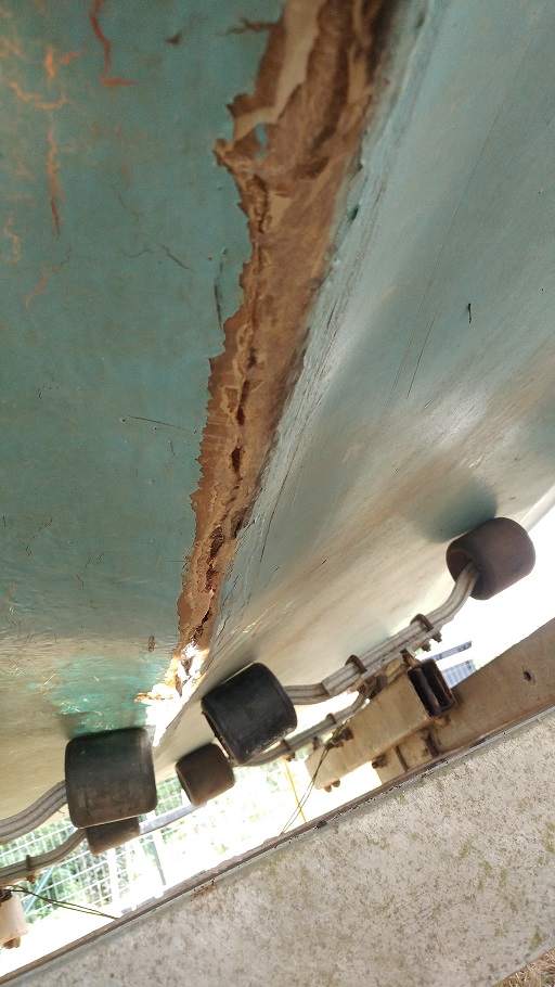

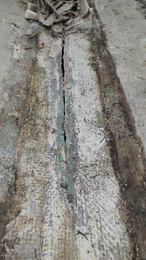

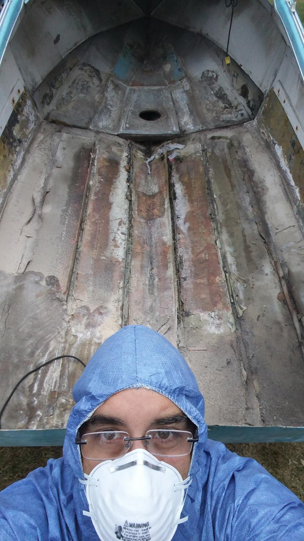

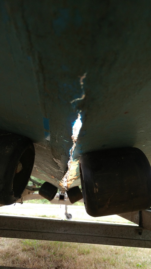

    Hello everyone.. been awhile... Finally settling in to the new house and getting back to the "Glassket case". I started to grind and clean the interior getting ready to lay in some new fabric when I saw this little split. My question to the experts... do I continue to work through this lil discovery?

    Anything in the fiberglass "materials" category is fixable. Hope the boat was free....I'd grind the inside, clean it up, and do some serious reinforcement with heavy structural cloth with epoxy resin. Then flip it over and grind the bad stuff, put some shreaded-up structural cloth and structural thickened resin into the voids. Shape it to original keel detail. Overlay with a couple of generous overlapped layers of finishing cloth with e resin. Seal with a good high build epoxy primer. As long as you don't plan to keep the boat in water for more than two weeks at a time, most marine formulated paints will work fine. Longer and a good bottom paint is advised. Good luck !
      My only additional tip would be to grind down the outside before building with new structural cloth materials as Bruce described.. That way you can sand and fair it out flush with the true hull lines and still have the thickness for structural integrity... I start on the outside (even if you have to work upside down) and get the outside faired and true. Then build up good structural strength on the inside where no one will ever see it..
      Bottom line: DEFINITELY fixable!!
        Here is some more information to add to your repair project. First of all not all epoxy products are compatible with the old fiberglass resins. check with vendors in your area. I found this out when I was getting all the material to replace the stringers and floor in my seafair. The vender stated the epoxy may or may not bond to the old fiberglass and it took four gallons of resin to replace the stringers and floor. Another factor is the cost, west systems epoxy is about 100.00 a gallon and you only want to do this job once.
        I would start on the inside by cleaning back from the damaged area about 12 inches around the area. Start by cutting strips of cloth the full length of the repair area starting with two inch wide and each strip overlapping the previous by one half inch. From two inch the next one is three inch and so on. Do this for about ten layers once this is complete you can then work on the outside. What the inside layers gives you is some material to grind into to layer your repair like the inside. I learned this process repairing fiberglass boats on the Navy from 1968 to 1972. These are my recommendations and ideas for your project determine your game plan and go for it, good luck. Dave
          Brian's sequence makes perfect sense- just after I posted, thought to change it ! Once it's been sanded/ground, somehow you have to create a barrier on the inside to keep the new materials from falling through when applied from the exterior. Using mylar as the material that faces outward from the inside will help greatly as a release surface/material. Good luck

              I see you are on Camano Island. I would look for a vendor that has some of the braided heavy roving fiberglass mat for that keel. If you go 12 inches wide and lap 4 inches over each other right over the keel, than you can be assured that any flex in the hull will never be able to open that up.
              It would also save you from many many layups with the smaller fiberglass thinner tapes.

                        I had originally planed to lay 2 layers of CSM and 2 layers of 1708 on the interior of the hull after i was done sanding and grinding. Then install the Transom and stringers. Move to the exterior hull and repair all the little owies on the exterior and fair the hull to a smooth finish. I have to rethink the keel shape... I kept the repair that popped out and I thought I could make a negative impression and fit it to the exterior of the keel just to give me a good shape to work with.
                        Looks like I will be adding a few more layers to the interior keel area.
