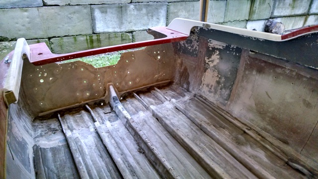

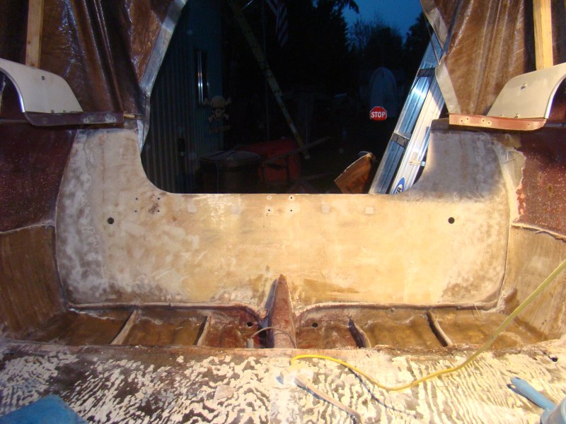

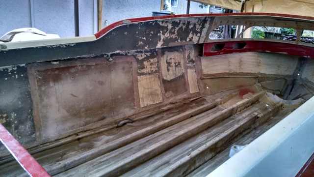

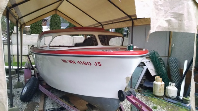

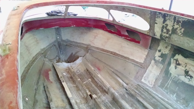

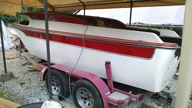

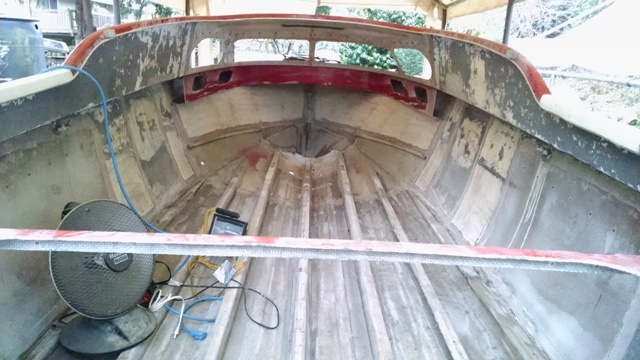

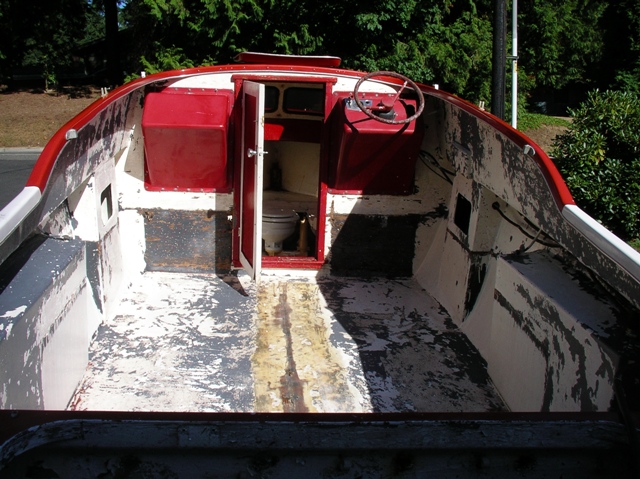

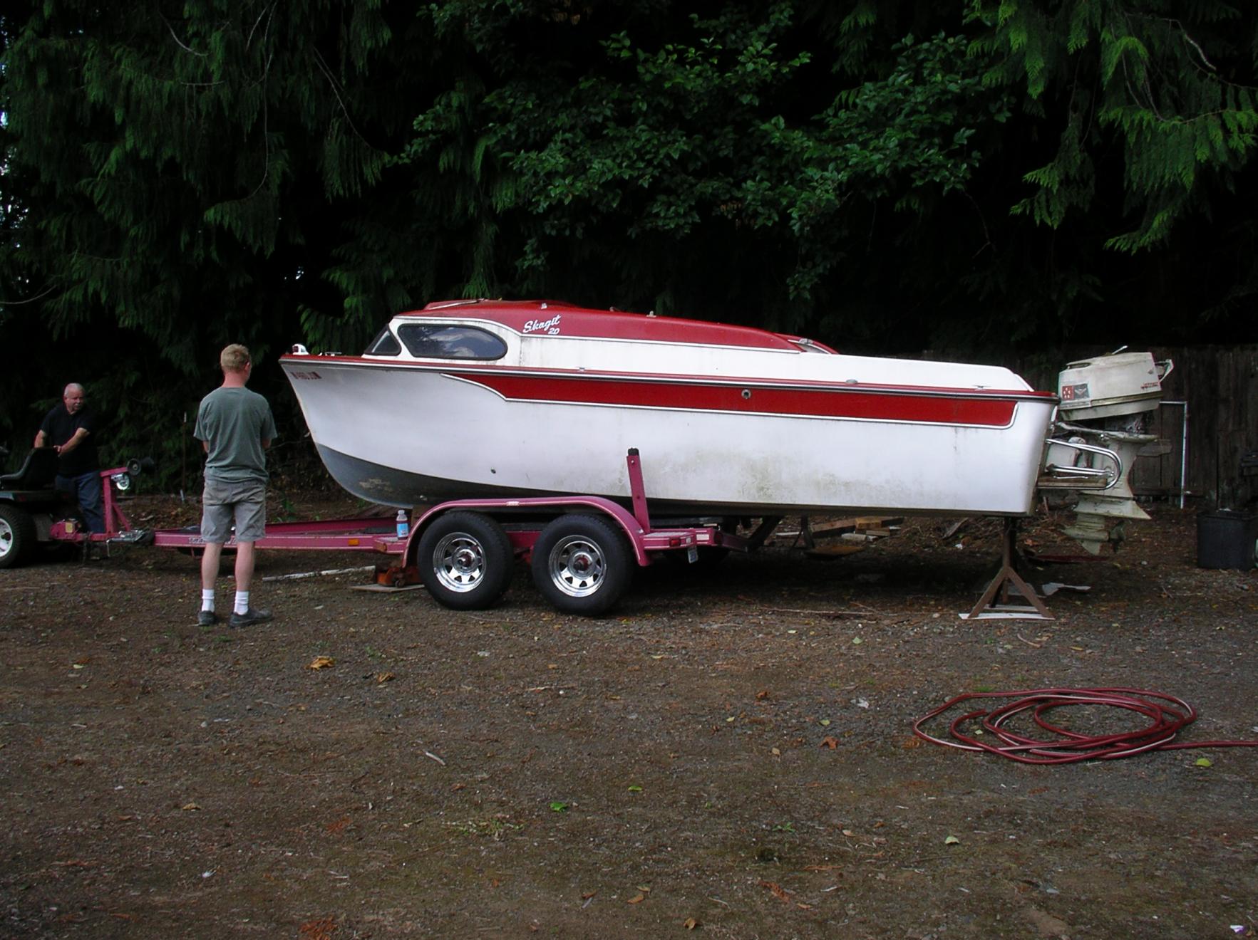

          Yes thanks, I don't want to reinvent the wheel here just do what works and use others advise. Pictures this afternoon.
            My 1958 Skagit 20 Offshore. There's a couple pictures of when I picked it up at my parents house outside of Shelton after I brought it home and took out the rotten interior, then after I removed all the wood and ground the fiberglass.

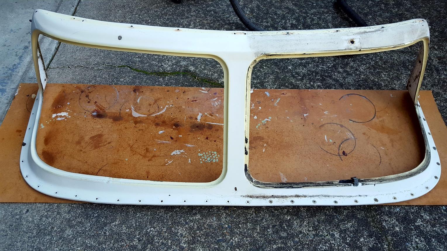

                Do you have the helm windshield frame for her ?
                If not, the late Chuck Carey took his off Skagit 20 and came up with a nice look.
                I am not finding a picture of his 20 other than one on our main website that is in the picture rotation. His is the blue one with the later Merc on the back.
                Anyone have a picture of Chucks cut down windshield ?
                  ˙Here's a shot from July 2011 in Jarrel's Cove with Chuck's 20. The windshield is a classic used by vintage wood runabout manufacturers and enthusiasts. There is a bracket at each side and a center bracket. Two pieces of flat glass are the windshield area. Nice looking. I'm going to throw a wrench in the idea, as it probably needs to be higher to provide better protection for occupants. Skagit used off the shelf Taylor plexi on some 17 models as well as the last year of production for the 20 express/offshore models. The FG frame with glass inserts were installed by the factory from 1955-late 1959 on 20' models. So if one can't come up with a factory FG frame and glass combo for that upper windshield, a proper sized plexi in aluminum frame (easy to find on eBay, just make sure of dimensions) might be an inexpensive and semi-correct looking alternative.P1110517.jpg
                    I do have what I assume is the original windshield, I believe thin aluminum bottom and curved Plexiglas, no complete surround. However the looks I like about these boats is the tall bow and short cabin height, and the original glass while sounds like they are very functional alters the look to me, I might have to compromise based on Chuck's experience though. With my slow progress it will be awhile before I will have to decide.

                        The pics look good and the gelcoat looks good from I can tell...should buff out nicely.
                        The upper windshield frame Helmar and Bruce are referring to looks like the one I've attached...
                          And I thought I had some extra holes in my transom...I just noticed yours! Wow! There must have been every accessory known to man hanging off the back of that boat at some point.
                          Sorry, I'm not being negative. You will definitely be a hole patching expert by the time you're done.
                            Wow, Kelly and Stephen, he does have a ton of holes !! My 14 sportster had 15 holes, developed a true appreciation for the proper technique (beveling the holes) and thickened eresin as a filler. Can't tell the holes were ever there, now.

                              I also just noticed the narrow transom...thinking it's an early '58, probably Mar-Jun.
                              Is there an ID plate on the inside of the transom splashwell on the port side?
