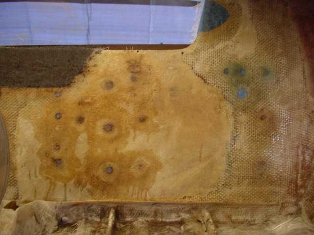

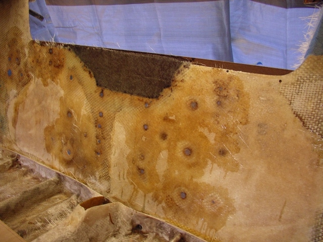

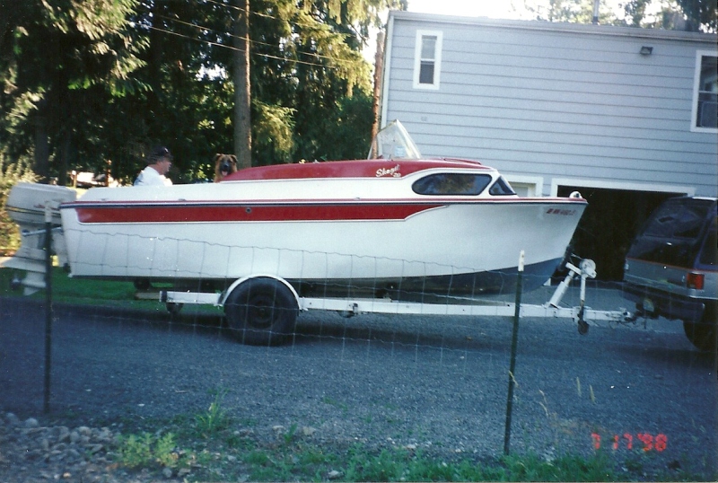

      Swiss cheese. At some point before my parents bought the boat, it had an extensive aluminum plate sandwich trying to tie the soft transom together(I will post a couple pictures of the contraption as soon as I can get my printer to scan photos again) with a outboard extension that moved the motor back 8-12" for what ever reason, that is what most of the holes are, I'm not worried about the holes they will be filled during the transom install. The pictures I have will also show the windshield which is different then the one shown above.

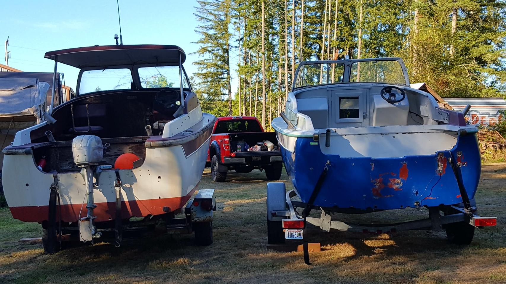

        Your transom, along with the transom on my hardtop, have a narrow splashwell compared to a later production '58 like Bruce's boat that doesn't have the inside "platforms" on either side of the transom. Look at my blue one compared to my burgundy one. See the difference?
        My theory is the narrow transom boats are early '58s and a few may be leftovers from '57...at least the top half of the boat. Again, my theory...no one has backed that with proof, especially since the tags never seem to stick with the boats.

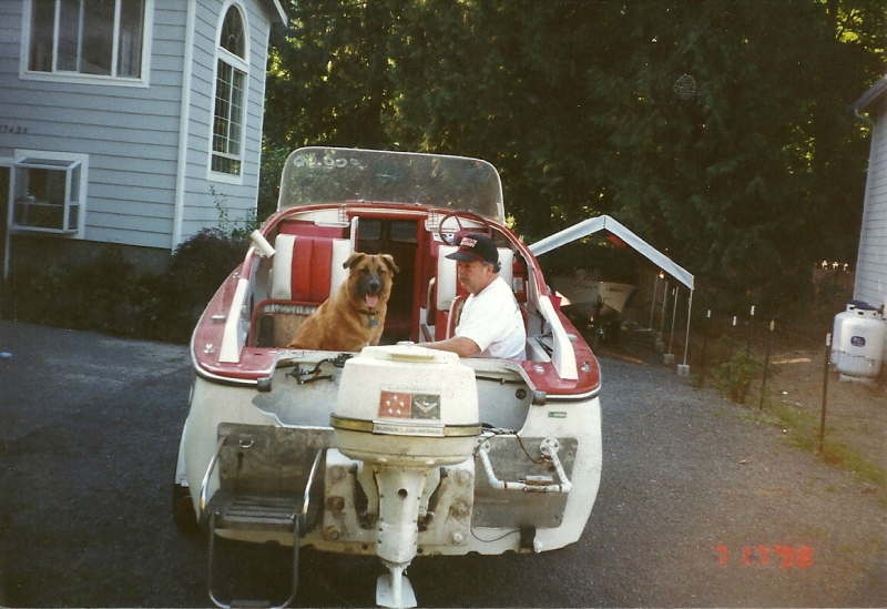

            Attached are a couple pictures after my parents brought it home from the used car lot in Marysville. The aluminum plate on the back is attached to 3 more plate sandwiching the transom and splash well with what looked to be with RTV that did not adhere to the aluminum. Then there is this fiberglass fabricated engine extension/mount that was bolted to the transom with 6 3/4"bolts. It was quite the repair, I think it would have been easier to replace the transom and splash well.
            The windshield is also visible.
            • #21
              Interesting, it has the later model windshield (61, right Bruce?) and later rub rail and the step pads along the sides were either removed at some point or never installed.

                  Pretty sure from his history of the purchase in Marysville that the boat didn't leave the factory like this. Owners previous to the father altered the boat heavily- rub rail, changing cabin windows, upper windshield (may be evidence of holes from original windshield detectable), transom cutouts, brackets, step pads, color of paint, etc. Still a bit rare to find original Skagit hull ID plate attached to boats. Plus, so many are registered with wrong year. A beauty worth restoring, for sure. Would love to look it over.

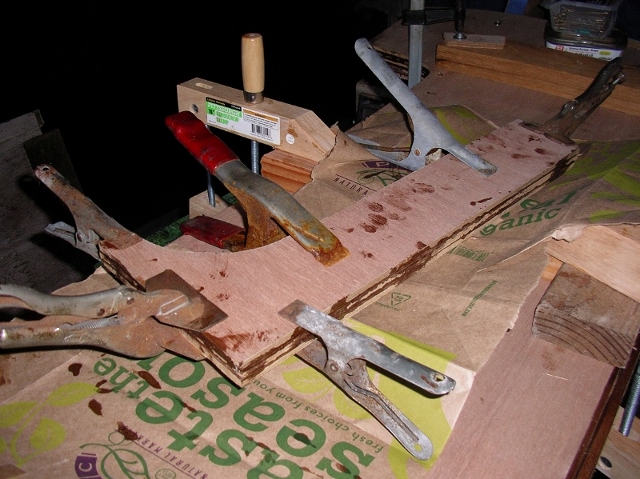

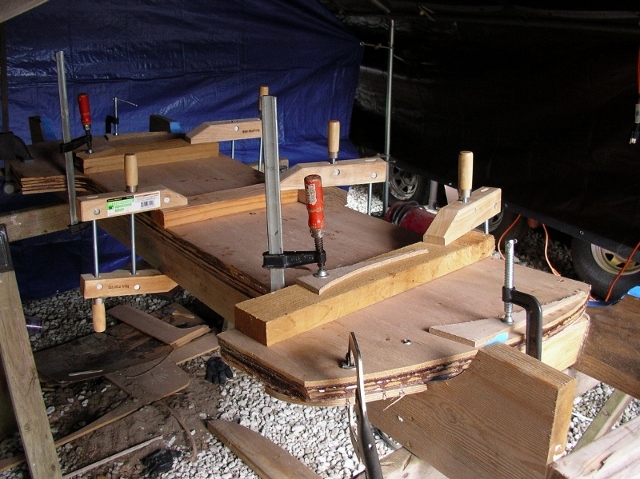

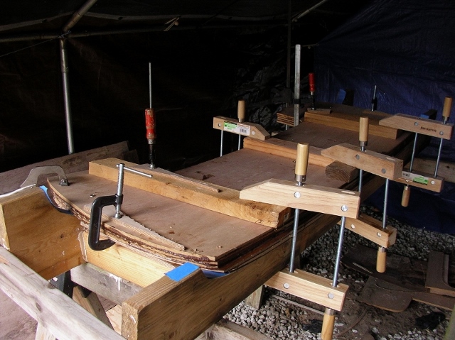

                            Since it was barely above 50 degrees today, I could finally epoxy my 5 pieces of 3/8" transom boards together and clamp them in the fixture I made to the shape of the transom before cutting the old wood apart, making the transom wood just under 2" thick. I decided to epoxy the wood together, then I will grind/sand the edges to fit in to the boat and remove the epoxy from the outside of the wood so the polyester resin will adhere. I laid up mat and p-16 polyester to fill the Swiss cheese transom I had. My plan is to add at least one layer of 1708 fiberglass then a layer of 1 1/2 oz mat to the transom shell with polyester resin and press the transom board into the wet mat after saturating the backside of the transom with thinned resin. After that is cured I can fillet the ends for a smooth radius and add a couple layers of the 1708 and mat alternating.

                              Looks as your making some Real progress now for sure. !!!!
                              Keep the picture coming.
                              • #30
                                Glad to see you're back at it. Looking good!
