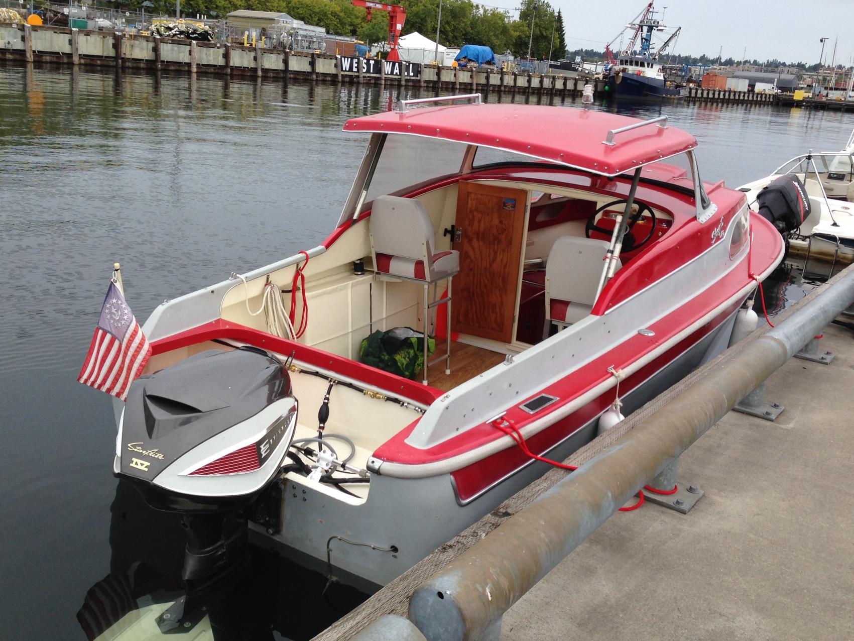

Hi Everyone, I have finished my restoration of my 2nd glass boat. I have posted some photos of my Skagit 20 that I have here in Seattle. I'd like to open up the hard top. I understand Glastron used to have a sliding roof? Would anyone have and info on how the slider worked on those boats. Possibly like a kitchen drawer etc? Or has anyone put a hatch on the roof. I don't want to overly change the look of the boat though. This boat hasn't been seen in many many years so I'd be grateful for any advice in general. Thanks, Robert in Seattle

I have a 59 with the hard top and to be honest with you, I have thought about this myself.
I only got as far as looking in some of the boat yards for something I might use.
Anyone else have any ideas ?Helmar Joe Johanesen

As far as the hardtop, my plea would be not to alter the actual hardtop. These boats are pretty rare (even if it seems like there's a lot on this site) and a hardtop to boot, even more rare. I digress. I am going to attempt to make my hardtop removable. All my wiring (lights, horn) will be quick disconnects while the shafts holding up the rear will either be attached with wingnuts or pip pins at the top and similar at the bottom. The other attachment on the window frame, I'm thinking quick lock fasteners. Also the gasket will be affixed to the hardtop itself. It all makes sense in my head. Anyway, that's my idea and contribution.
Hope it helps.

Does anyone have a spare hard top i could make a mold off of or have dimensions from, i would love to build one for mine, and for people to put hatches and stuff on.Gabe Williamson
