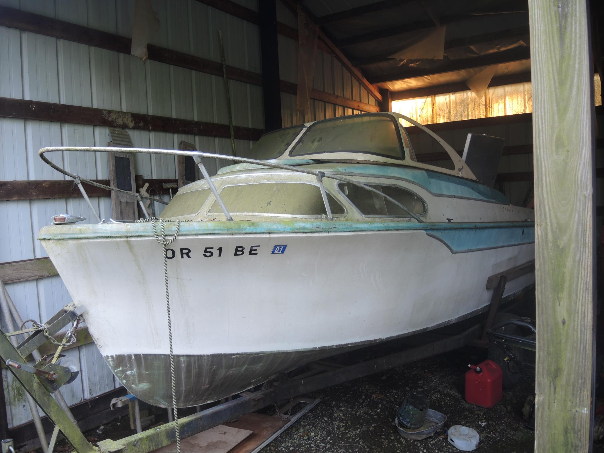

                            Scott can you post a picture of the frame you have? I wonder if it's the one off of the 17 convertible?
                            Does it look like this?
                              If it is that same windshield I'd be interested in it.
