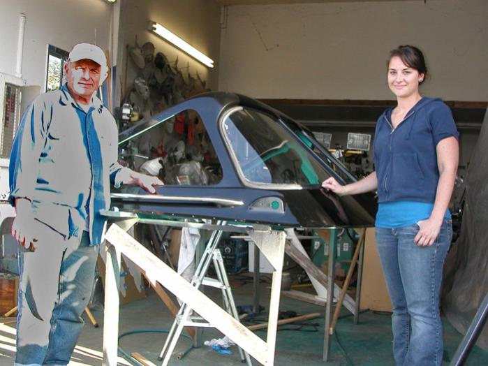

    Yesterday my daughter Zoanna and I installed the curved bridge glass on the Saratogan. The glass is from a 1957 Chrysler, 1/4" thick and probably weighs 20 pounds per side.
    Made up some thin sticks from oak to guide the glass into the rubber weather strip. Broke them all at least once. I was stressed out when I started the operation. A quart of water/detergent, three beers and seven hours later they were both in. I was exhausted. My fingernails are still black. Hoping the flat glass goes easier!
