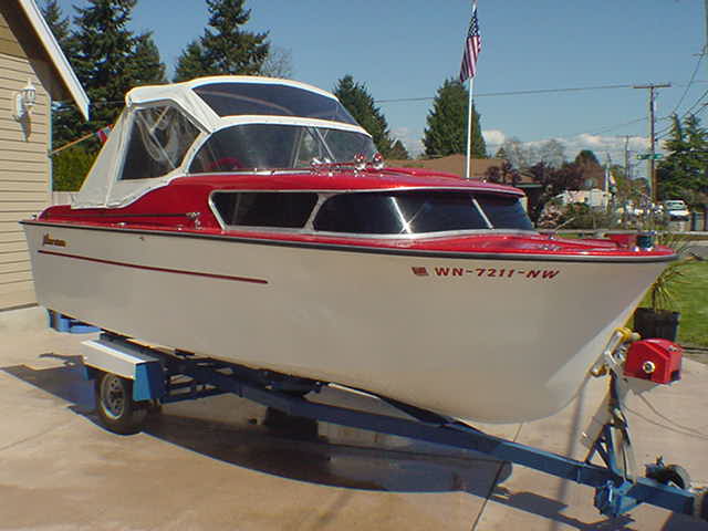

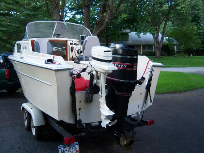

    I have been churning this idea over in my big head for a while and thought I would do well to take a poll: I am think about painting the top side of my BellBoy red - bright red. I like John Kelly's scheme with his BellBoy 404, one year older than mine (pic of his and mine shown below). The gel coat on the topside is in need of refinishing. It owes me nothing, being 49 years old and counting. It held up magnificently all those years. There are so many nick repairs and equipment removal "scars" and general fading that no amount of sanding and buffing seems to restore that I feel its time. Gel coat matching has been a joke, mainly because I have so many "shades" in the the original gelcoat that no matter what I do, I see the work after. So. Should I go off white top and bottom like the original or off white for the hull and Pettit easypoxy red for the top? The red would include the splashwell which would look great, I think.
