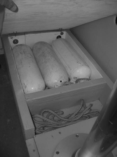

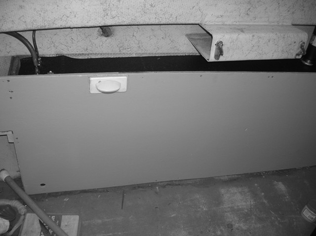

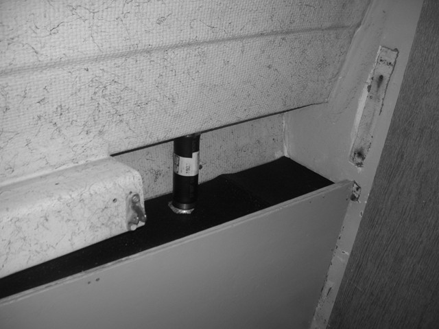

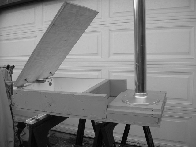

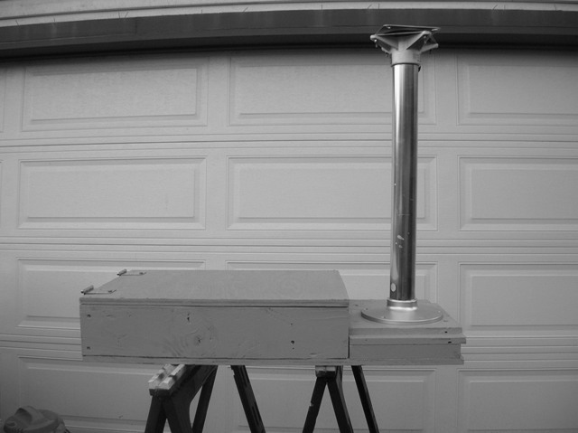

I finished the tank replacement, covered the tank tops with a black neoprene type pad (actually an excercise mat) repainted the tank panels and then decided that while I was at it I might as well build a platform/storage area for the pilot seat. After talking to Jeff I came up with a heavy duty project. It is made out of 2x6 frames, 3/4 inch exterior plywood, and lots of stainless hardware. I painted everything with primer and Interlux to keep out the water. It is solid! However, it also added about 25 lbs to the boat. The good news is I now have a better view than what I originally had. Its tough being short...
