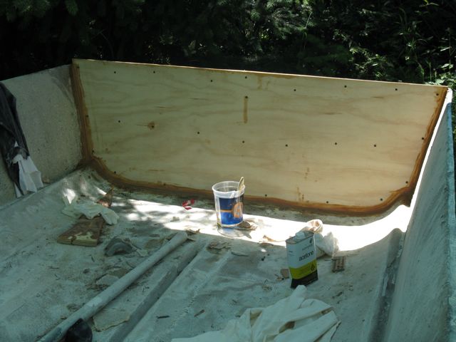

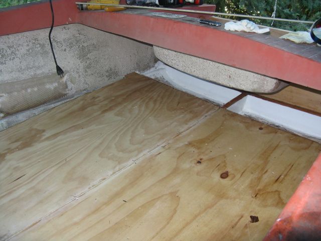

    I completely stripped this boat of anything containing wood, or what would have at one time been considered wood. I replaced the transom, and floor, which required separating the deck mold from the hull. With the new floor and transom in, I used 5200 to reattach the deck mold. After all that I put the boat in storage and tended to other things, like getting married, and preparing for a baby on the way. But now, I'm ready to begin again. I think I'll do as much as I can right there in my storage unit...seats, windshield, deck hardware, etc.
    Here are some rough photos of the project.

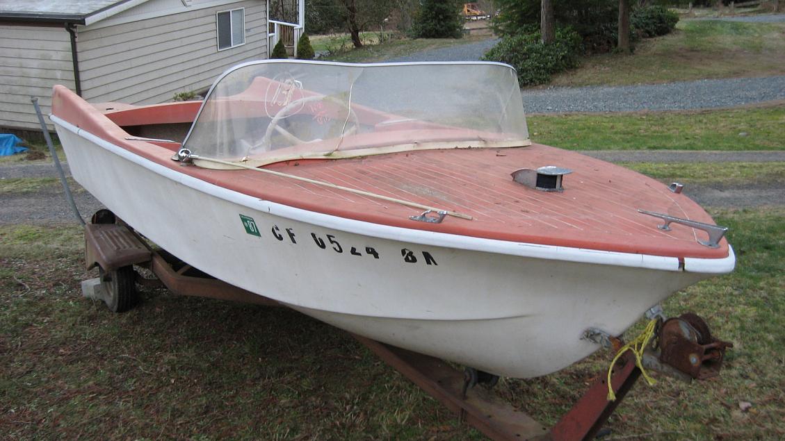

      Here's a photo of the Elgin, taken before you started work on the boat.
