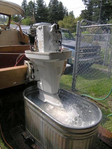

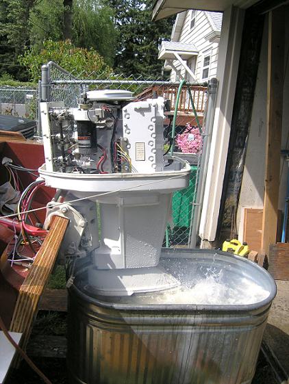

    Been a long slog this winter but that 70 horse Chrysler is running, belching fire and water. New pistons, bearings and cylinders bored and honed 0.020 over. Dang that was one nice sound when I finally got it idling. Still need to track down the right plugs and a tach and do the the final tuning next weekend.

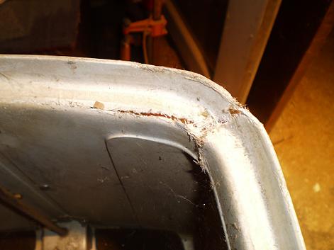

        I'll be able to get some pics of the hood up in a couple days. It's not in pieces, but got some cracks. I was told, glass over the inside and bondo the outside, but some of it goes around corners.

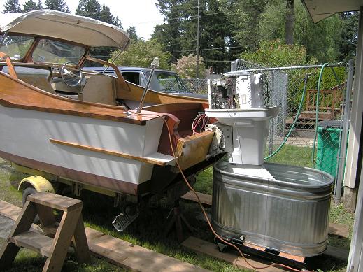

        The transom was laminated from some plywood laying around. Easy to replace though, three bolts and a handfull of wood screws.

          I have gone as far as drilling some small holes and adding supporting over wax paper then glassing from the rear. Then filling the holes with something like Evercoat lite. Like I said, some pictures will sure help setting you in the right directions.

            I would keep the Bondo to a minimum on the hood, I think a better way to go would be epoxy resin filler, with fiberglass strands for larger areas, with micro ballons and silica powder for smaller areas and finer feathering. I used these when restoring my Homelite hood and was quite pleased with the way they worked. Haven't had any cracking or other bad stuff happen since putting it into service, either.
            One corner of my hood was shattered and basically had to be sculpted to match the other side after laminating the inside with cloth and resin. I used resin and micro balloons and it worked beautifully.
            Lots of guys here know a lot more about fiberglass than I do, be sure to post clear photos of what you're working with on the hood and you'll get lots of good advice.

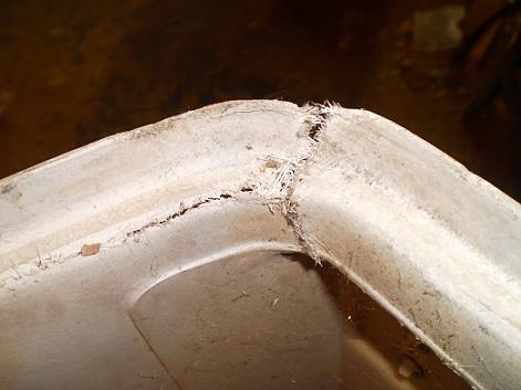

              De-grease .de-grease ,de-grease......the cover.
              Then use Blu tape on outside and work from the inside with some epoxy and top with a skin of cloth over each crack.Use ground up glass as thickener use ( a file or rasp to make)scratch or sand to give the surface something to bite on.
              Bigger cracks need two layers and be at least a half inch beyond the crack,or it will come back.
              A little epoxy to seal the outside cracks will keep it together for many years.A razor blade or file can scrape it pretty smooth,even better than sanding in some ways.

                Ok, I got some good de-greaser, that's what I cleaned up the engine parts with before primer/paint. Now bear with me here as I'm a newbie on glassing. I'll try an' get some pics up tonight.
                Filler: Brand name? Does it go directly on a clean scuffed surface or does it need some kind of stick-um? Wont have to fill deeper than 1/16" or bridge a gap more than 1/8".
                Epoxy: Can I buy one kind of epoxy and add filler(s) as needed? Brand names will help.
                Would you try to put the cloth on both (inside/outside) sides of a 1/8" gap or will cloth on the inside be tough enough?

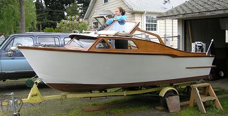

                Slo-Mo, Here's what the rest of the wooden motor stand looks like. The 'inside cabin' is waiting it's turn for finishing. The hull isn't quite glassy smooth. It's lightly sanded and painted to seal and protect. Wondering if I could use some of those epoxy fillers to fill and sand smooth?
                  This is the corner that needs fixing. If I can do this part, the other crack will be easy. I figure I'll start by taking all the trim off, then de-grease, then,...

                    What a great boat...(!) We don't see many of the earlier Clipper Crafts, so your's is fairly rare.
                    Regarding the cowl, you'll be happy with the results if you follow the advice already given. Looks like an easy fix.
