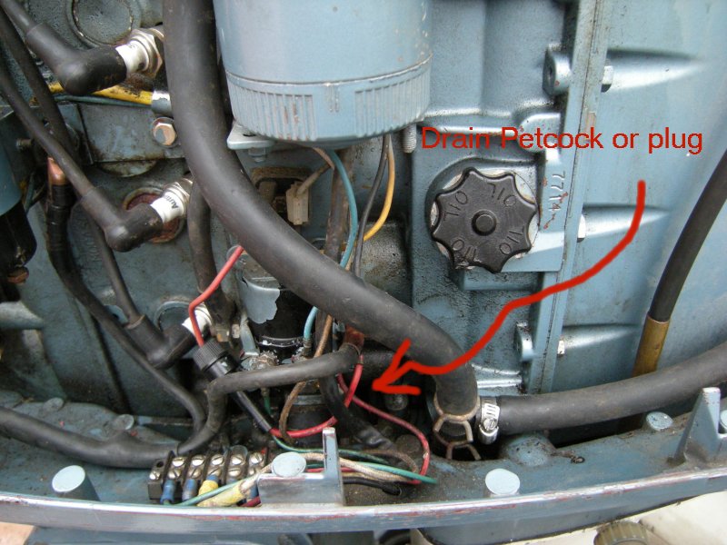

            In fact, can you pull the cover and get me a picture of the left side of the engine. Also look for the Petcock that is a water drain...
            Let me see if I have a picture of it. To winterize these old girls, you can fog the cylinders and drain the water out of the block. Another common problem with this is they will retain water up in the block and freeze in the winter.

            [ATTACH]14870[/ATTACH]

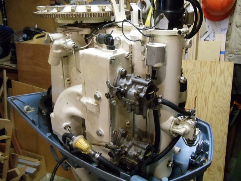

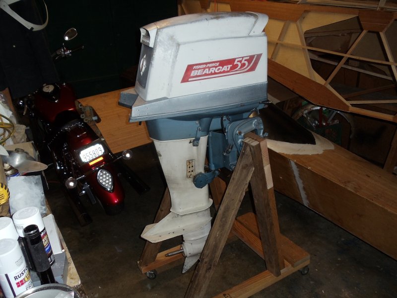

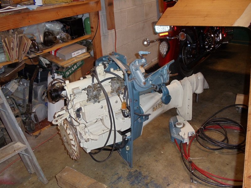

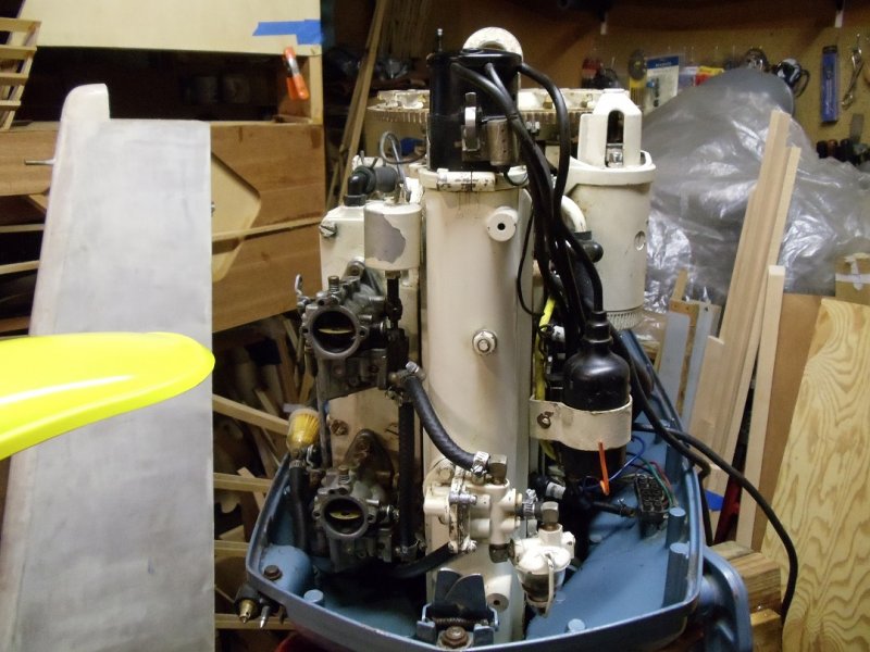

                Here are a few more photos of the motor.
                  one more photo

                              I just took a look at the oil (Large black knob on block) no visible oil? I have a clear nylon knob on the leg that says oil indicator but it doesn't want to turn easily so I wont force it just yet. I also do not know where the drain plug is? I didn't find a drain plug per your arrow on your photo?
