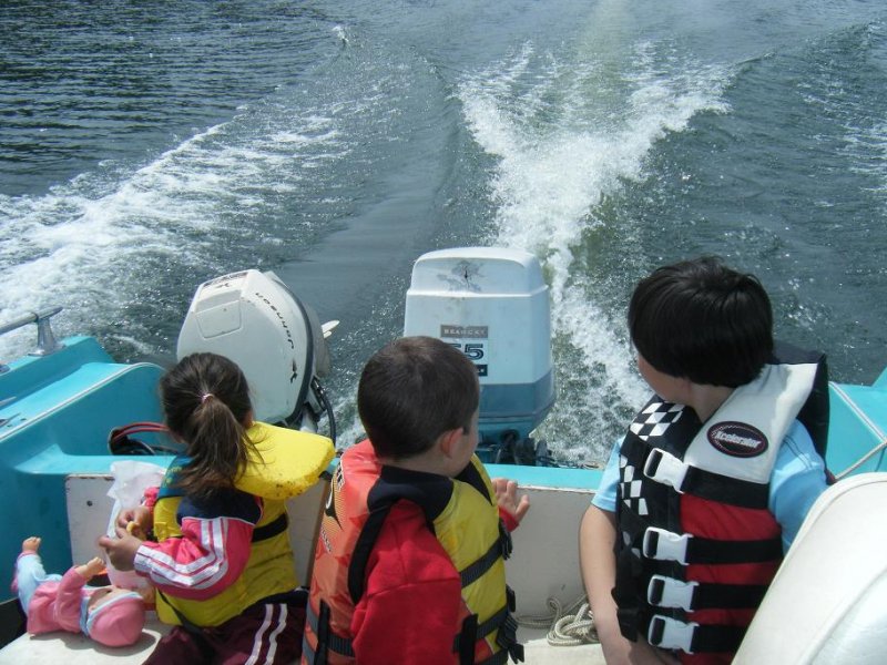

              I run one on my 19' Uni, but my boat is quite a bit heavier than Kelly or Helmars 17'. My boat with motor and accessories is right close to 2000lbs. I can get about 18-20mph with two people, a cooler, and my trolling motor. Even with all the kids we can still run about 17mph cruise at 3/4 throttle. I love my Bearcat.
